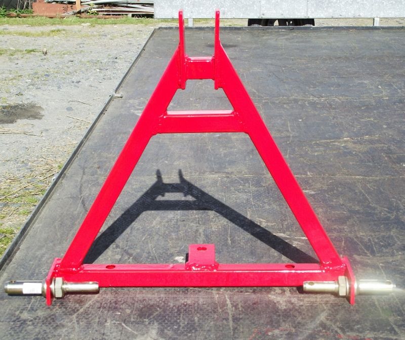

Most of my tractor implements weigh 600-900lbs. I cannot move these around (on dirt) by hand or even shove them to get into place, even if it's half an inch away. On two previous tractors with extendible draft links I found it took 10-20 minutes to change implements, between very careful backing up and a lot of fiddling and shoving with the draft link ends, and I was storing everything on pallets as level as possible and as accessible as possible. And without extendible draft links it would have been all but impossible.
The only good workaround I found was to store my flail mower on moving dollies inside a barn with a level concrete floor. That way, despite the 700lb weight, I could move the mower right into position and hook up very quickly. But dollies cost money and it's not practical to store really large implements like rotary cutters in this way, nor did I have a large enough barn to have all my implements inside, on that level concrete floor.
There are at least two different quick hitch systems available (ASAE and ISO) and both of them look very effective, with their own individual merits. I think it would be a plus if all tractors simply came with one. Failing that, I think a quick hitch is $100-300 well spent.

Well, older implements that don't fit because sizes are not standardized is part of the problem. So, I converted them, though it was just luck that the could be converted at all.
Then there is the problem with newer implements (~4 yrs old). In my case a simple rotary mower that won't work as well. It wouldn't work with the original toplink because that was a floppy thing that would allow the tail of the mower to rise when going over a bump. Removing that and using a fixed pin is simple enough, but the lower hooks are blocked from engagement by reinforcing gussets that are part of the mower's structural support. I could get a cutting torch and cut the gussets. but that would weaken the whole operation. And then I have to come up with someway of allowing the top-link play so I don't bridge the mower when coming down off a rise. Doable, but a PITA. And that doesn't solve the gusset problem.
And then there is the issue that for all implements, the top link has to be adjusted right or it will over- or undershoot the top link hook up when the side-link hooks are aligned, so I have to get off the tractor most of the time anyway. No big deal really but it somewhat defeats the purpose of the QH. Nothing a couple hundred or more wouldn't fix with the installation of rear remotes (more than the two already in use) and a hydro top link.
What would have been better, in hindsight, would be quick-links or whatever they are called that allows one to slide each side link ball out to engage and then snap into place when the tractor is backed up after connection. I may go this route yet.
