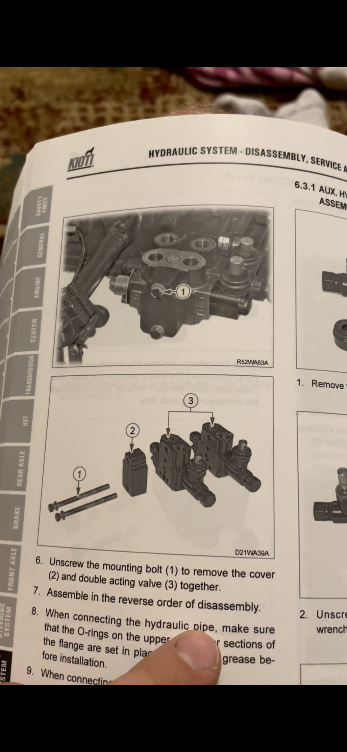

Yes I have the manual. I bought it from the dealer the day I bought the tractor. It covers the DK10SE series. I’d think it’d be almost identical to the DK20SE as all that really changed was loader joystick, led headlights

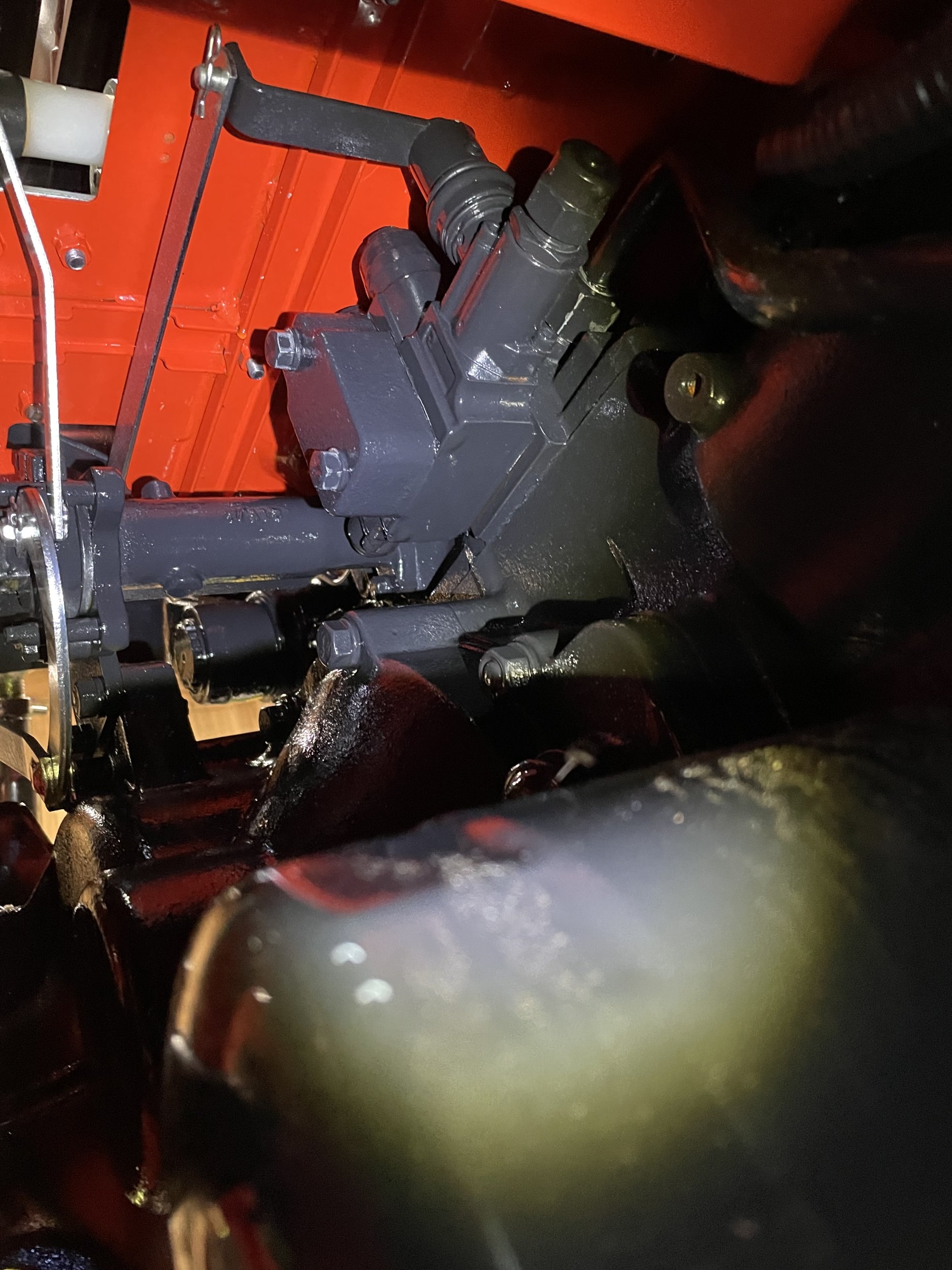

My noise got a little louder and I Just discovered a hydraulic leak on the right side, behind the rear tire where linkage enters the transmission. All this at 6hrs on the meter And very light duty work.
I scheduled a warranty service appointment, but it’s two weeks out. Depending on the diagnosis, I may just request that Kioti replace this tractor with a new one. This one is a Lemon... and I’m willing to go through arbitration.
I really wanted to like this tractor, but I’m now very skeptical about its durability. I should have just paid the extra 10k for the JD. I’m wondering if Kioti is buying Chinese parts now…

If it’s helpful check “bolt1” in the diagram and photo. This is a cap that goes on rear remote valve, where you’d stack a second valve. I had a leak on mine and dealer found one of the bolts was loose. There’s like 4 orings behind it so be careful if you take off. Won’t cure frustration but will keep you going if this is it.
