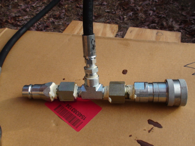

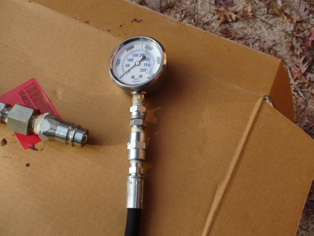

I am reporting back with my findings. It took me awhile to figure out the four different hydraulic couplings types- 1/2" ISO 5675 (Ag- rear remotes), 1/2" ISO 16028 (skid steer flat face at the grapple), 3/8 ISO 7241-1 series A (joystick-FEL disconnects) and ISO 7241-1 series B (WR Long 3rd function FEL disconnects).
The Kioti shop manual specifies 2702 PSI at the rear remotes at maximum throttle (2850 RPM on mine). Test data:
1000 RPM- 2300 PSI
1500 RPM- 2300 PSI
2000 RPM- 2400 PSI
2500 RPM- 2500 PSI
2850 RPM- 2600 PSI
For some reason I was thinking I would be getting maximum hydraulic pressure at 2000 RPM, which is not true per my data. The 5000 PSI gauge accuracy is 2.5% at full reading. So I assume the gauge is accurate at my test PSI and my relief is set a little low. Now I need to figure out how to increase the relief pressure. Does anyone have any first hand experience with Kioti DK tractor hydraulics?
I also measured all four outputs at the joystick-FEL couplings and they had similar pressure reading between the tested 1000 RPM - 2000 RPM. I did not test them at any higher RPM.

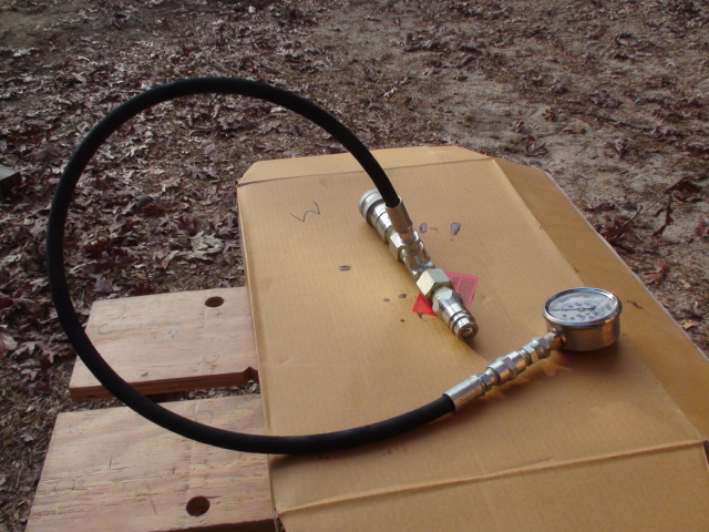

The 3' long, 1/4", 5800 PSI hose extension for the gauge is a valuable addition, as it allows me to test any coupling location and still view the gauge from the tractor seat. I also have a 18" long, 3/8", 5000 PSI hose to use as an extension, should that be necessary, along with the couplings and fittings that may be needed.

What did that testing rig cost you altogether?
I have a lot more in it than necessary as I jumped the gun and ordered the wrong fittings the first time around and would purchase a few other things differently. Plus I had to pay relatively expensive shipping multiple times. It could also be built less expensively if only used as a dead head device. But I wanted to build one that could be used as dead head or operational pass through, to cover all bases. And also the reason I ordered couplings for all types on my tractor.
The only design change I would make is to use a gauge with a back mount fitting instead of the bottom mount. This would allow use of a 90 degree swivel that seems to swivel independently in place when installed. I am currently using a straight swivel from Northern Tool who's position can only be adjusted by loosening the fitting- moving the swivel and then re-tightening.
Pricing listed below is what I could build another one for with my new found experience level. Most of the items came from Discount Hydraulic hose, except the hoses which were from Amazon.
Basic pricing now I have built one and know what fittings to use:
36" Abbott 1/4" 5800 PSI hose: $17.10 (4000 PSI versions are less expensive at many places)
Bottom mount 5000 PSI gauge: liquid filled: $17.31
3/8" T fitting: $7.90
Each pair of ISO hydraulic couplings: ~$17 - $20 (ISO 16028 coupling pairs are more like $75)
Swivel fitting: $13.30
Misc. fittings, adapters, etc: $35 - $50
Shipping: $15.00+

Nice Rig, where did you buy it?
Made it. Posted price info on a different post. When I put this together, I decided to use Permatex hydraulic pipe dope instead of the yellow Teflon-type tape I usually use, as quite a few knowledgeable folks in TBN hydraulics recommend dope/liquid vs. tape, although it was not this particular brand. I have never had any problems using Teflon tape. I had nothing but trouble with this pipe dope and small leaks- nothing that would effect pressure readings though, and now have to take it all apart and reinstall with tape. Grrrr....

Thanks. That is very helpful.
