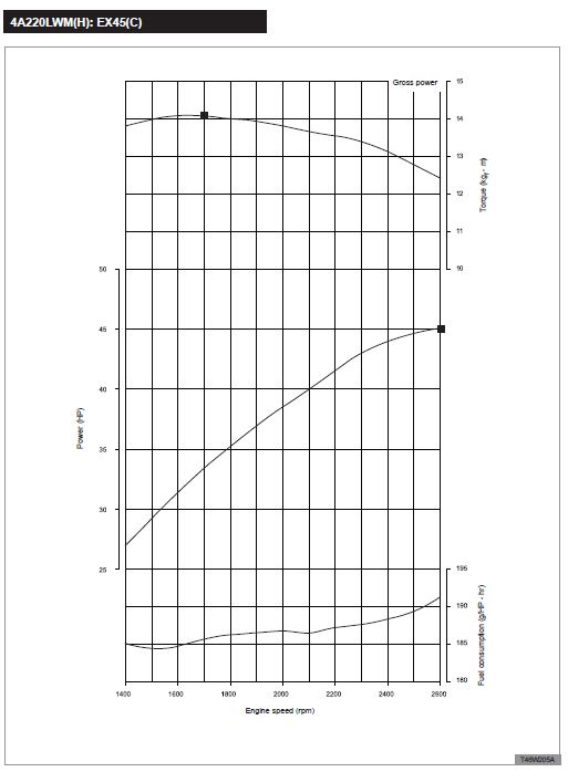

sdef, I have worked my FEL on my DK40HST...hard. Yes I have stalled out the tractor by going in too fast into gravel or dirt and no letting up when I took too big of a bite and I think that is normal. When mine max's out on lift there is almost no whine...it just stops lifting, but there is a subtle tone change in the hydro . Anytime I am lifting heavy things, I run it at max rpm...2500, right on that little red line. 2,000 rpm is too low for these HST tractors to get full lift potential out of them. From what I have read here, I don't think you have a problem, you are just trying to work outside of it's design parameters. HST's require more finesse then a gear tractor & it takes a while to get the hang of it.
/ DK45 FEL capacity issues? #50
1800 is a bit low for that tractor if you are doing real work. Consider 2000 as a minimum when you are trying to get things done. The HST in med will eat up your power quickly if you are in mud or whatnot.
For those coming from gear or shuttle they are used to operating at low rpms. At 1800 my tractor feels like a dog still chained to his house, 2K is not much better. Running at the max rpm for a hst is completely proper, and won't hurt a thing....try it:)
