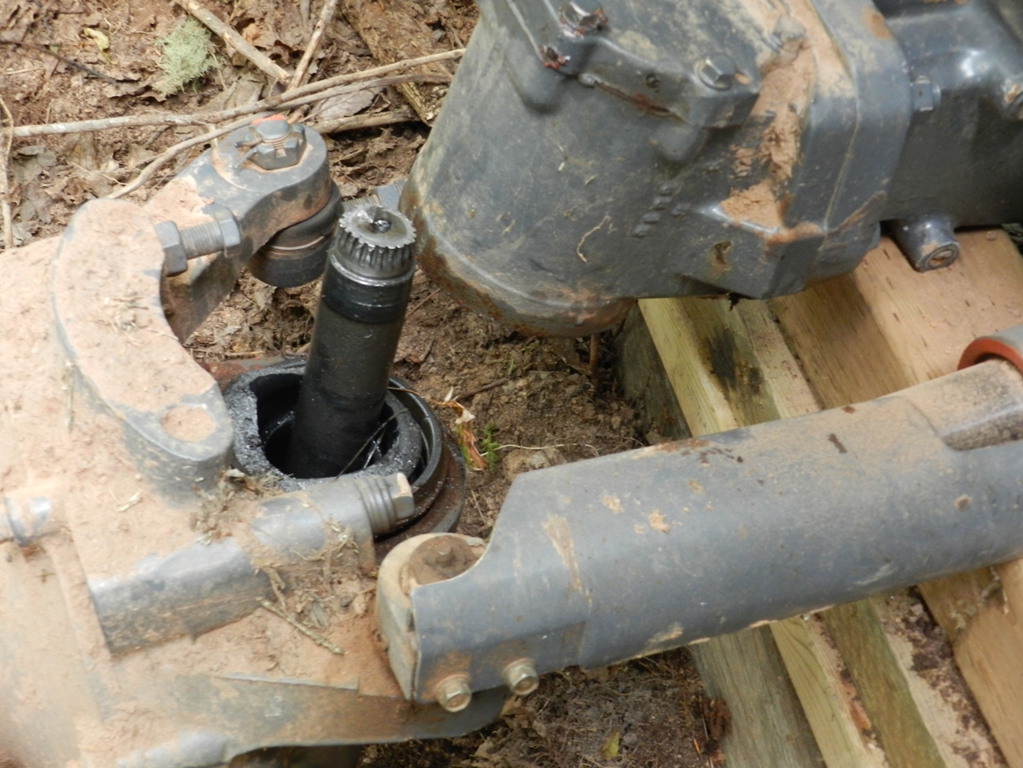

Here is what it looked like after we took the wheel off. You can see the sheared off end of the bevel gear shaft with a bit of spline still intact. Also, the gear case itself just broke in half.
My DK45SC is a 2006 and has nearly 960 hrs now. Obviously I managed to do something a little too rough with it in the woods; my mechanic says this failure may have been the culmination of many lesser insults over time and also thought the casing likely broke which then essentially forced the shaft to shear off. Sorry that I didn't take pics of the dismantling process itself. Accessing some of the nuts on the back side of the bevel gear case was challenging, as was applying enough torque once we finally got a thin enough box wrench to go onto the nut (not much clearance between the nut and the axle casing).

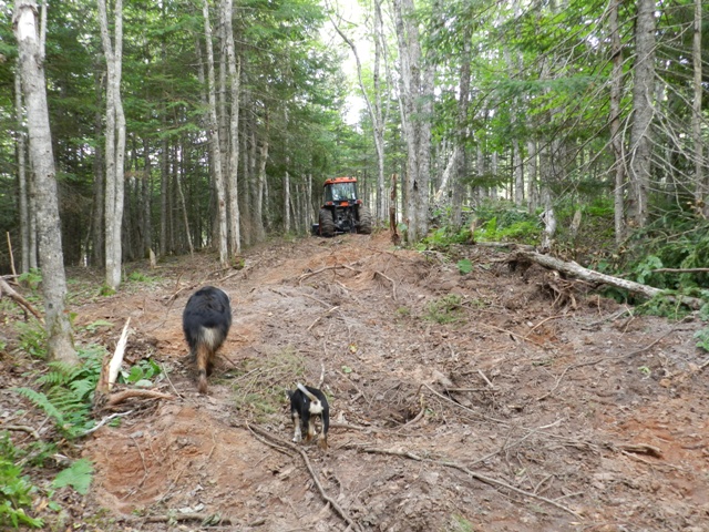

Here is a picture of the trail I was working on:

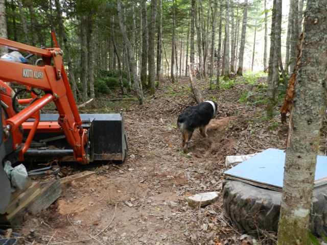

And in this picture, you can see the tree that defeated me (a maple; the bole is now standing/leaning off to the left and the remaining stump [I sawed off the leaner in revenge!] is just behind the dog):
I have only about 20 meters to go to reach a road on a neighboring property...but you can bet I'll be working more gingerly, and with my fingers crossed,... for the first little while, anyway. I hope to have it all put back together in a week or two, depending on how long it takes to get the parts in.
