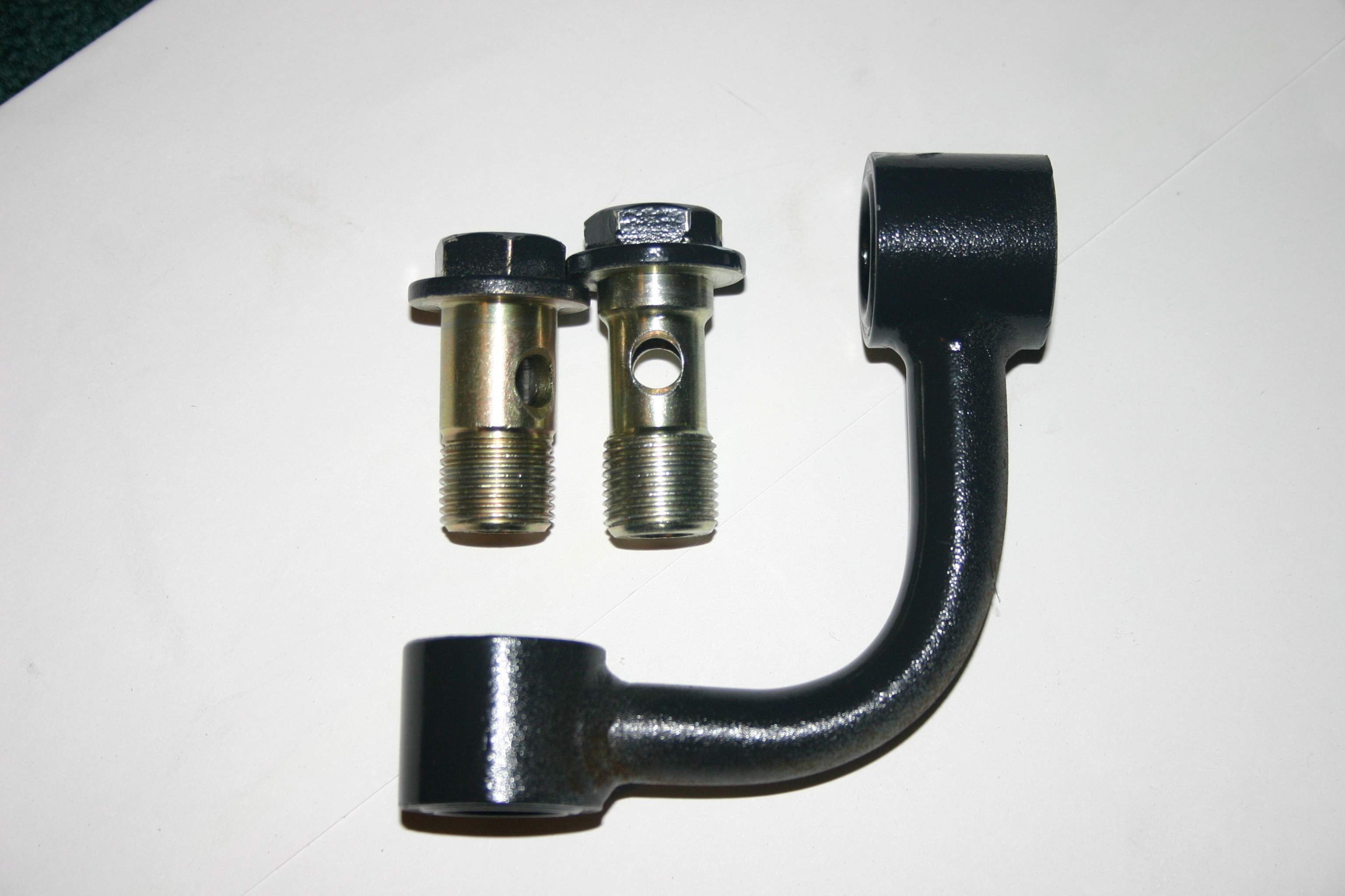

Coyote, keep in mind that the real problem may actually be the external lines. It may be the actual cause not just the symptom. Waiting for the "real" answer may not be realistic as there is no particular reason to doubt the idea that the lines themselves are the cause. If Kioti would just commit to a service bulletin it would establish that as the current understanding and also provide the underpinning for an extended warranty if they turn out to be wrong.
Island,
I hear you on that it MAY/MIGHT be the actual cause of the noise, BUT as you stated, until Kioti speaks officially, through a service bulletin, for instance, I'm not inclined to take what Kattywumpas described as the East Coat's Zone Rep's "Temporary Fix" ( rubber hose and fitting replacing steel line) solution to the problem as being the final answer- if for no other reason than if it isn't, and we run out of warranty, and THEN Kioti comes up with a real fix all of us who run out the warranty are screwed. IF the rubber hose routine ends up being the "official fix" I will accept that and expect Kioti to have my dealer install it at Kioti's expense.

NEWS from KIOTI: I spoke with Kioti in SC.
They have been working in conjunction with Daedong to find resolution to the 'squeal in reverse' issues and here is the latest.
They have come up with an updated line for the left side of the tractor hydraulics lines from the filter to the HST. This is NOT to be confused with the initial 'fix' pieces which were installed on some tractors as a diagnostic means of determining exactly where the problem originated from. It is being referred to as and 'attenuator' and it treats and solves the noise problem on the symptom level- not the cause level, BUT, as the Kioti official explained to me- Daedong and the HST manufacturer are going beyond that for new production HST's by changing the relief valve in the HST to a different/newer part - details of which are NOT currently available, at least not to me.
Side note: to those who wanted to blow off this problem as nonexistant, maybe next time you might consider sitting back and observing instead of creating un-necessary 'noise' on the channel where the rest of us are seeking out a real solution to a real problem.
Here is what I suggest for those who are currently having issues with the noise: VERIFY that it exists on your specific tractor. Speak with your selling dealer and ASK them to create a case for your tractor and ask them nicely to please contact Kioti NA headquarters and ask for the HST attenuator update to be installed on your tractor while it is under warranty.
Understand too that I do NOT speak for or on behalf of Kioti in this matter.
I will say, from a personal perspective that I am impressed that a solution to the problem has been researched by Kioti both here in the states and in S. Korea.
One further note- I would say that it would be UNreasonable for anyone with a squealing in reverse DK series tractor to expect, (especially since Kioti is searching for/finding a possible solution to the cause at the HST manufacturer level), that anyone would expect or ask for a replacement transmission. I was told that in addition to the newest research and problem solving efforts there is, according to the person I spoke to,: NO damage occurring to the HST unit as a result of the symptomatic noise emanating from the HST units.
Hope this information eases some of your concerns about the issue and it's resolution.:thumbsup::):)
