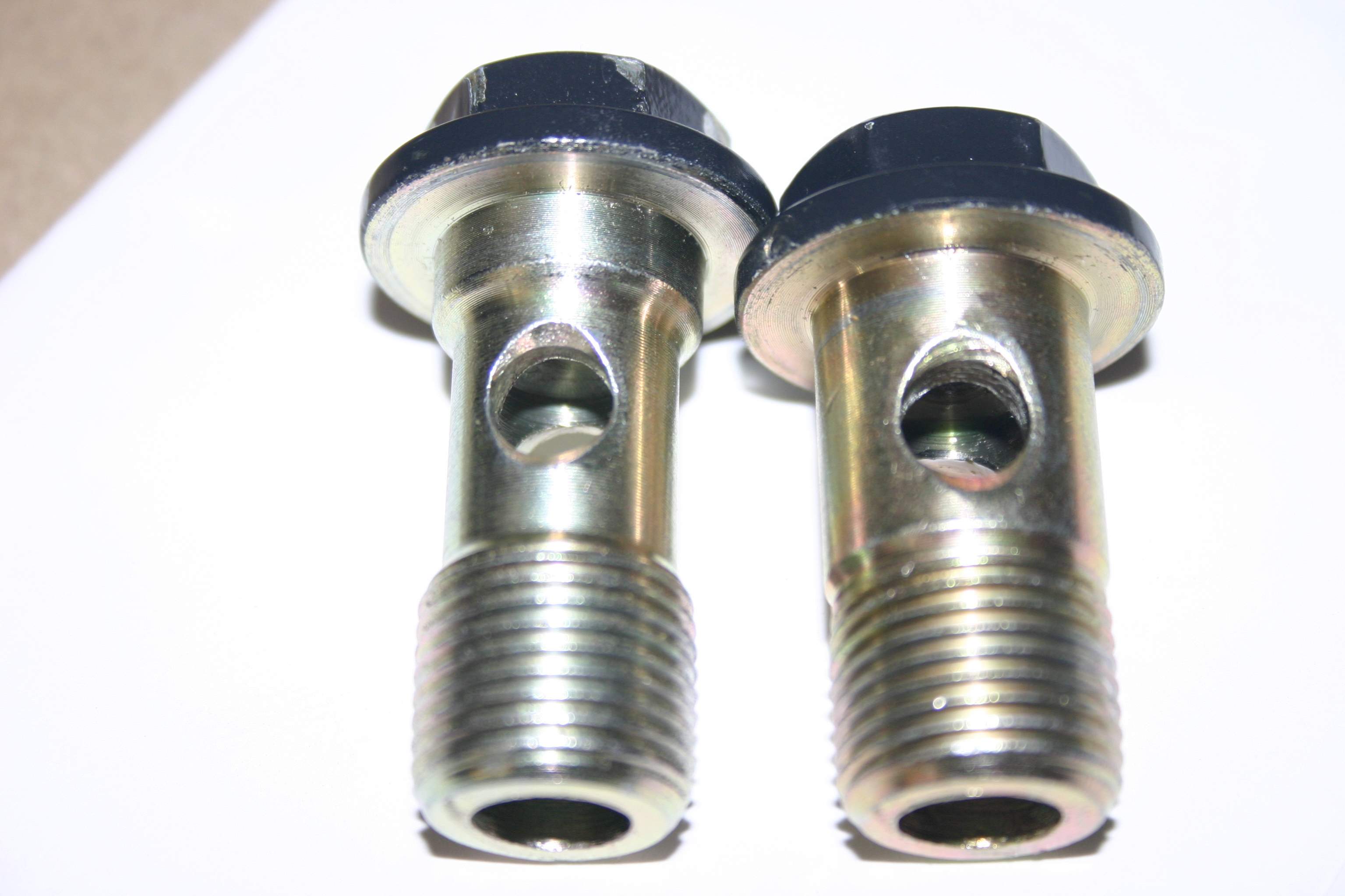

Here's a page from the DK35/40/45 workshop manual. It says it is a Kanzaki transmission. I think it is a Japanese company.
  • Kioti_HST.pdf
/ DK40SE Squeal When Moving in Reverse. #293
It says that they are the pump manufacturer. Are they also the actual transmission manufacturer? It is unclear to me based on what the page lists...
Thanks,
CM
/ DK40SE Squeal When Moving in Reverse. #294
From what I can tell from the picture a couple of pages over the HST hydraulic pump and hydraulic motor are in the same casting and come as a unit.
I can't find any reference to the manufacturer of the geared portion of the transmission. Of course, my practical knowledge of machinery is just slightly better than that of brain surgery.:eek: I could be reading this incorrectly.
If required I can upload a couple of pages tomorrow. But if you have the EX35 manual from the Australian site, it appears to be the same information as my DK35 manual.

I work with an engineer who back several years ago worked on a squeal in a hydrostat steering system on New Holland combines. It was an harmonic problem issue also. It took awhile to find the right combo of tubes and hoses to fix the squeal.

I also for one just believe that its simply a harmonic sound issue, and the steel pipes were causing this noise. By switching the pipe to rubber, this eliminated the issue. Its interesting to note that this noise only happened when the whether was cold and the fluids thinner. Didnt happen in colder climates. The power of the transmission wasnt affected by this.
I really believe some are making this out to be too great of an issue. I had a Ford Taurus that blew the transmission a little after 100,000 miles on it. When i took it to the transmission shop...the service tech told me flat out that nearly all older ford taurus's blew the tranny around 100,000 mi due to some plastic throw out parts in them. It was a known manufacturers defect and FORD did nothing to fix the old rigs or even acknowledge the issue... after 100,000 miles why should they.
MInd you Ford changed those parts in later rigs, but didnt repair the first vehicles affected. This is how ALL car companies react.
Even when my tractor made these noises, no effect on tractor was noticed. (ie harmonics again). Also nice to note that alot of Kubotas and even my neighbord JD HST unit are saying the same things about their HST trannies.
