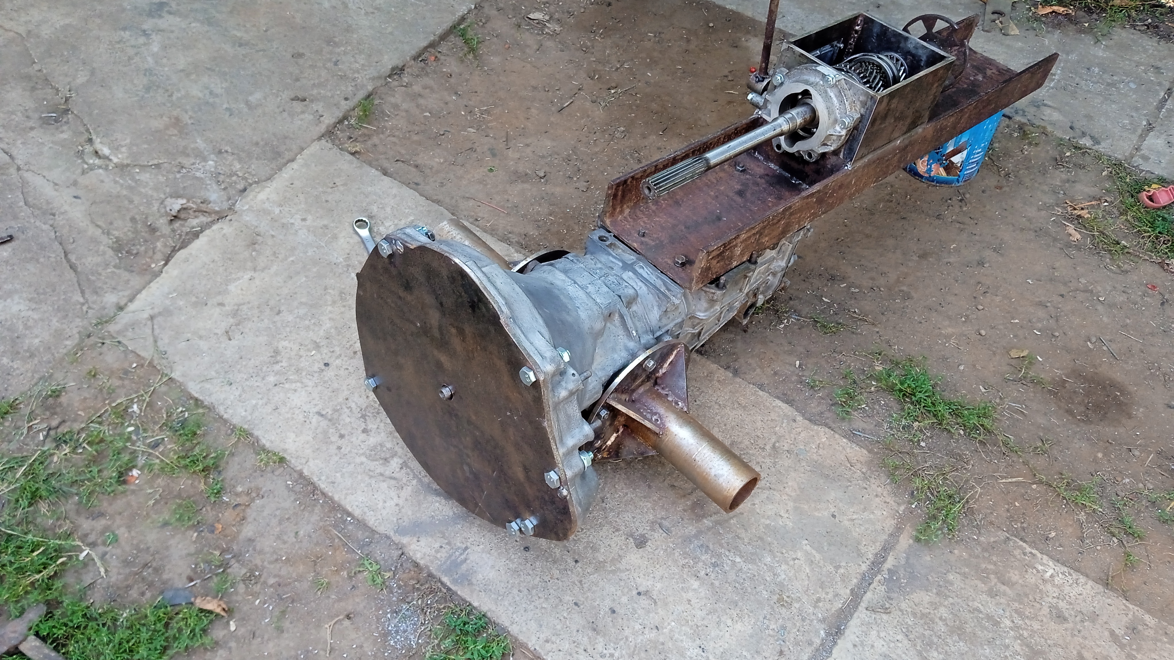

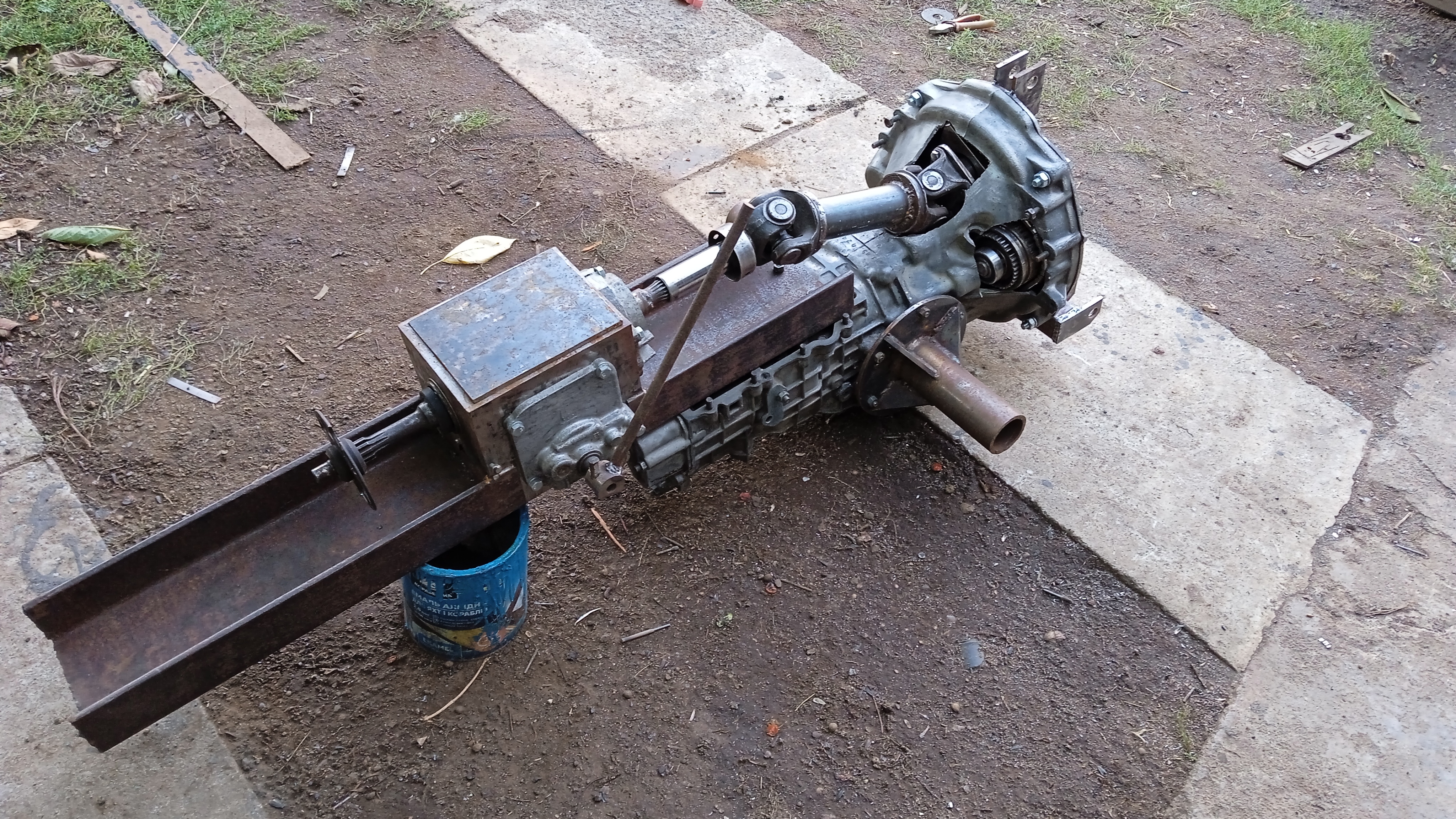

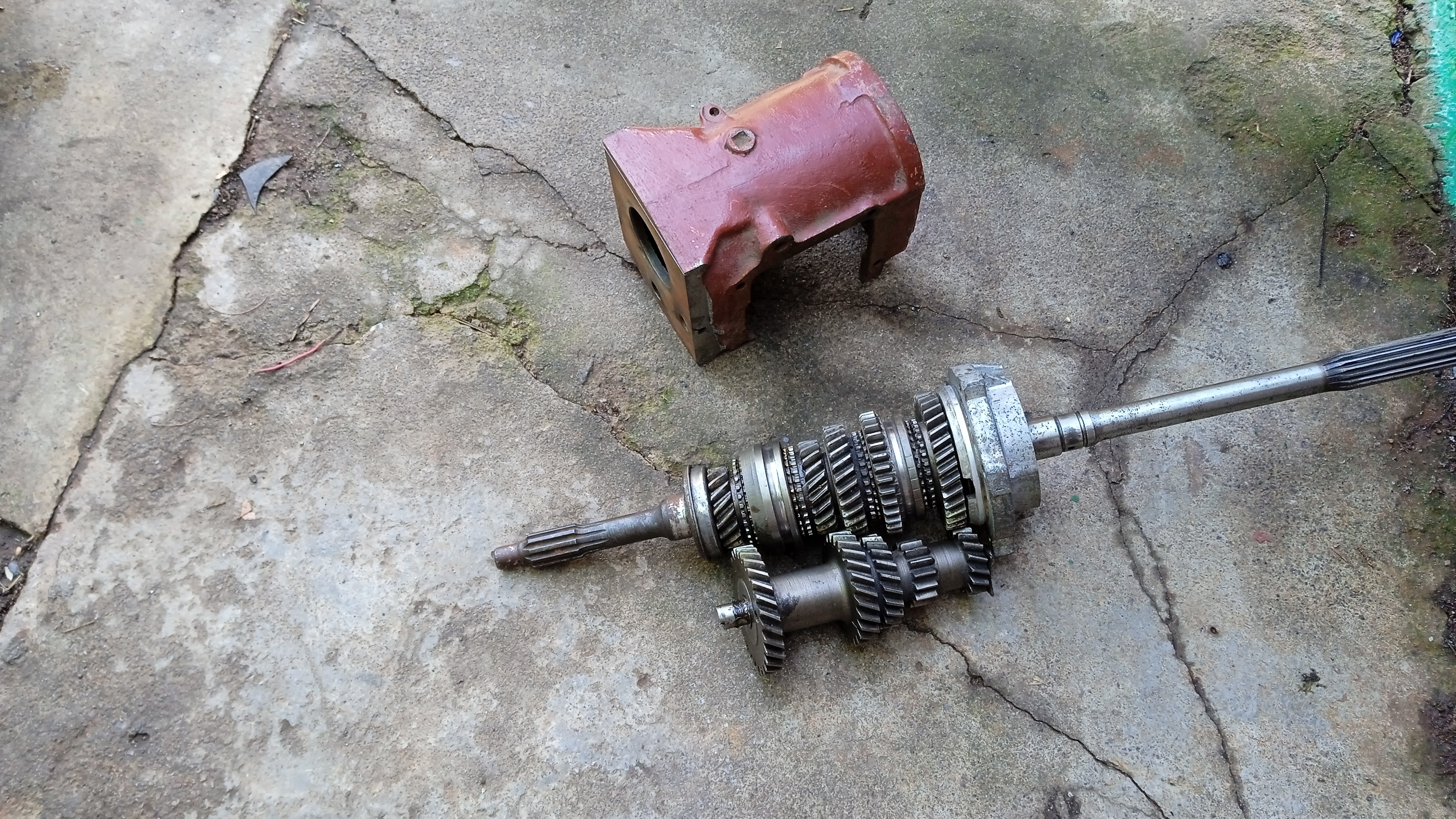

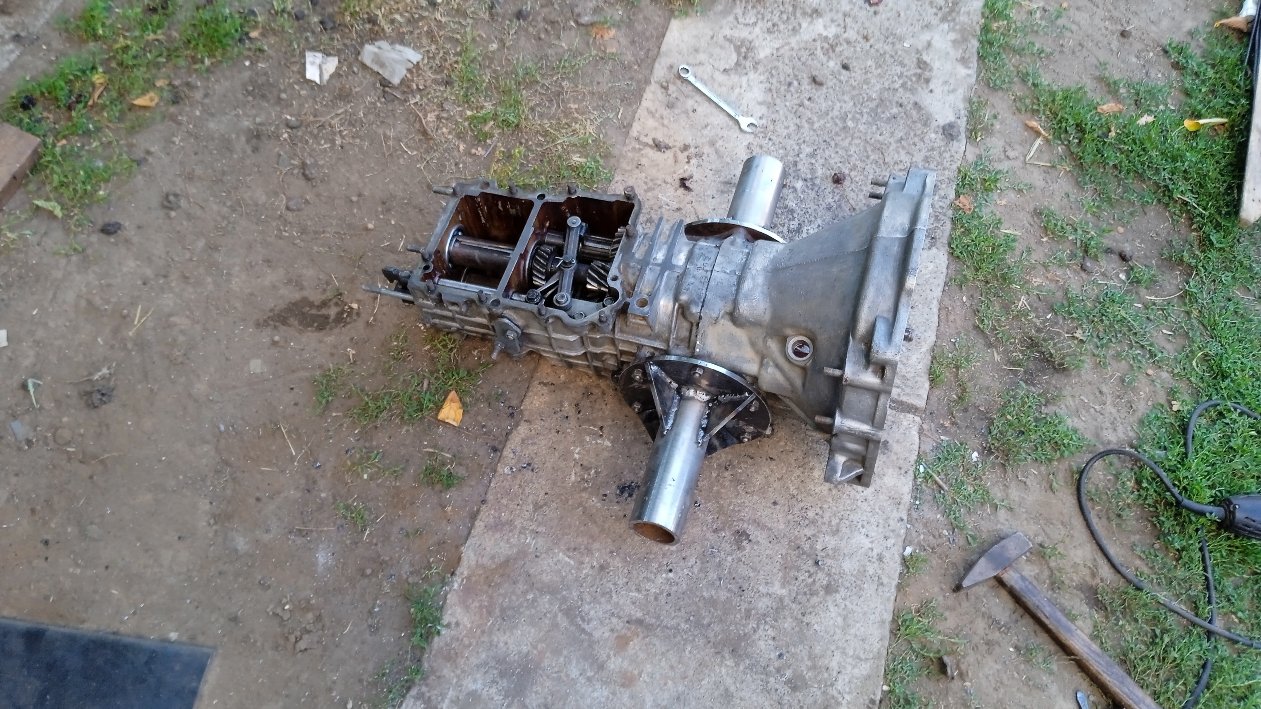

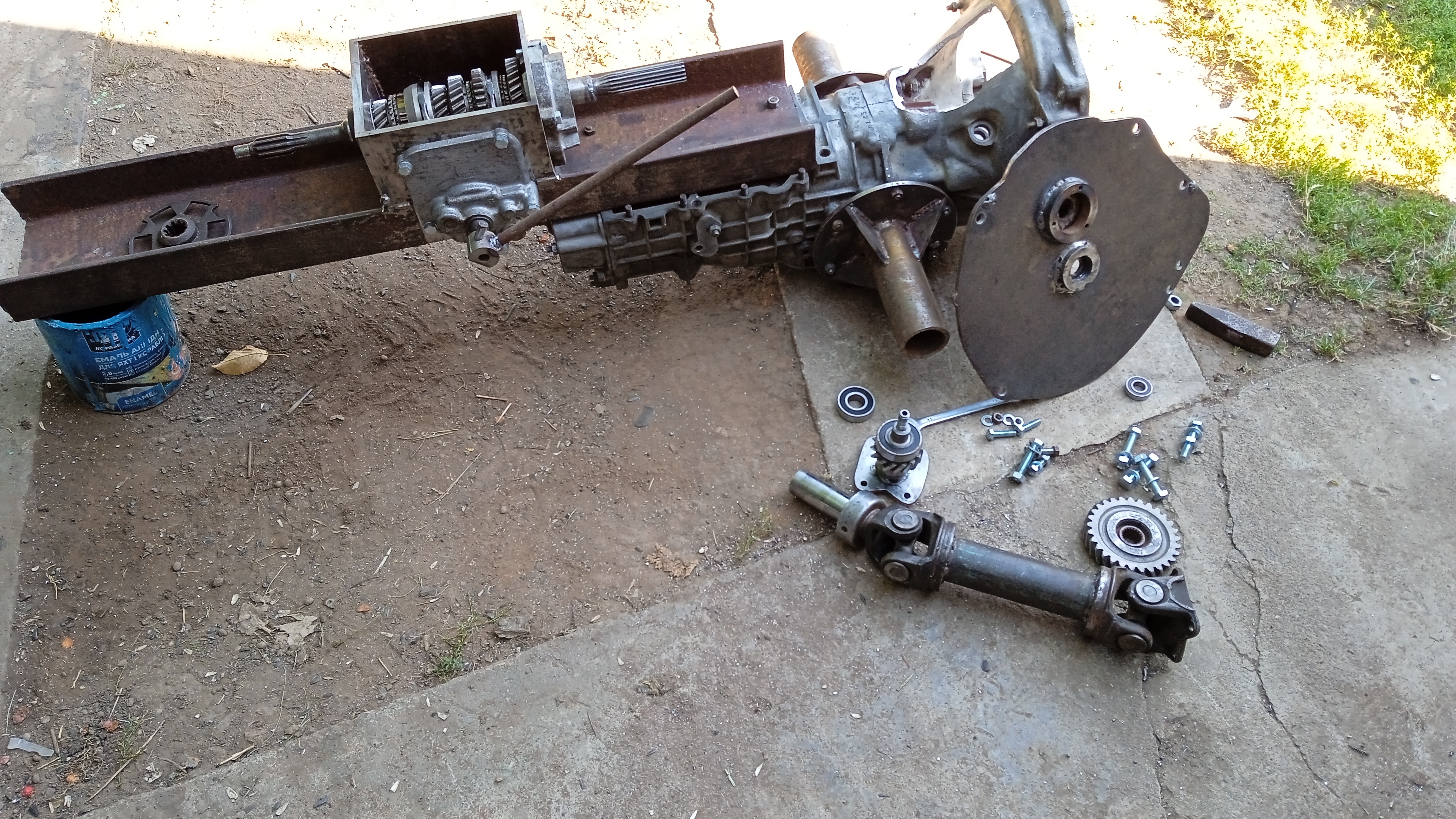

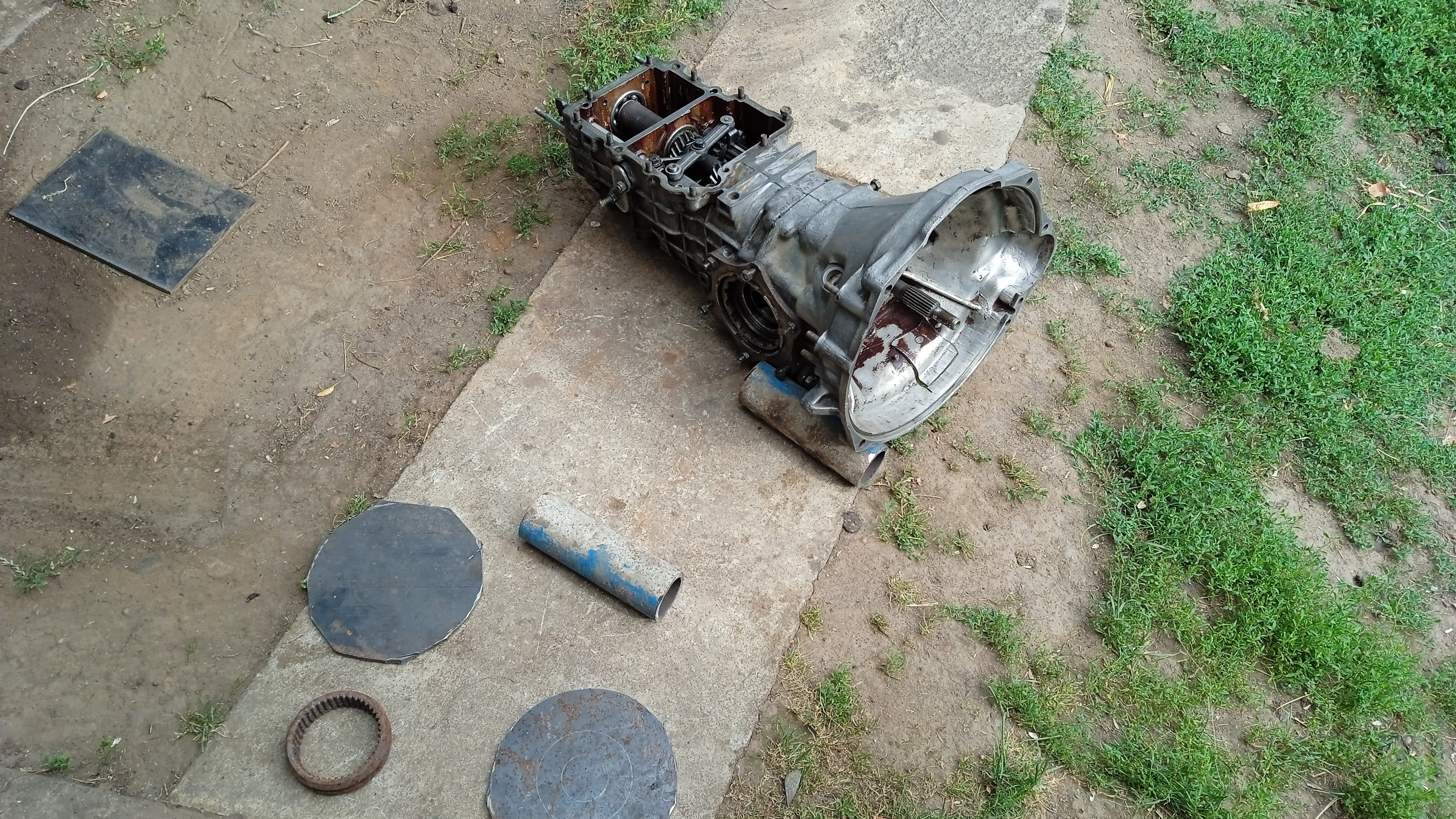

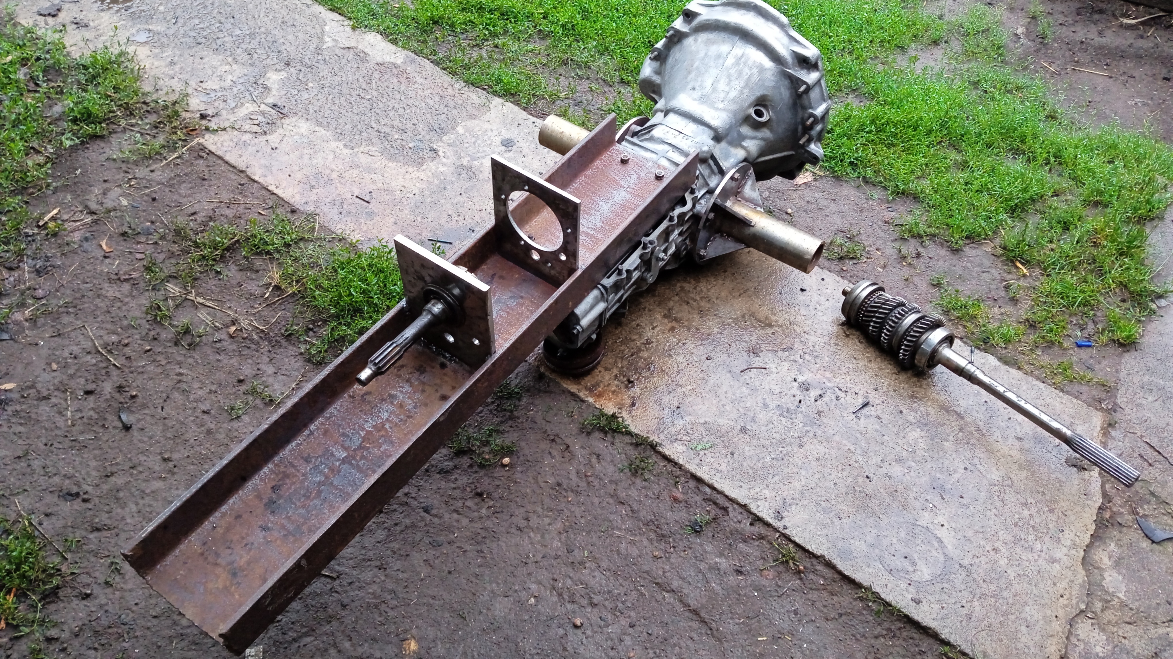

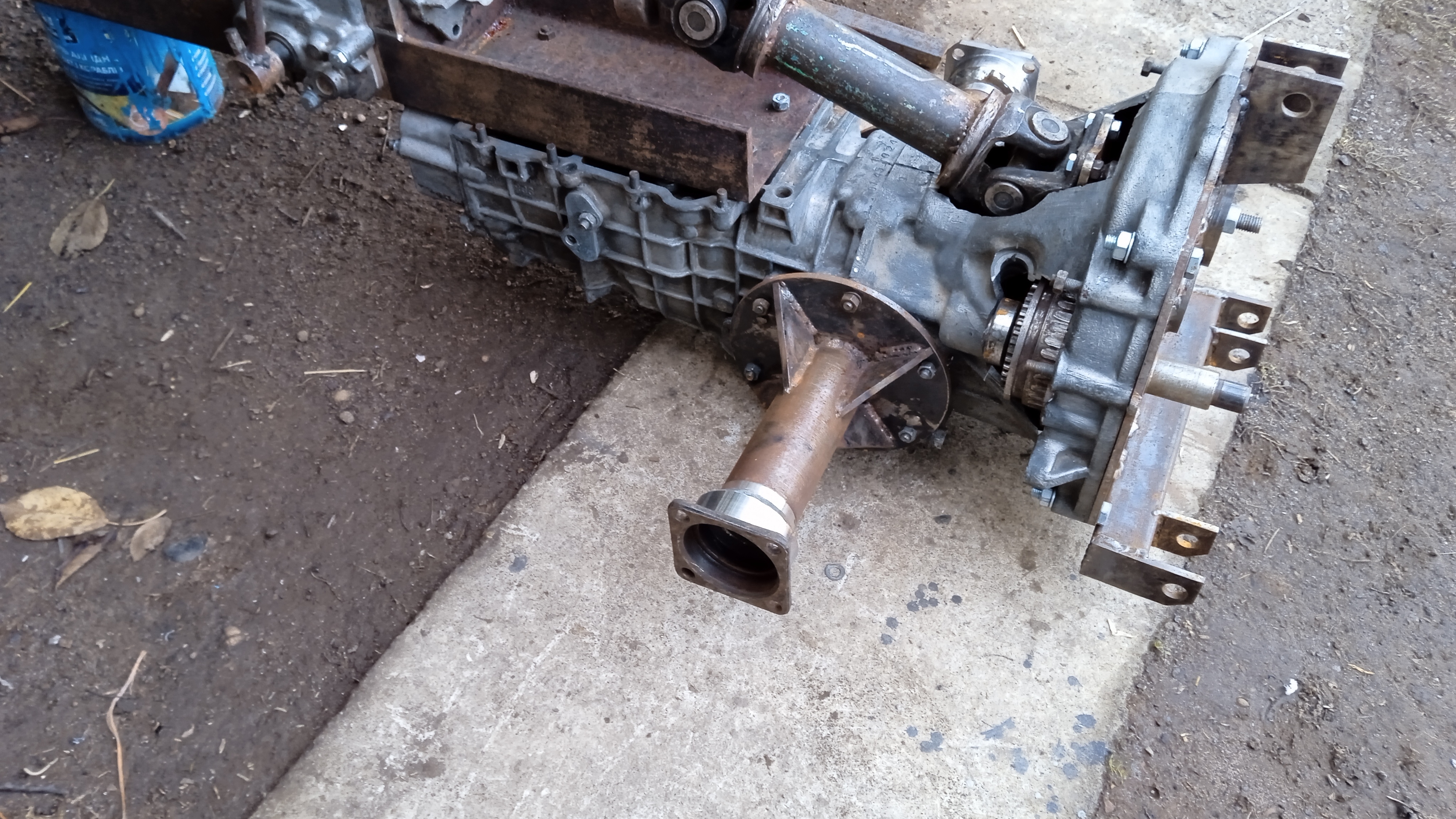

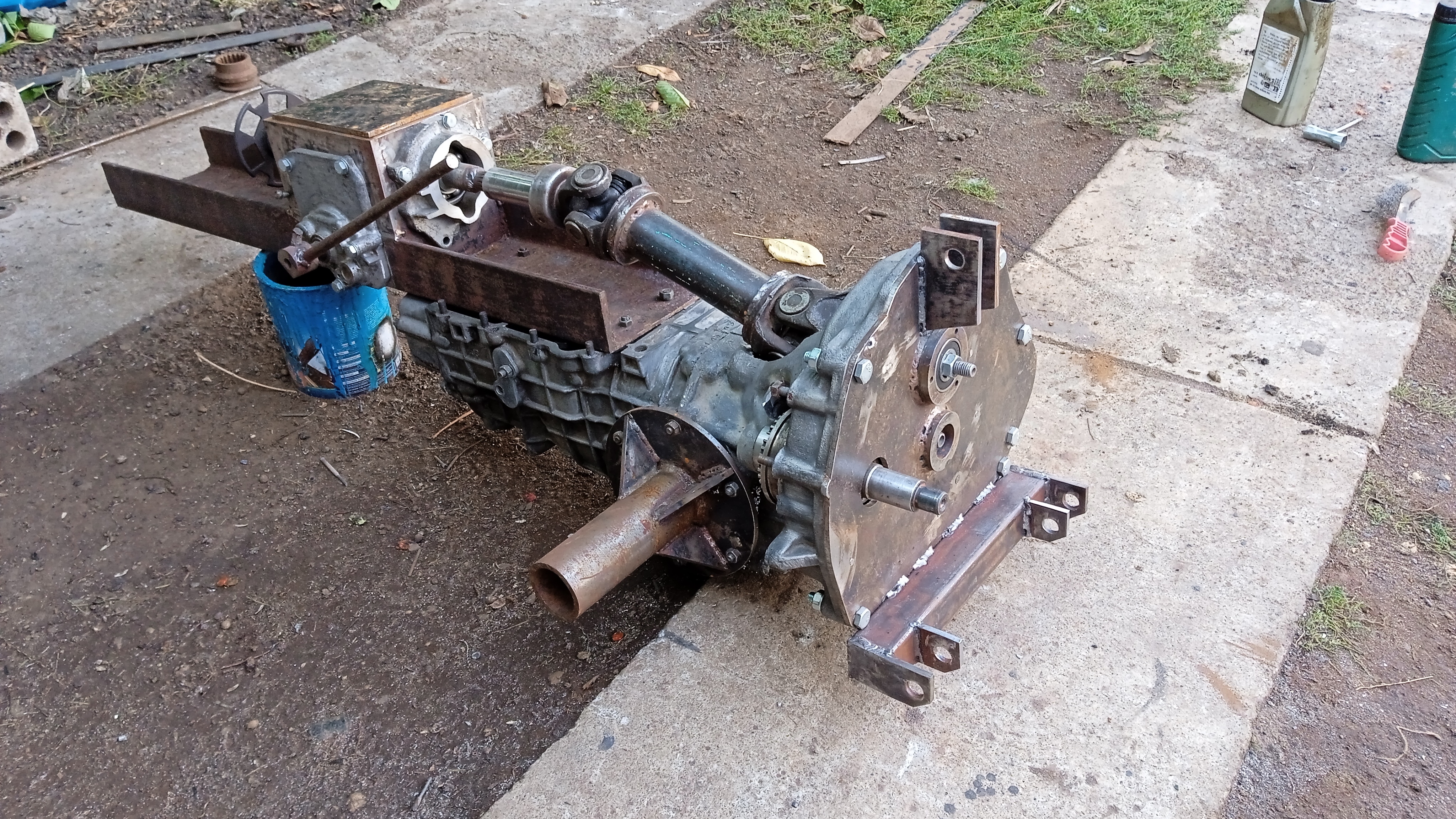

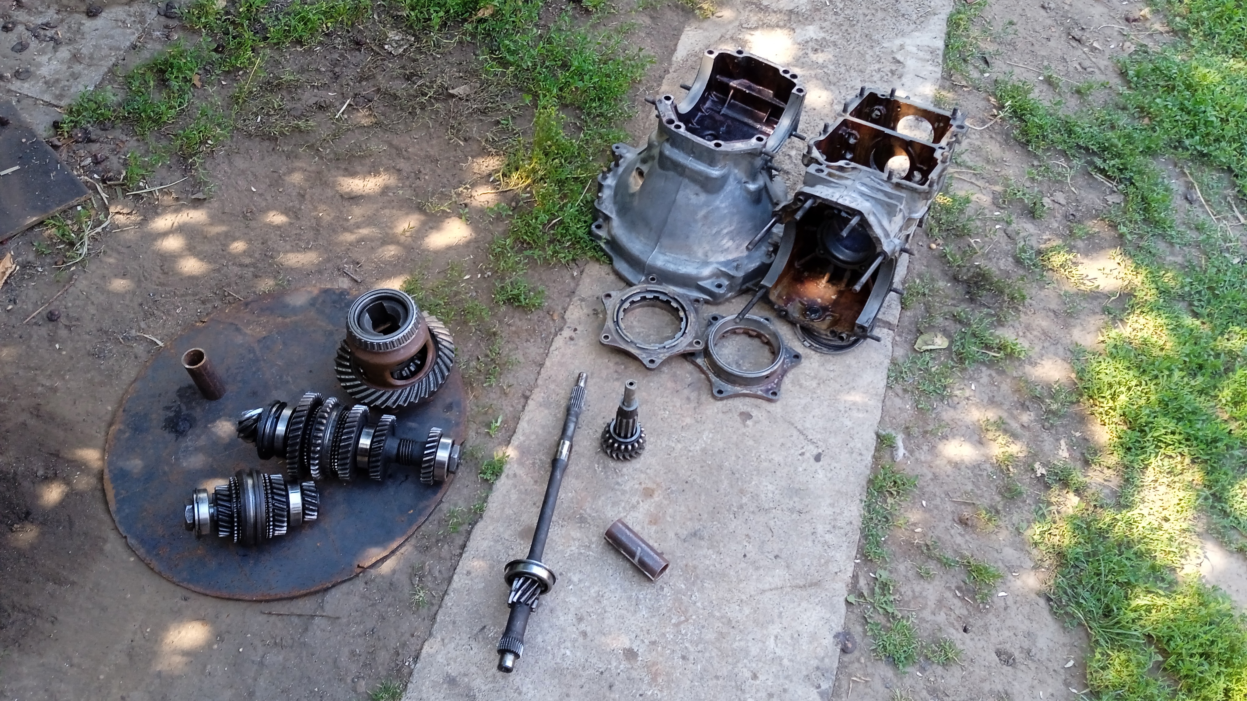

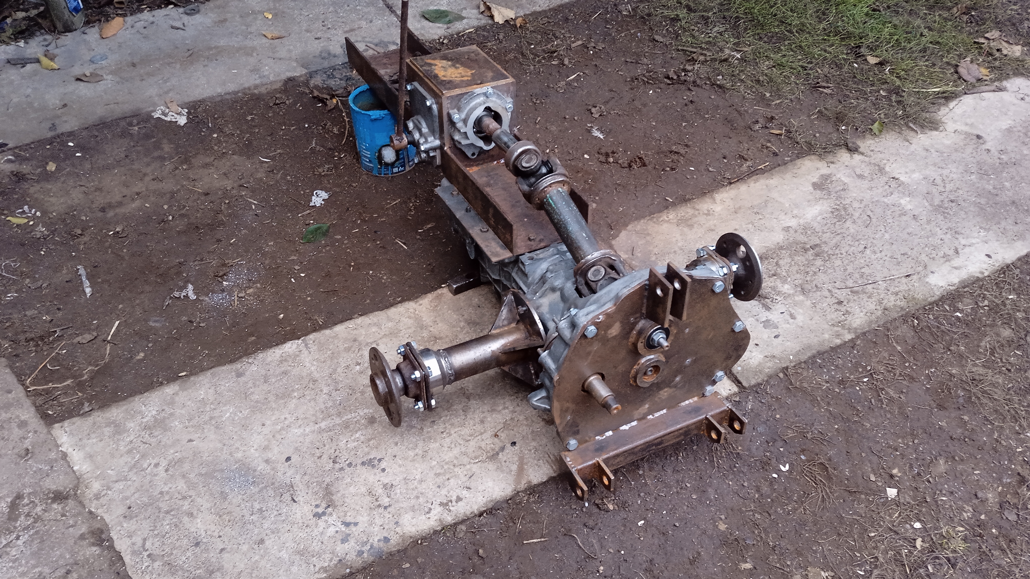

I used the gearbox from the car, dismantle 3-4 gears, they are now not necessary

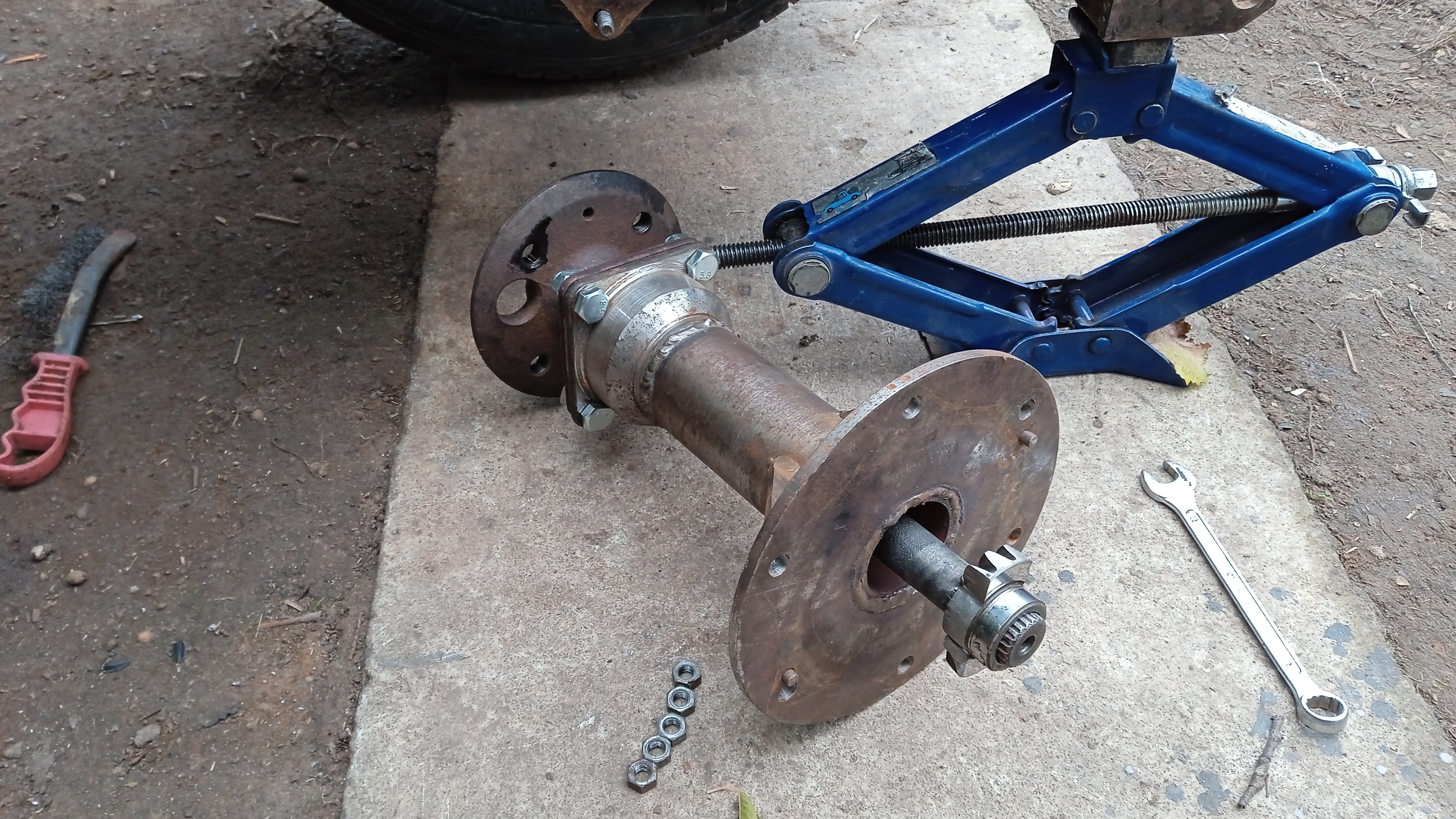

#11

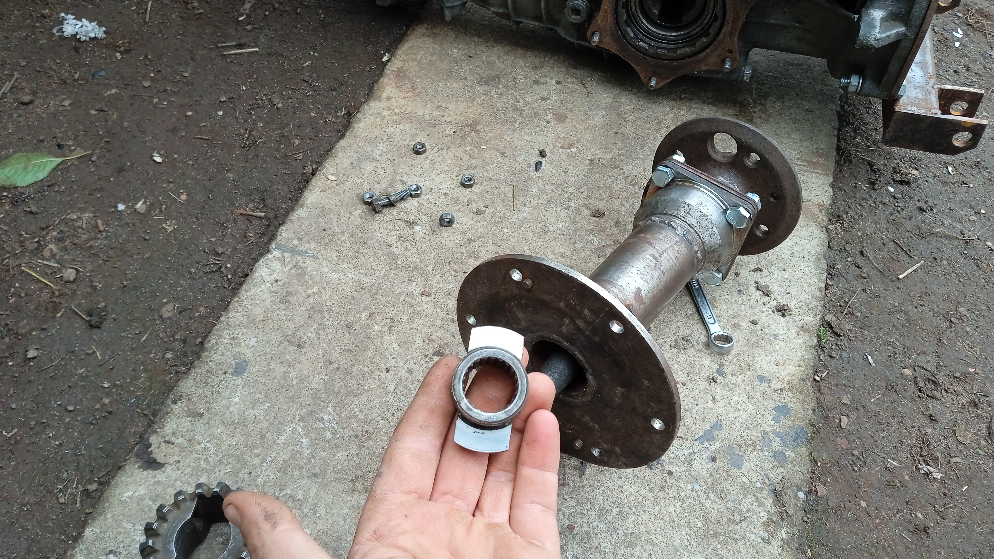

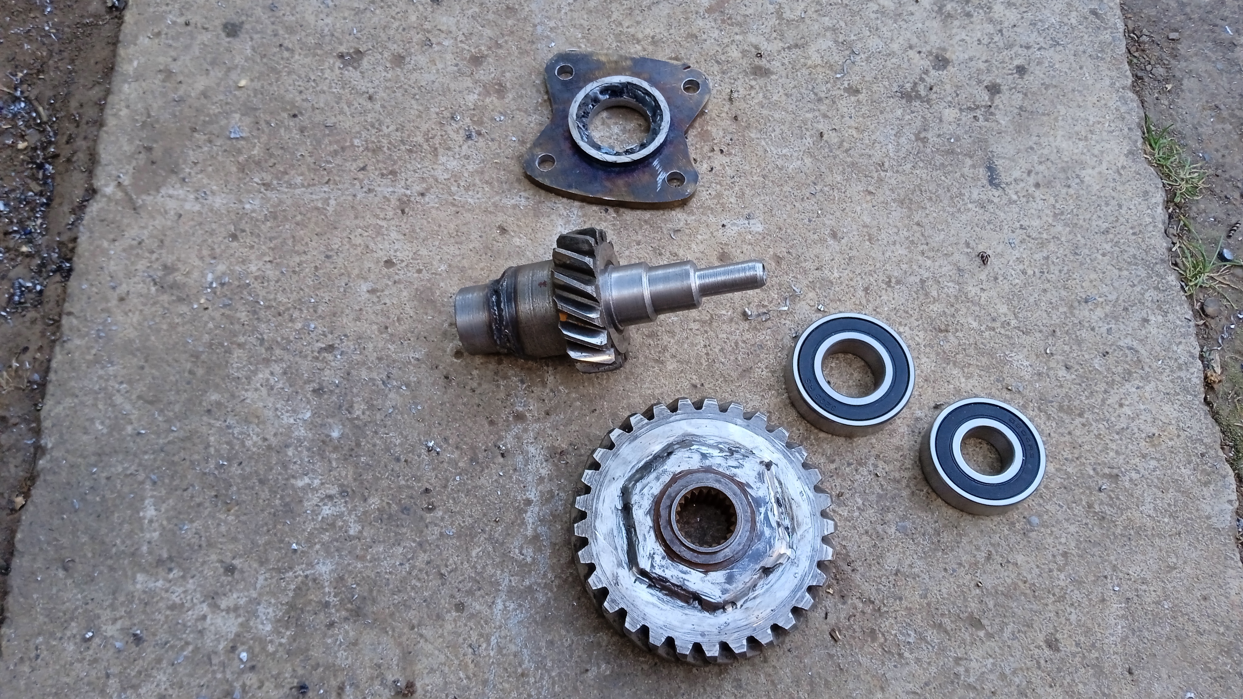

Shortening of the semi-axis. I didn't want to weld "butt to butt", I think this method is not reliable and the axis will break near the welding seam. I cut the axle to length, drilled the hole and pressed it in. Then drilled a hole, pressed a roller from the bearings into it as a key, and welded it in a circle. Time will show the reliability of this method.
