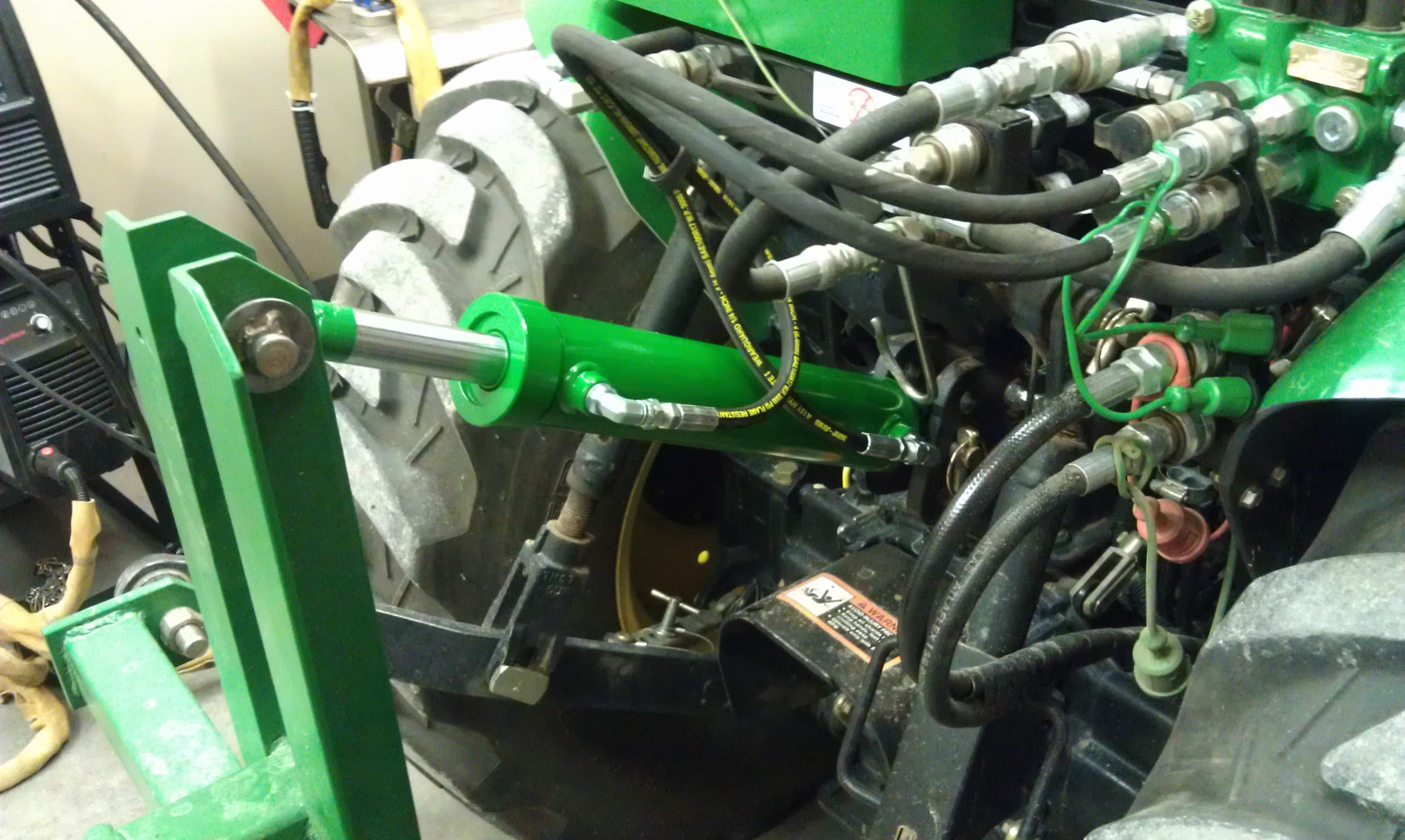

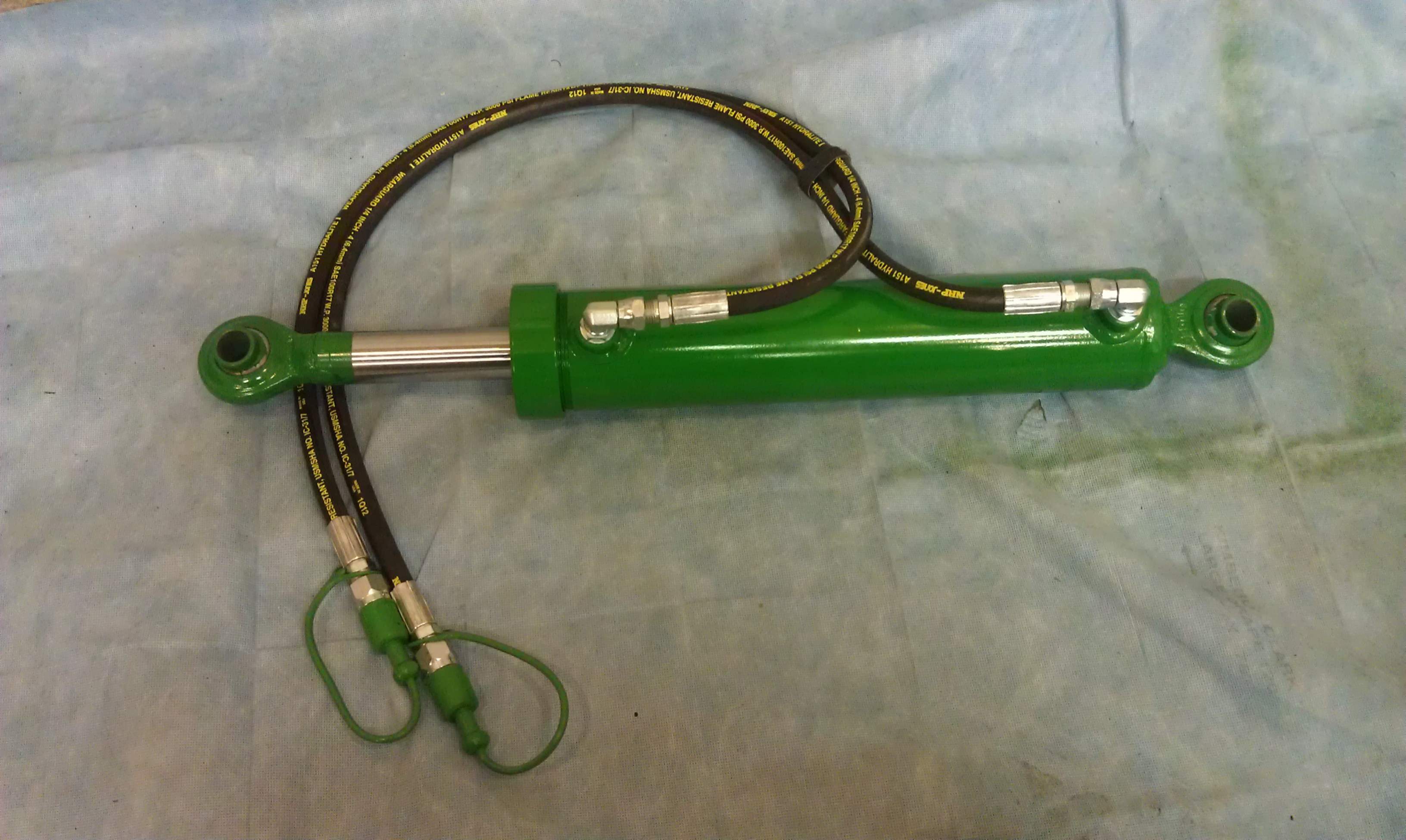

I made my own and Brian gave me advice, which I thought was really stand up of him. I think I saved about half the cost of buying it but when factoring in the time and messing around with running to the store etc. i was maybe a 1/3 savings. I just like to make my own custom stuff.
I attached a picture of my top link. The cylinder is from surplus center and the rest of the parts are from a big tractor supply store named fleet farm here in Wisconsin. Speeco makes the cat 1 swivels eyes.
View attachment 334370View attachment 334371
Nice job on the top link.
