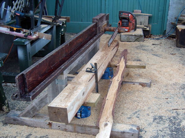

For softwood (hemlock mostly) snapping lines, cross scoring with the chain saw, and then chipping out the waste with an axe makes for pretty fast work. I did all the floor beams in the shop that way. (24 x 32) one side only.
A D handled garden spade works pretty well as a spud to debark. Just let the tree set about two weeks after cutting to loosen up the bark.
I really like that guide frame set up Egon! NICE!
Can you show or describe the bar clamp details?

Not much to it. The bar has a hole drilled in it with a 1/2 in. pillow block bolted on. Then a 1/2 in. rod is welded onto a flat iron plate that is bolted to the sliding frame and goes through the pillow block. Then a bunch of one in. Spacers to vary the thickness of the board being cut.

Egon, that setup is really nice!
