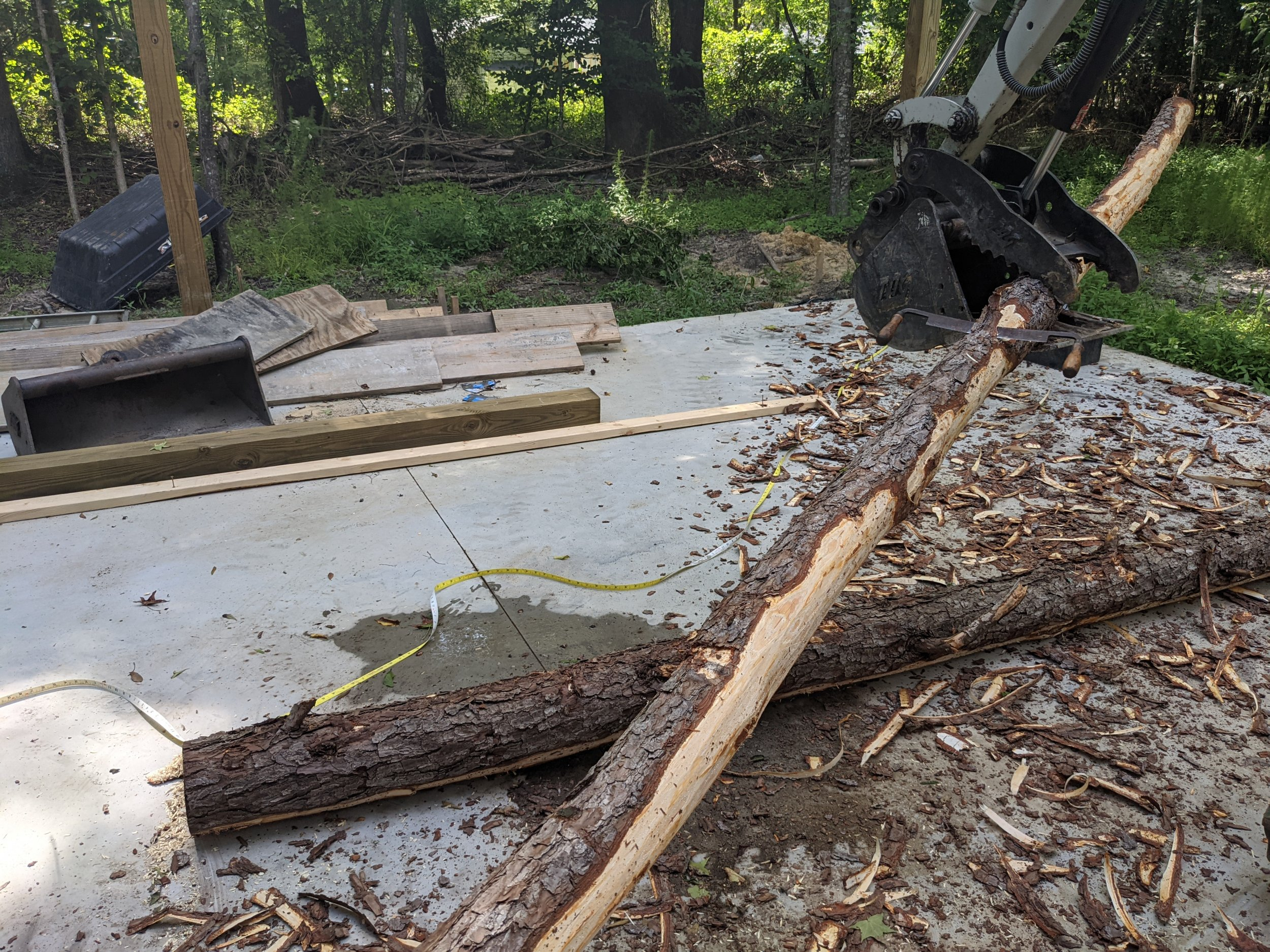

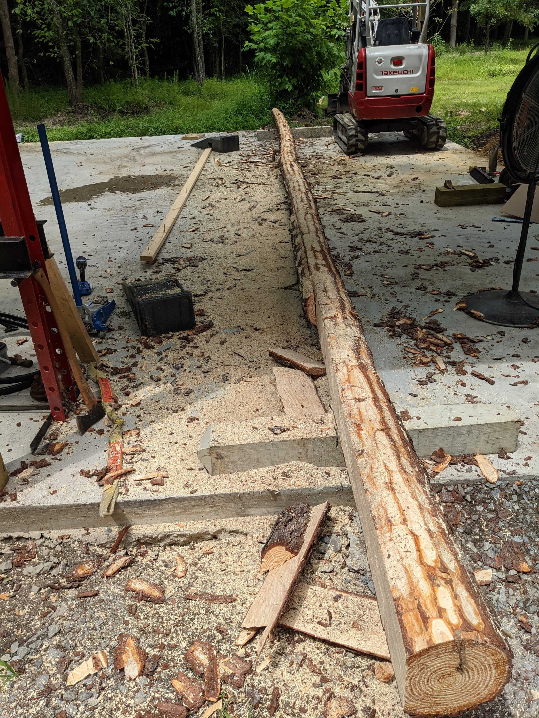

I wanted to turn the pine tree into a 32ft beam but I gave up(at least for today, probably for good). It's actually cutting square and straight, just going way too slow.

I just cut it to 16ft to get it out of the way and I'm going to try to make a 16fter out of it. Just cut another closer to the diameter I need, draw knifing the bark out of it and going to use it in the round. Would be easier it it wasn't 94 with 104 heat index...

16" bar chainsaw, regular chain not a rip chain. I found the straightest 2x4x16ft I had. Then I debarked the area of the cut and screwed the 2x4 top of it(leveled the 2x4). I used the metal tooth claw thingie on the inside of the bar and bumped that up to the edge of the 2x4. Then I started a very shallow cut while eye balling the blade parallel to the 2x4. Once I had a good 3 inch deep groove cut I removed the 2x4 then just kept working the bar in deeper from a shallow angle to steeper as I went. I was really surprised how easy it was to keep the cut "plump". I tried doing like this from seeing some people's u tube videos where they just popped lines on top and relied on feel/experience to stay even. Their boards looked as good as many people with Alaskan mills so I gave it a go. I was surprised how good and square it was going but my back/hands were hurting from the slowness.

Debarking before the pine bore beetles get in it. Draw knife from a yard sale.
