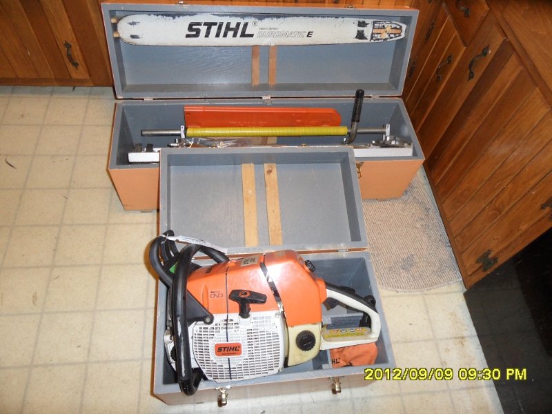

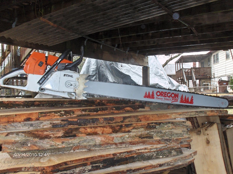

I have about 10,000 black locust trees. About 2000 of them are 12-20" diameter. I'd like to make 6x6 or 8x8s and use them to build a post and beam screen house by our pool in the next few years.
IF you have the chainsaw and want to do it at low expense a chainsaw mill MIGHT be a solution.
BUT black locust is HARD and you'll probably need at least a 90CC saw to do the cutting.
I've done 16 to 20 inch red maple with a 62CC saw and it was slow (and low). Moved up to a Stihl 660 and it was easy.

I've a 120CC in reserve.

BUT if you don't have the saw an entry level Woodmizer or other brand sawmill is only about $3,500 and will save your back.
A good 90CC costs about $1,000 or more. And if you have 2,000 trees you could make good use of a sawmill.
