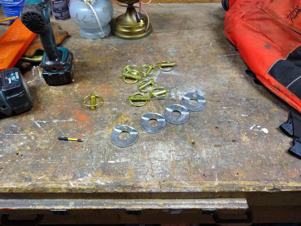

Excellent tutorial Dieselmh!
And LD1 takes it to a whole new level. Great ideas here.

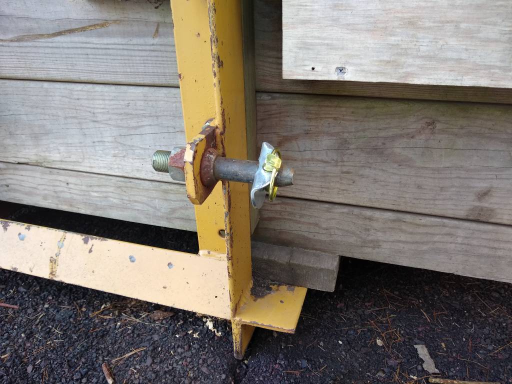

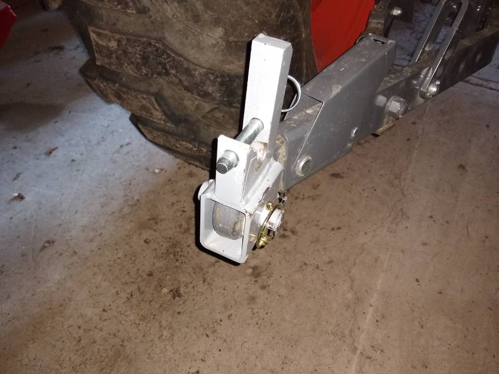

Copied a great idea. Thanks! I do not have Pat's easy change, however. Somehow I found carterandsonsllc.com and these work for me. Swapped out the 1/2" pins for the pins that stay in place with the little detent ball. IMG_20200302_095258501.jpegIMG_20200302_102510733.jpegIMG_20200302_102616712.jpeg

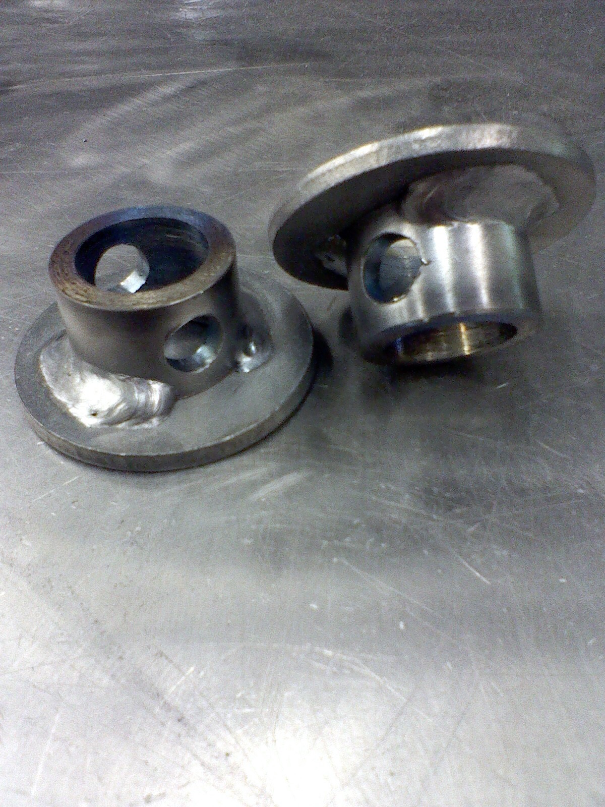

Since I was bored and had the time though, I made mine a little fancier in case anyone wants a different idea, heres a pic
LD1,
Did you use one inch round tubing to make these I assume?

I really dont remember now it was so long ago. And dont have them anymore because I upgraded tractors and quick hitch.
Since the pins are 7/8" diameter, I doubt I went with pipe. I probably used 1-1/4" or 1-1/8" roundstock and drilled it out to 7/8" ID on the lathe If I had to wager a guess.
