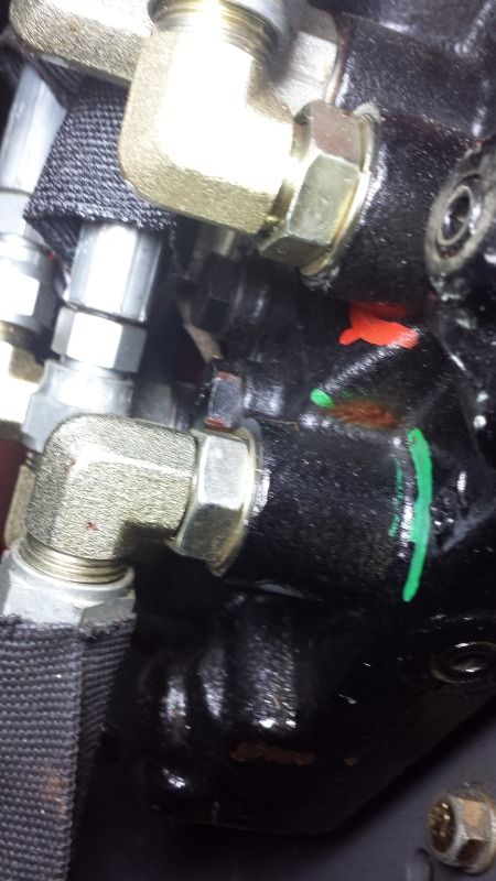

The valve body is shown in all the pictures, it's mounted below the operators station and cable operated.
/ Diverter to 3rd function
#27
Other issues came up, but trying to get back to this project this afternoon.

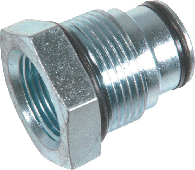

I opened up what we think is the PB outlet, and the black nut just above it. Pictures below of both. The hose adapter is nothing more than a jic to oring hydraulic connector. The nut has a recessed hole in it that a small pin with a flared washer type bottom slides into with a spring between them....something pressure related?...but not sure it's related to the PB, unless it handles the requirement for a PB adapter.
I do not see anything that looks like the PB adapter you spoke of J_J.
The hose I took off, traces back to the rectangle box I spoke of. From there one routes to the casting immediately below the rear remote valves, the other goes back into the tractor at the very top of the body.
It would appear the line I took off, feeds the rear remotes....or the rear remotes feed the FEL valve. From J_J's post, it feeds the rear remotes. This means, that the PB adapter...has to be there somewhere, or the rear remotes wouldn't work?
sorry for the blurred pic.

The other PB adapter looks this.

Can you verify the other ports on the valve?
The IN port usually has the relief valve close by.
The OUT port will connect back to tank, and you may see some tees in that line.
Then you have the four work ports.
Only port left should be the PB and it should have something in it to separate the galleries so the PB fluid will pass downstream,and the cyl fluid only goes through the OUT/return port.
Can you take a better picture of those parts that came from that port.
One PB adapter is a sleeve type fitting as in the first picture.
The other PB adapter is only a single 1/4 in plug and fits down inside of the port. Are there threads on the inside bottom lip.

The loop is not there, instead the line 050 connects to the line I removed on the green marked port on the FEL valve, that we was thinking was the PB port. The other line at the loop goes to the line behind the 4 work ports. You can see that line in the first picture in this thread. The 7th line, is shown in the 2nd picture on this thread, that come in near the top of the valve, and next to it, does appear it could be a relieve valve, and from your description this is the IN port. It is a larger metal line and goes back only a short ways then into the side near the top of the tractor.
So in my way of thinking, we have id the IN port, and the 4 work ports, we have the bottom line on the fel connecting to line 050, and the other line connecting to 010. 7 ports on the fel valve is all there is, right?....BUT I don't see anything that looks like the PB adapter from the line I took off.

That item has a solid head, unlike what J_J posted.
The three items on the right go together and screw into the opening above where the hydrualic hose was attached....which we were thinking is the PB port. It's design is pressure related...to probably control fluid internal to the fel valve based upon pressure.
Given where those two hoses from the fel route to, should tell someone the correct story, but I don't know enough ....yet....to say. I wish I knew of a M7040 with 3rd function so I could look at how it's plumbed in.

It could be that whoever did the FEL job left out the PB adapter.
If you did not have PB, The pump fluid would try and take the route of least resistance, and that would be the OUT port. .
So if the remotes and 3pt work, then you have PB somewhere.
Did you determine the manufacturer of the valve?
Are you sure tr parts yu removed are not the load check.
Is there a similar port on the other side of the valve.
Most all hyd valves have load checks, usually between the work ports or close by.

So the hose I took off, that routes to hose 050, is my PB port? If so I should simply route hoses from that port to my 3rd function valve, and back to the hose so it can continue on it's route to that hose number 050? Sounbd right?

I am still not sure you have PB as I have not seen the PB adapters.
You haven't answered my questions about a manual for the loader, or that you have seen a PB adapter.
Who is the manufacturer of the valve?
Is there a threaded hole inside the green port?
If your remotes and 3pt work normally, then we must assume that there is an adapter somewhere.
If there is no PB adapter, the FEL valve would work fine, but pump flow and cyl flow would take the path of least resistance and go though the OUT port.
On some of the Prince valves, the PB screw in under a plugged port, and the port used for PB out will not show this. Prince LVS, and LVT valves are like this.

Have no manual on loader, nor seen PB adapter.
Mfg of valve, no idea, I see nothing on valve to clue me in.
No threaded port inside green hole.
Give how the fel valve is plumbed in, th PB port should be identifiable by where those hoses go. I've identified all that, but not knowledgeable enough to still id the PB port.
