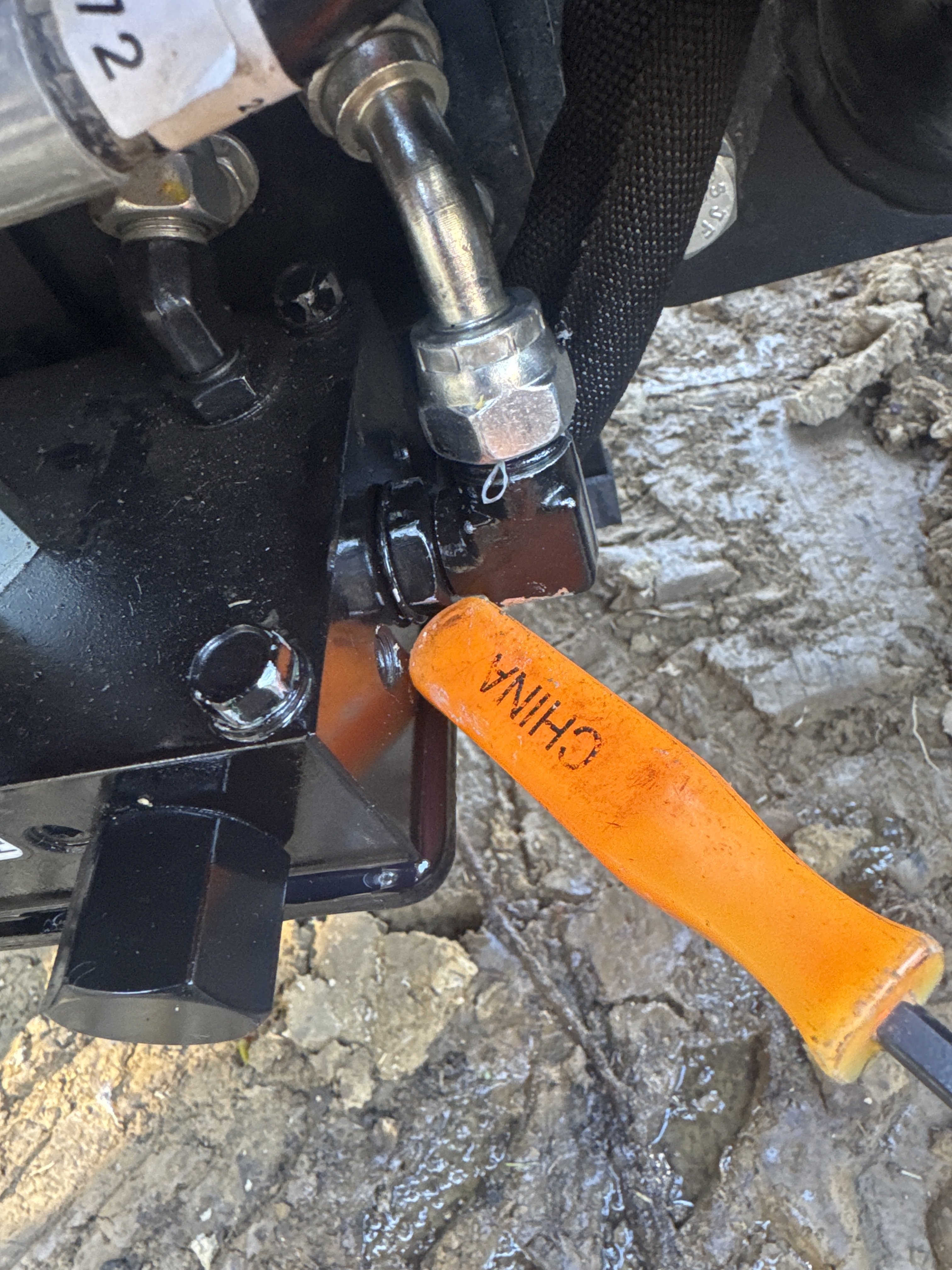

I’ve narrowed it down to this connector, replaced the o-ring which was hard as a rock. It leaks from the bottom of what I can only describe as the pump discharge line. When I put it under load it gets worse.. a lot worse. I checked the body of the valve and didn’t see any cracks. And the angle connector looks just fine as well when I wipe it down on bench.

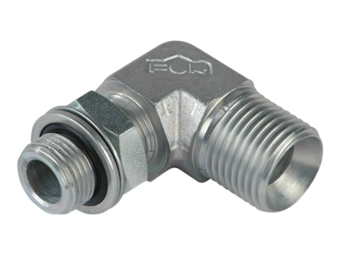

That's an adjustable elbow. Essentially, you screw them down almost all the way, point them to the correct direction and tighten the jam nut.
There are usually some washers that keep the o-ring in place. I'm not seeing those there.
Also, that 45 degree fitting that comes out of the elbow, seems to have teflon tape on it. That's a big no as none of those fittings visible in the photo use teflon tape and that fitting in particular has a 60 degree taper that does all the sealing.

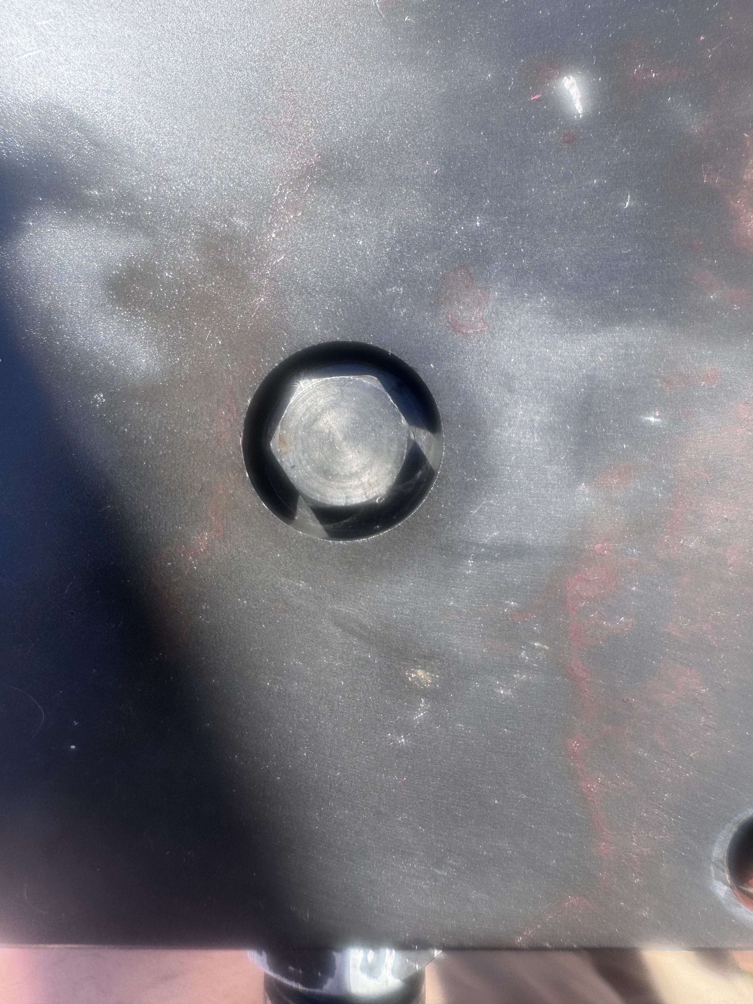

Update: so I found the source of the leak. It appeared to be coming from the elbow, upon further inspection it was not. For those saying don’t use Teflon tape, the tape wasn’t the problem, the tape was applied prior to me, most likely at factory or after the first time it was repaired by the dealer. I did find however that the o ring on the underside of the body was infact highly corroded. Replaced with a new one, and stress tested, no more leak. Photo attached for location and reference.
For those that said to check o rings and seals thank you for pointing me in the right direction.
