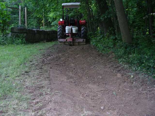

Here was the tool I built. It was designed to mount on the the grader blade. I removed my standard blade and built an angled blade. Cuts a nice gental swale. When I need to clean out the filled ditch, it fits the old shape.
Because it mounted on the grader blade frame, it is adjustable to discharge.
Patrick T

/ Ditch digger #79
Great job Paddy! Simple yet effective.
I have thought of doing that same thing, and even being able to create different profiles for different situations, steep "Vee" cut, or gradual 1" to 2" barely noticeable swale.
Again, simple yet effective.

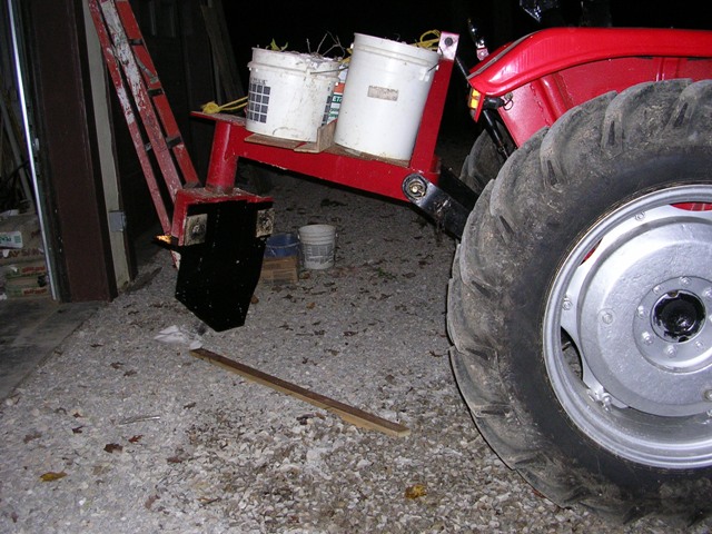

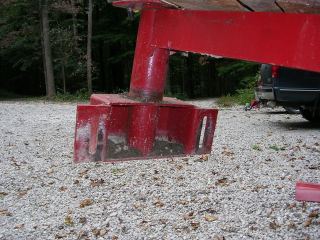

/ Ditch digger #80
Skunkwerx,
Thanks for the comments. I did as you wanted, made several options. First photo is the base of the grader blade. Second photo is a deep/sharp digger. Same idea as above, but a diff shape. I have to add weight to get a good cut but both are sturdy and will cut decent size roots. I use this one for deep narrow ditches.
Both work on the idea I can stradle the ditch. It's best on the equipment too.
Patrick T
