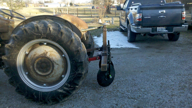

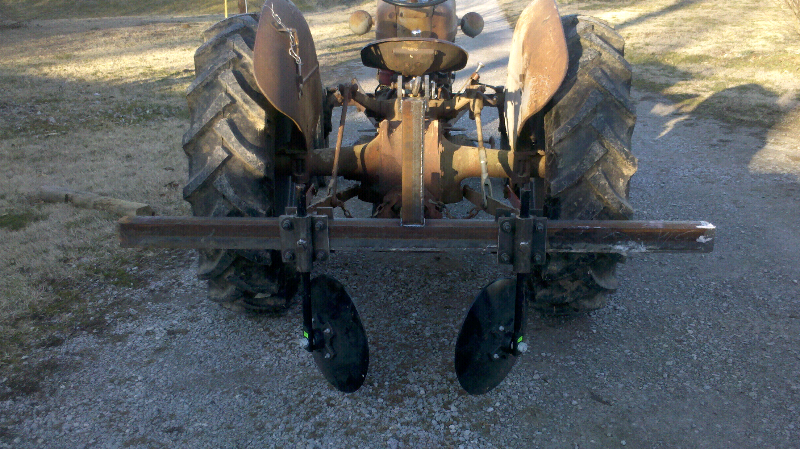

Took a idea from Briar Hill (with a few changes of my own) turned out great!

Looks good. :thumbsup: I have something very similar for hilling our pumkins.

Red...what size are your disks? I am thinking of getting a hiller, (bedder), and have a choice of 14 or 16 inch disks. Is bigger better?
   / disk hiller #4
I purchased the 16 inch. The way I had it figured is that you can always raise the implement to decrease the depth of the cut, but if smaller discs are used, you can only cut so deep. I mounted them on a one row cultivator, 2 tools in one.
Biggest is best

I just hope I can get the rows close enough together. I have alot to plant and limited space
