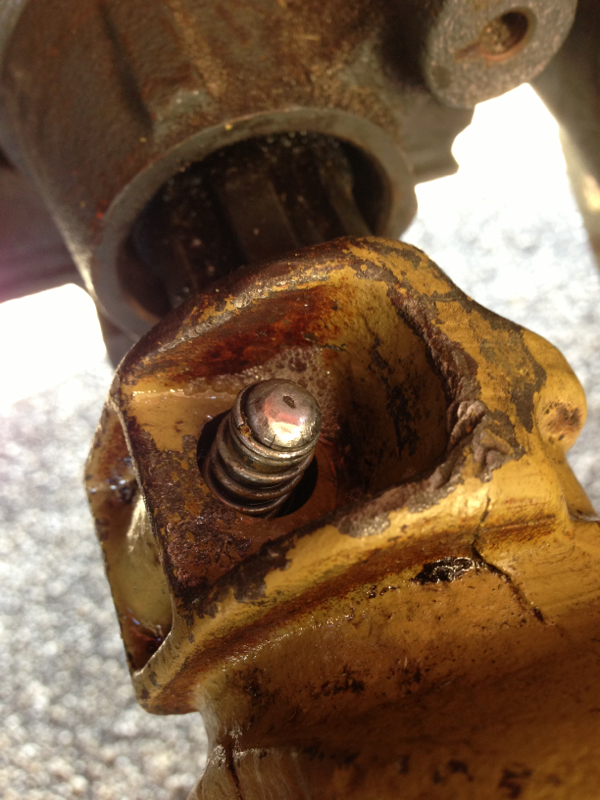

Glad you got it off with no major damage to you or equipment. TSC or any equipment dealer will have a replacement pin mechanism and can tell you how to replace the old one. It isn't very difficult.
Gwdixion, sorry about that. It happens to me too. You know us Appalachian Americans here in NC don't think too fast LOL
/ Disconnecting 3 point tiller #24
Ted: You are forgiven, this time. :laughing:

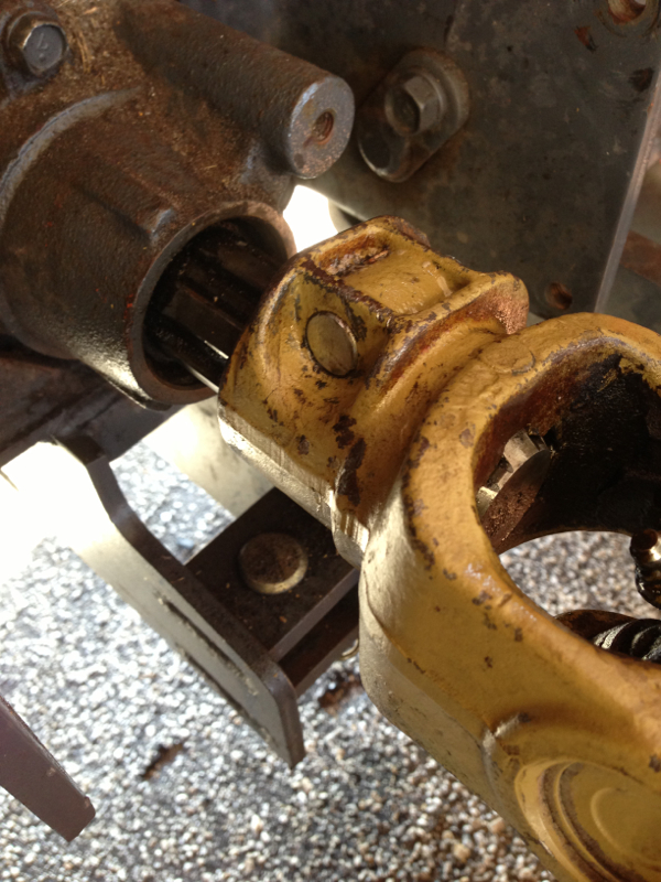

Now the job is to get that pin loose. Now that it is soaked in WD40 try tapping it back the other direction. Then depress it. Go back and forth until it is freed up.
If that fails then a replacement is necessary. The whole PTO shaft doesn't need changed (very expensive). Try to find a pin first. Second would be to find a U-joint end. In fact, you don't need the full U-joint, just the yolk.
Splined Bore Yoke, 6N - Tractor Supply Online Store
There are other sizes. Take yours in to compare.

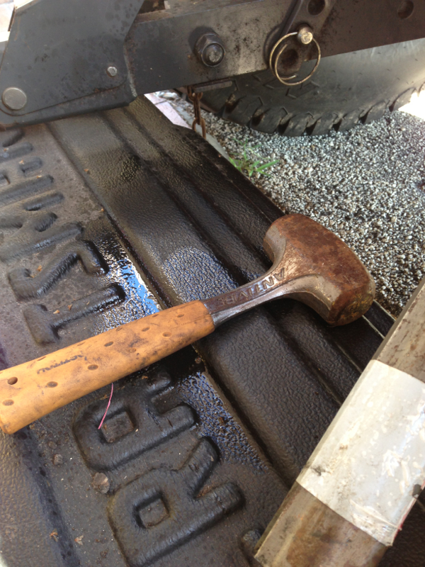

/ Disconnecting 3 point tiller #26
It's OFF !!! Thank you , everyone! Triple Rs Bigger Hammer! MORE FORCE!!! Also sitting around talking with my older, 77, brother in law, watching WD 40 sink in, Did it!
Pin goes through to other side. There must be a problem with the pin because it still won't pop out. Have a great night. This 68 year old is going to hook up the Bush Hog with a well greased PTO and cut some pasture!

I also do the walk around method and then decide if I'm willing to replace a part or the whole thing after I beat it to death but usually my later attacks work, sometimes they don't and I have to take the mangled part in to get a replacement.:D.
