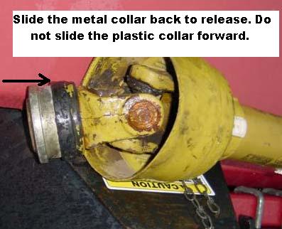

Any chance that pin is a shear pin and the actual release mechanism is one of the pull collar types?
Picture credit: tawilson
That occurred to me, also. But the OP put it on. My wife's cousin loaned me a tractor with tiller & PTO attached. It was my first ever PTO disconnect. He told me it was a pin. I had to look on here to discover there ain't no pin, it was a pull collar!

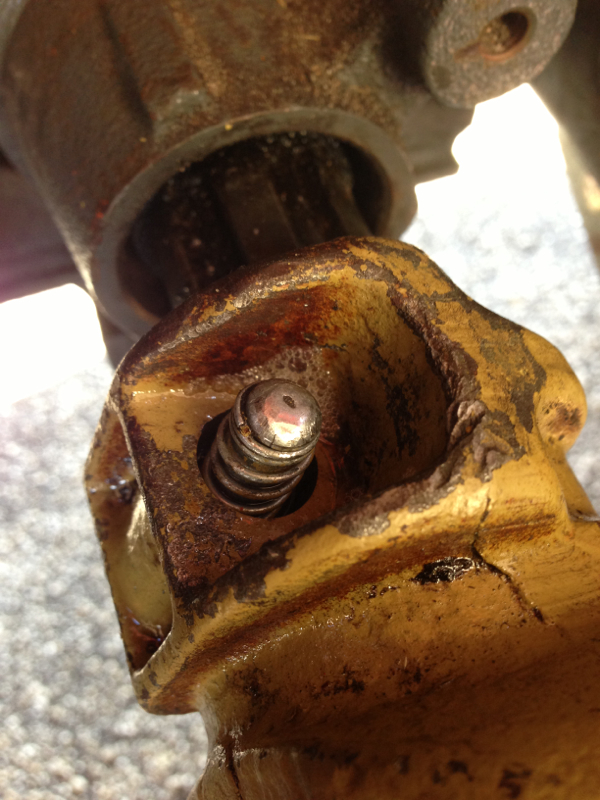

I now have photos. Still no budging.

Pin stuck in down

It looks pretty standard.
Clean, not rusty.
Likely the reason the C Clamp didn't work is that the pin has to be pushed all the way through. So, a clamp just holds it in place, unless you make a custom clamp with a hole in the bottom or figure out how to get the clamp on so it doesn't hinder the pin movement.
That is a pretty big hammer.
You've obviously whacked it a few times as the dents are obvious.
The spring, of course, is designed to pop the pin back out, so normally you would hold it in as you remove the shaft. So, the hammer should just be used to loosen it, then one would normally hold the pin down with one's thumb. I.E. You don't pound it in like a nail.
I'm not sure what would happen if you bend the pin, but it would certainly be a pain.
As you TAP it with a much smaller hammer than you have, you don't feel anything move on the other side?
