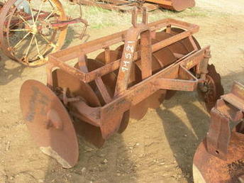

I recently saw a Dearborn Disc plow that looked to be the front section of a disc but it was purpose built for a single pass plow. I have an old part of an old Oliver I think that was a 3 or 4 bottom that someone cut down to a 2 bottom. They screwed up the 3pt and its kinda cobbled and even rough on our 4000 Ford at work. Im thinking about making a mid mount disc breaker for my Cub out of one disk and bearing and then use the other one for the cutting wheel on my terracing machine Im building. Im posting a picture of the one waydisc plow Id like to find a large gang off a big tandem disk to make one.

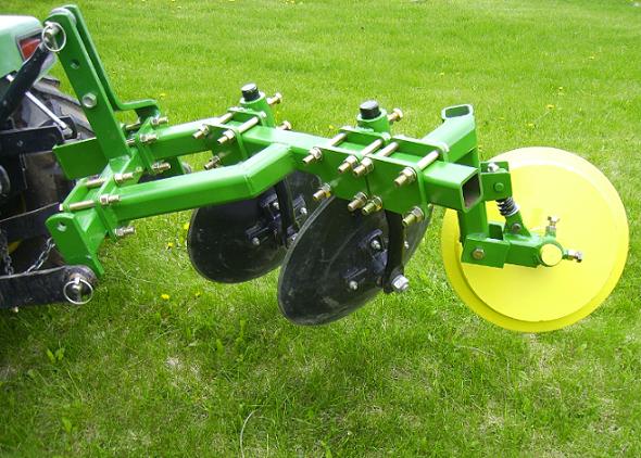

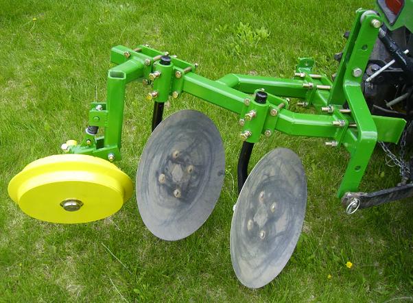

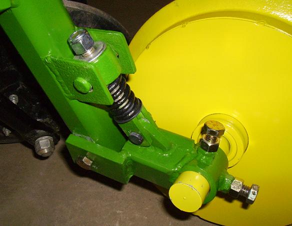

I built one for my garden tractor for plow days:

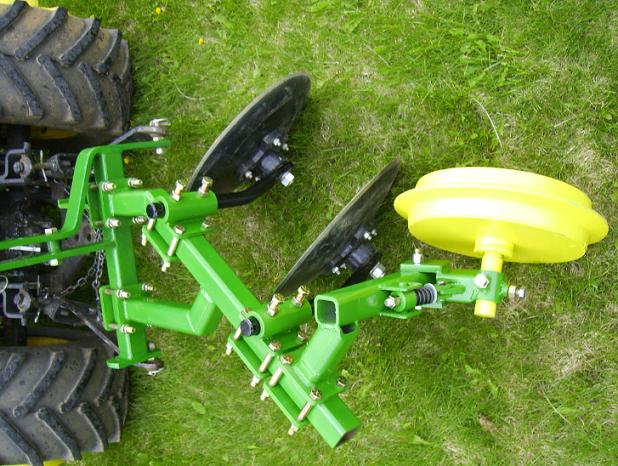

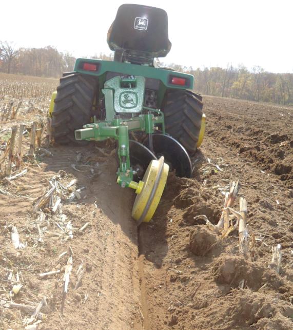

/ Disc plows #17
In action:
Care to share some details ?
e.g. disc size, angles of... whatever, probably axis to furrow and tilt/tip to horizontal ?
disc spacing ?
Then frame material, which LOOKS like 2 x 2 square tube.
and what tractor ? (weight of) is pulling it through what sort of soil ? & how fast ?
It IS interesting, thanks for the pics.
