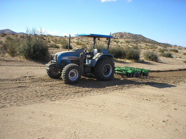

There are so many variables that without actually seeing where a person will be disking and what they want to use to do the disking, all any of us can do is give advice based on our own experience. This is a situation where it is very easy to give the wrong advise. Every year we read what size disks people pull. Often I would say that what is said is unbelievable. Don't get me wrong, I don't think anyone is lying, just that their very different circumstances allow them to do so and very seldom do those same conditions exist elsewhere.
What I think is odd, is that here on TBN where pictures are a HUGE thing, very seldom do we see any disking pictures.
