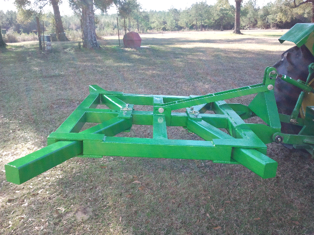

This is the final post I plan to make on this thread. Thanks for all of the input, advice and suggestions along the way. I am very satisfied with the end results of this project. I spent a little more than I planned to, but in the end believe the numbers work out to be around half of what a comparable new disc harrow would run. Here are a few pictures of before and after. I took one of the bottom to show how close it is with the 20" blades and how 22" blades may have been too tight. I think they would have cleared, but not by much.
Thanks again for all the help.

Great job on the rebuild should be good for many years and suspect it is better than new.:thumbsup:
Please let us know how it works on your fields, how many passes it take to work it up?
I would suggest bushings over the lower pins to reduce slop and wear.

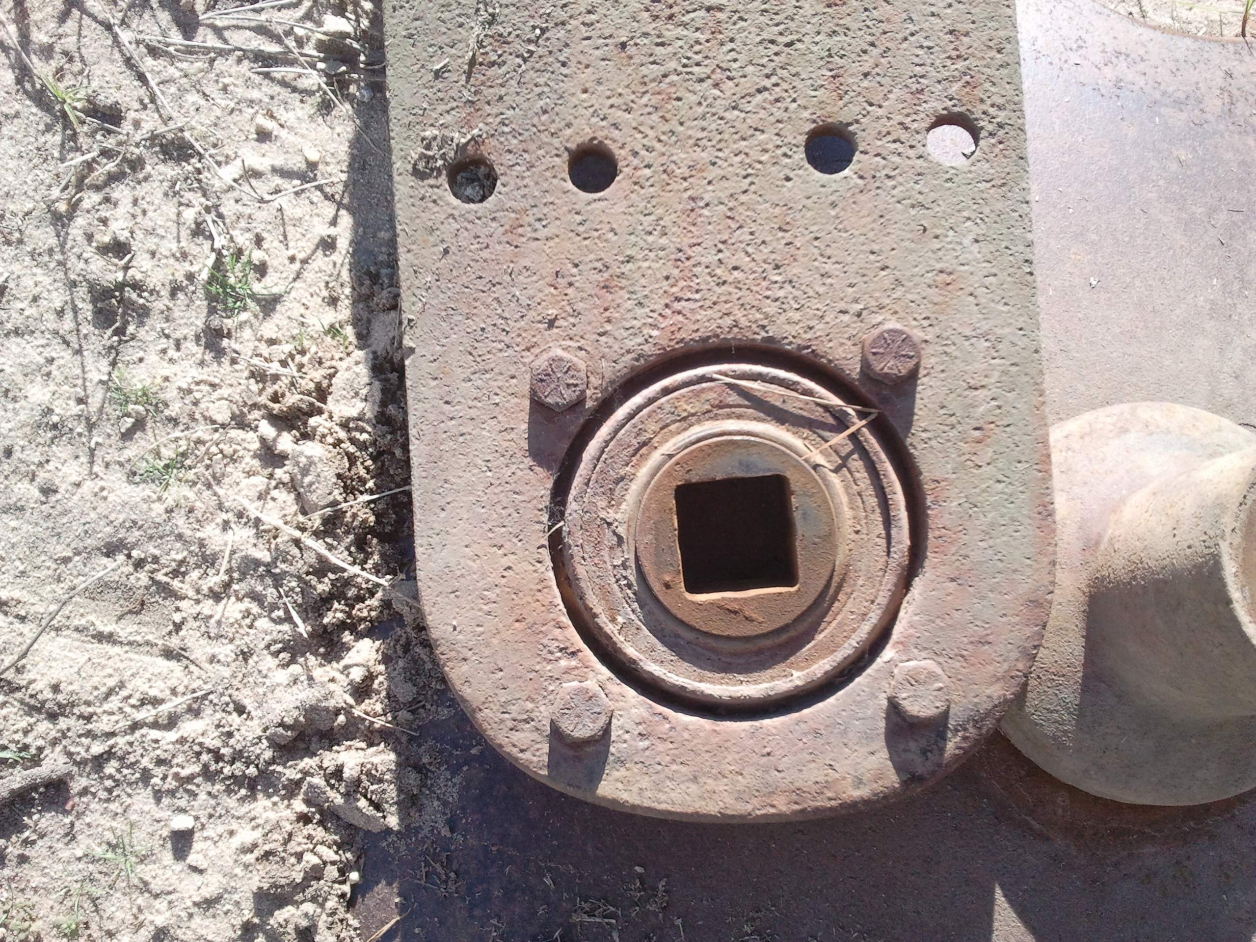

Have had opportunity past few weeks to do a good bit of disking. Last weekend while on my last location for the day after four or so hours of disking I noticed my front left blade had come off. After checking closer I noticed the threads on the end of the axle were damaged. Re-cut the threads and reassembled with impact wrench again. Turned under about an acre, checked again and still tight so I folded over the tab.
Did about another four hours or today and noticed it was loose again. Any suggestions?

........Did about another four hours or today and noticed it was loose again. Any suggestions
Clean the threads and apply some medium strength (or high strength...just have to heat to remove in the future) Loctite and tighten it up again. I have a suspicion your lock tab is moving.
/ Disc Harrow Alterations #90
I agree. The tab lock you have is too soft and not holding on the big hex. Also, I suspect looking at it, someone made it and it is too thin. If too thin, it will act as if too soft and move to allow rotation.

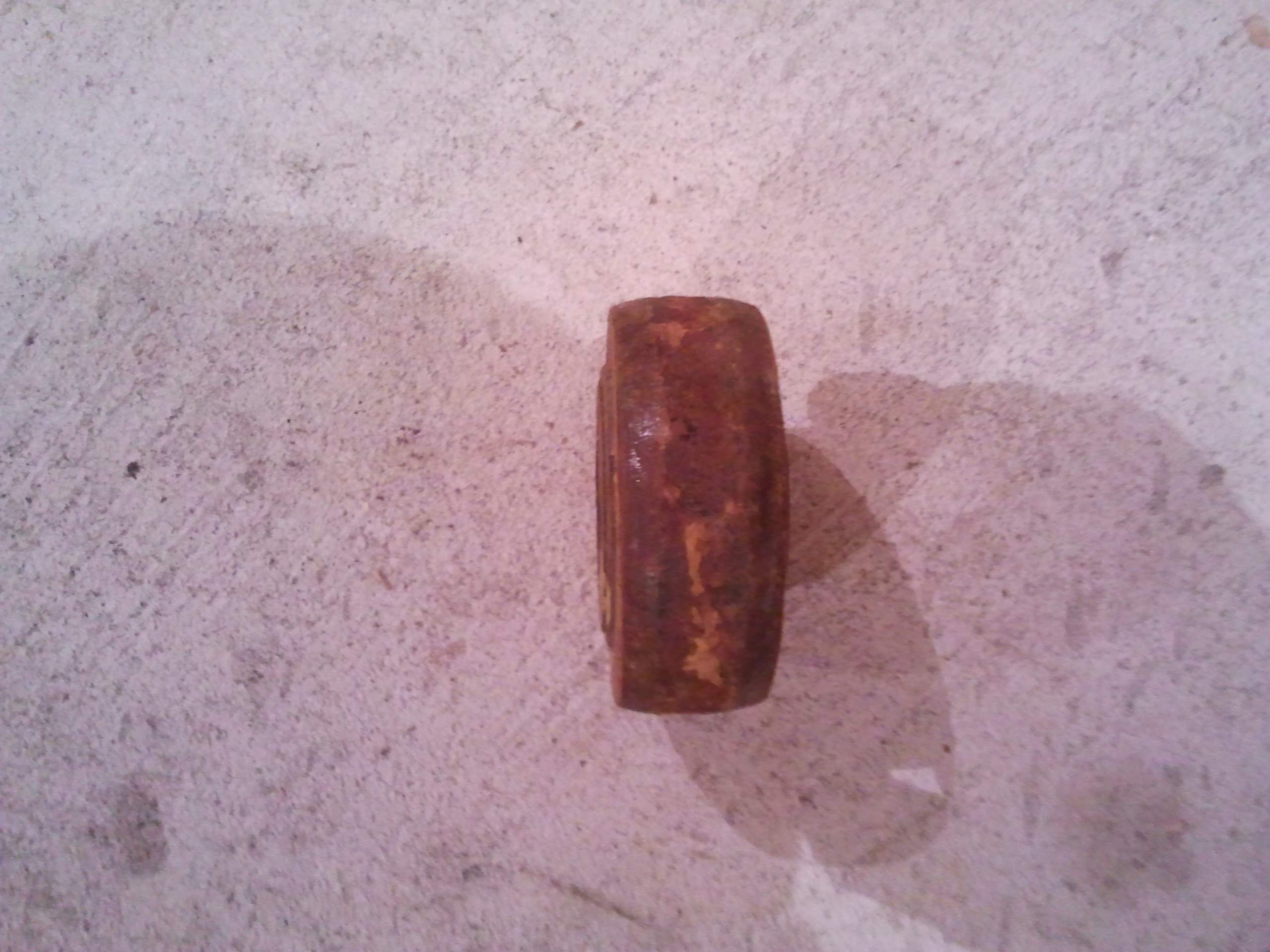

Hope to get it taken back down this week and work on it again. I thought about the Loctite and wondered if it would work as stated. I do not have a lot of experience working with it. The tabs were purchased from a local tractor dealership. The hole in the center of the tab is round so it spins around on the axle. The collar behind it doesn't seem to be locking down squarely on the axle and may be the culprit too. I picked up a new spare collar yesterday while in town. May try substituting it to see if that helps. I would question if I was doing something wrong on this axle, but it is consistent with what I have done on the other three axles that have not had any issues.

The lock tab usually has an internal tab too that engages a keyway in the axle. I think if that were mine I'd snug it up and drill and pin right through the nut, shaft and all. Better yet, get you a castle nut and just drill the axle and pin it.

What about something like this. It uses the axle to hold it without spinning
1-1/8 Lock Plate For Disc Axle
Had one similiar on. You can see it in the pictures in previous post. Makes me wonder if collar is not going onto the shaft where the two square pieces would join preventing the spinning. Picked up another one to replace a spare one had. The new one looks just like the one in the link. May give it a try and try it one more time. The Castle Nut idea seemed sensible.
