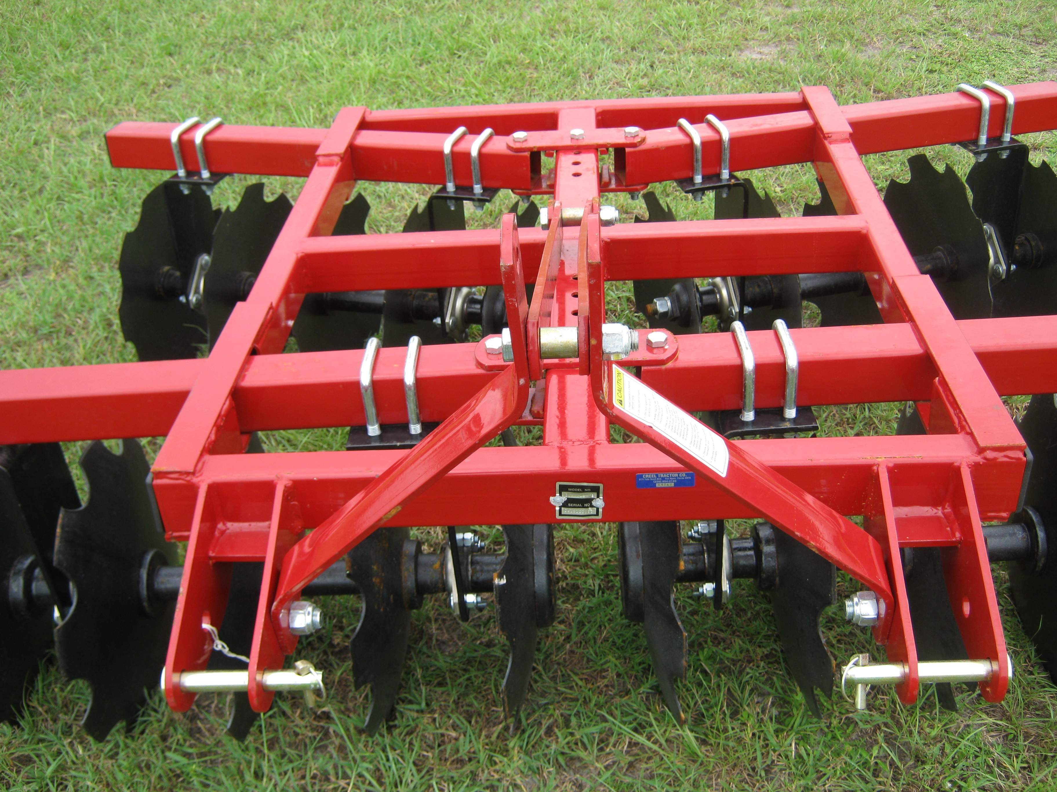

Pics when new before use.
BTW: I'am just a food plotter.

Of the 22 total blades, the measured size ranged from a full 20" down to 17". Some were rusted so bad that the cutting edges were jagged. I wanted to go back with 22" blades, but am too concerned about the clearance between the bigger blades and the bottom of the frame. It may fit, but one location looked to be too close for comfort. I am unsure of the origin of the current blades.
It appears from the picture that you have a Howse brand disc. They are built approximately 30 miles north of me. I strongly considered the Howse disc before finding the one I purchased. This disc has a 4" square tubing frame with the 1 1/8" axles. In comparing a similiar new unit price to what I will have in this one, I am still coming out somewhere around half the new price. I will have enough in it though that I could have bought a new 6' disc of a little lighter weight.

Of the 22 total blades, the measured size ranged from a full 20" down to 17". Some were rusted so bad that the cutting edges were jagged. I wanted to go back with 22" blades, but am too concerned about the clearance between the bigger blades and the bottom of the frame. It may fit, but one location looked to be too close for comfort. I am unsure of the origin of the current blades.It appears from the picture that you have a Howse brand disc. They are built approximately 30 miles north of me. I strongly considered the Howse disc before finding the one I purchased. This disc has a 4" square tubing frame with the 1 1/8" axles. In comparing a similiar new unit price to what I will have in this one, I am still coming out somewhere around half the new price. I will have enough in it though that I could have bought a new 6' disc of a little lighter weight.
You are correct,that is a Howse DH. Sent you some info off my Howse owners manual might be able to help you in/on your project.
