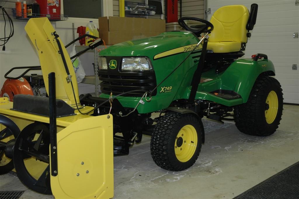

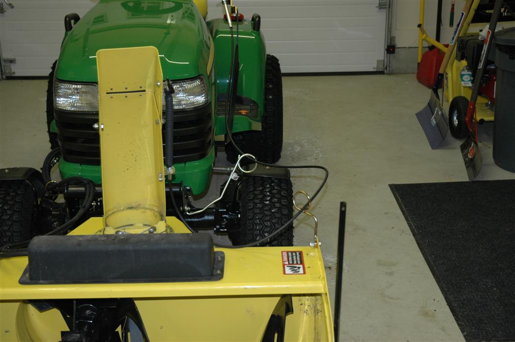

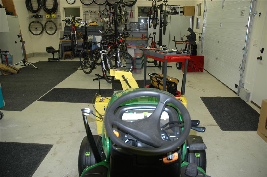

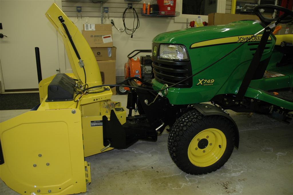

You are correct ; they have one length cable (too long)for all applications. Here are some pictures of how I routed the cable on my x749 to get the chute to work smoothly.

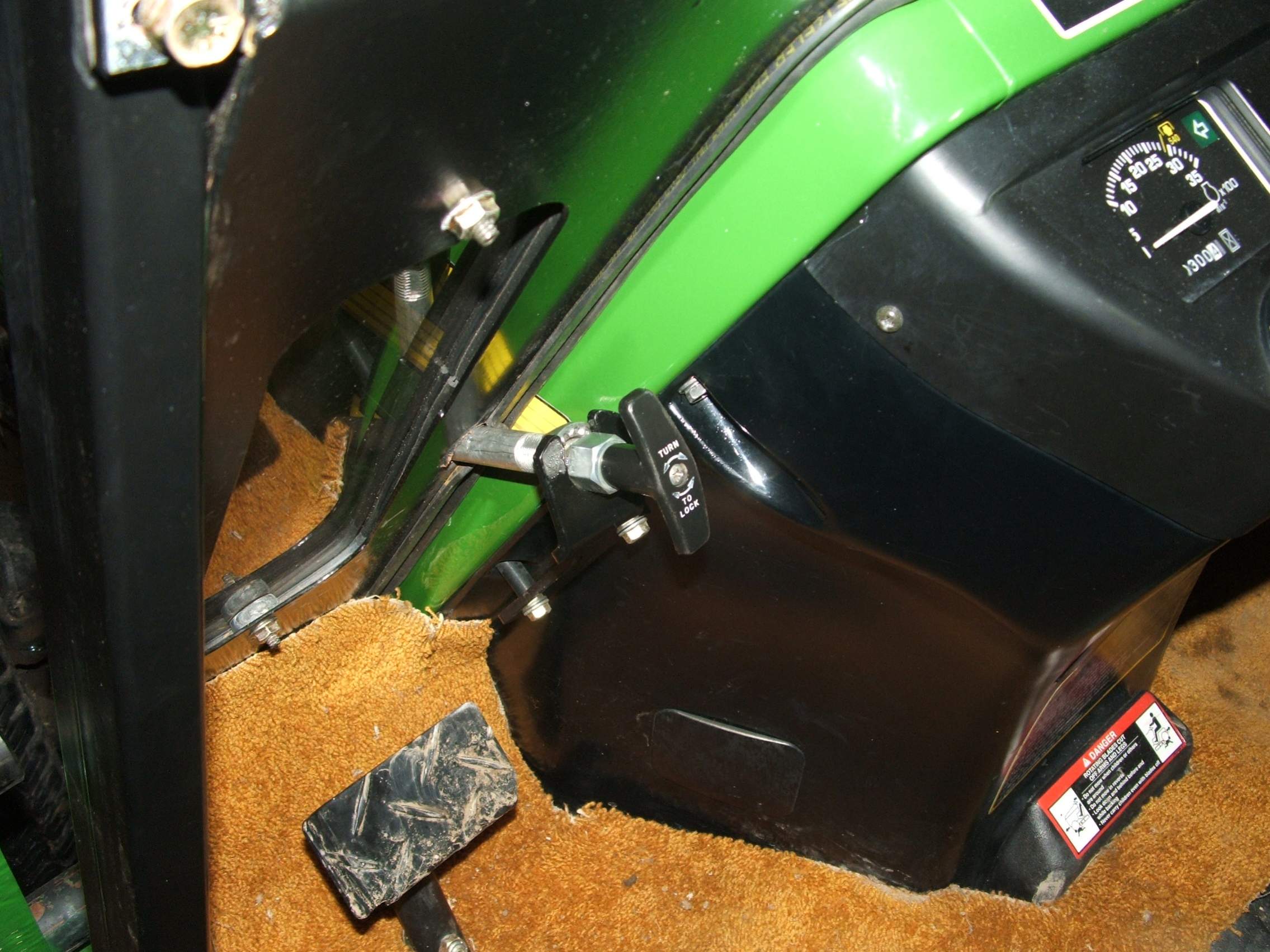

My Simplicity has the mount on the side of the dash.
Does your handle have to turn a quarter way to lock and unlock? Is yours spring controled to spring open?
Hey! I like your routing job. I'm going to try something like that with mine. Do you remember where you got the extra mounting loops? I could use that short one that you have mounted on the blower housing.

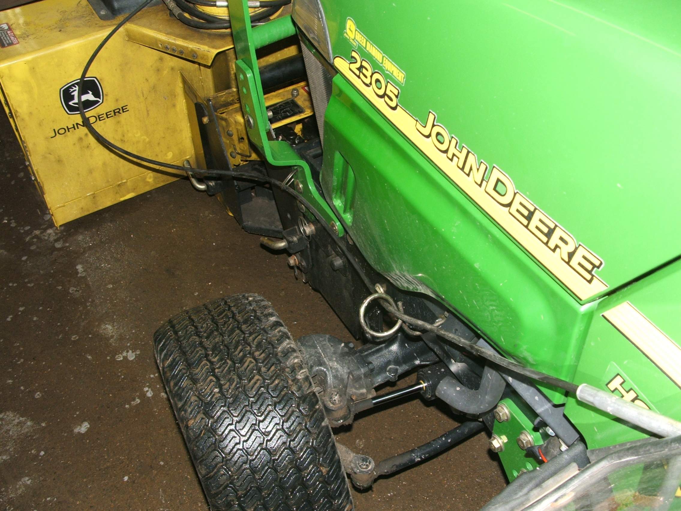

Well their is a simple solution, buy a cab. No but seriously, I have to agree with you, it is kind of flimsy. The dash mount on my 2305 makes it nice and solid, and definitely not hard to operate. Having the control is like day and night. Here a few pictures, you can see where I have routed my cable, particularly in the bottom ring. Either way I suspect that by January you will be looking for a cab. :laughing: DSCF6666.jpgDSCF6668.jpg
Looks good, but I wonder how the cable going to react with the spout turn all the way to the left. Nice setup.
A cab is not an option for me as it will not fit in my storage shed. Your cable routing is pretty much the way JD recommends in the instructions. It doesn't work too well on the 2720 as it causes the cable to pass directly over the exhaust opening just behind where the front ring is. Others have reported problems with the exhaust melting the plastic jacket which is why I chose an alternate routing from the get-go.

Got-it, now I see where the exhaust is coming out. :eek:
I went down to my local dealer and sifted through some stuff he had on the shelf. Sorry but I didn't keep a record of the part #.
