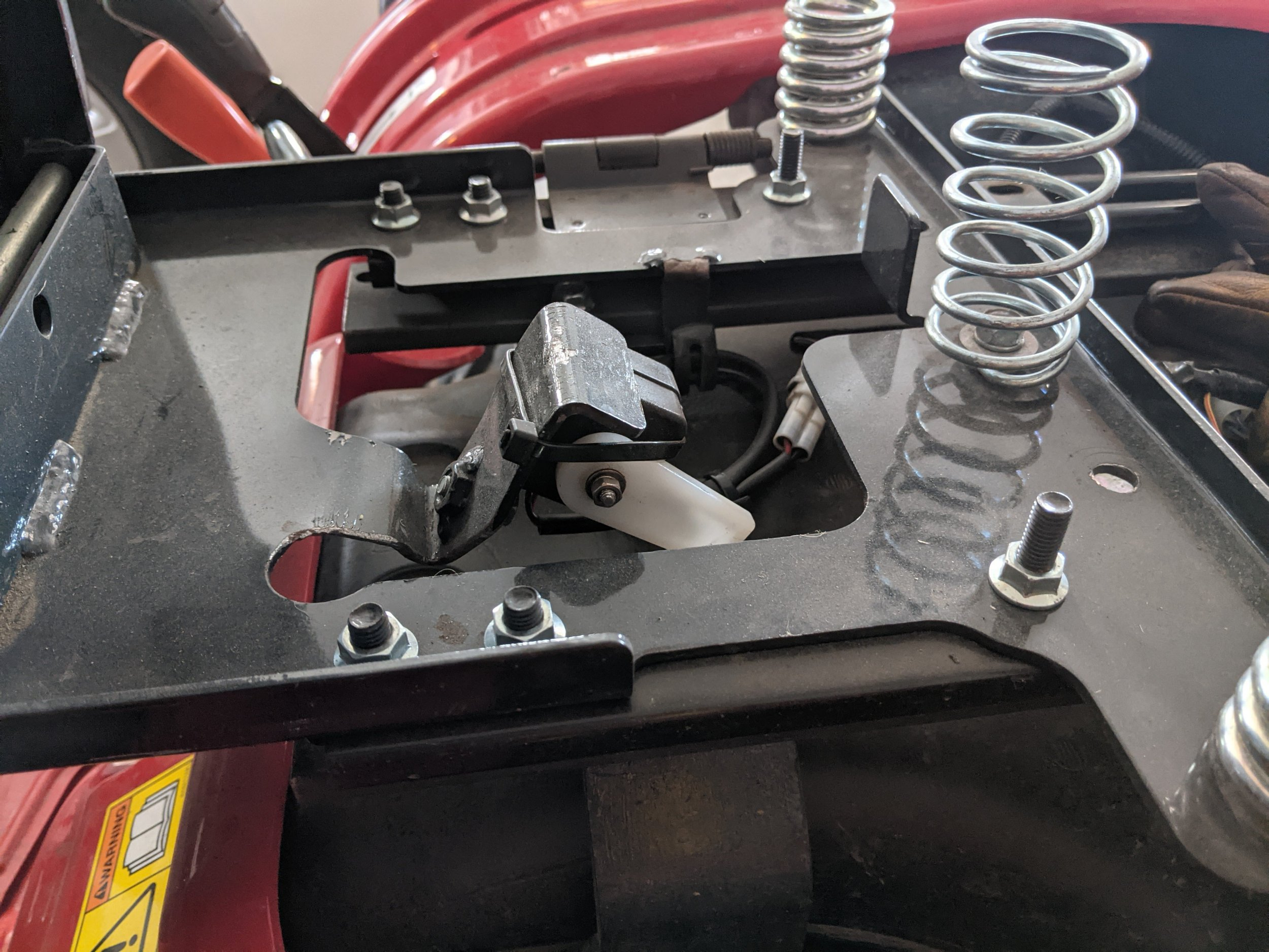

Yes I've done a search and seen some ideas, but would like up-to-date input....
My new tractor is wonderful, but the only big PITA is having it shut off every time I need to jump out and grab or move something.
I understand the inherent dangers of rolling over/falling out etc, but that would be unlikely on my flat acreage.
I just jumpered my riding tractor a while back with no issues, should I do the same on my new Kioti? Thoughts?

In neutral, with the pto off the seat switch kills the engine? I do not favor the idea of disabling seat presence switches. Too many of us forget that the pto is live or tractor in gear until after the accident happens. Loose fitting clothing and pto stuff is not a combo either.

On the seat switch just unplug them from the switch and plug them into each other. The PTO has it's own safety switch and that's the only one I left operational.

I had to disable the seat safety switch on my MF1540. Seat was frozen and could not detect any weight in the seat, so couldn't use it to blow snow. Dealer told me how to disable it. I only hook it up if I let the neighbor use it to mow his field.

Kubota makes it easy. Just unplug the bullet connectors at the switch and plug them together to disable. I was going to put a toggle switch on the dash, but then wondered when and why would I want the seat switch to be active? Well....probably never.....
