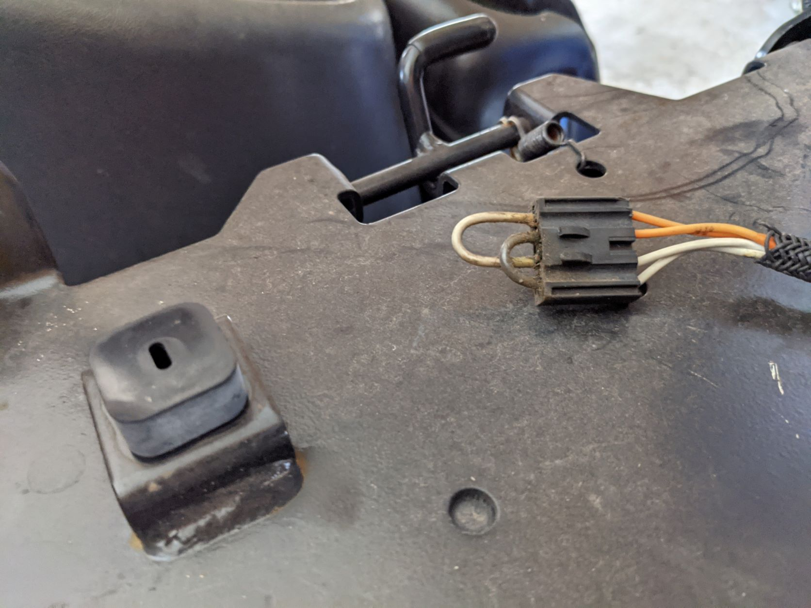

   / Disable tractor seat shut-off? #30
We got along with the seat switch for about the first year after we got our JD 4600, even though we found it annoying, but then it started shutting off the tractor every time I went over a bump. Since our other tractors, one from the late 60's and the other from the early 50's, never had such a thing, and we'd learned long ago how to deal with that, I just made a jumper to bypass it. No issues since then.
