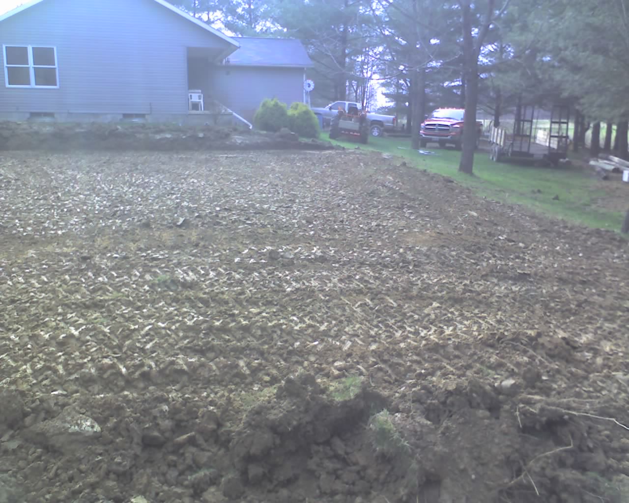

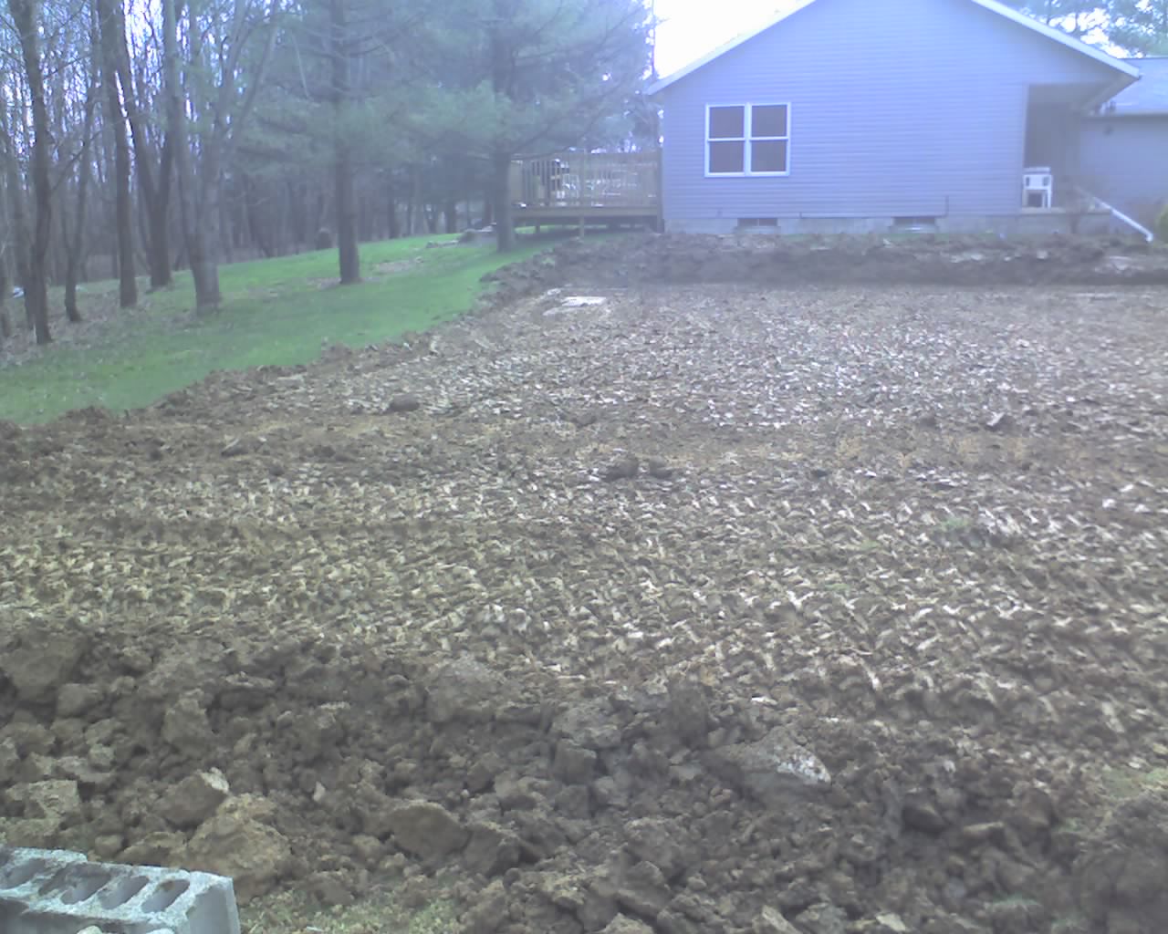

Thanks for all the good info! I will be leaving the pad a compacted lime stone sand base. With concrete going for $125 a yard my budget will not allow that. The limestone sand, we have around here compacts down very hard even under wet conditions. I use a sand floor in my barns and I have found them to work very well. I am planing on putting gutters on the building to channel water away. I hope to start on leveling the pad in the next few weeks if the weather holds. But with that being said I am excepting some very cold temps, so the ground may freeze up and stay that way for awhile.

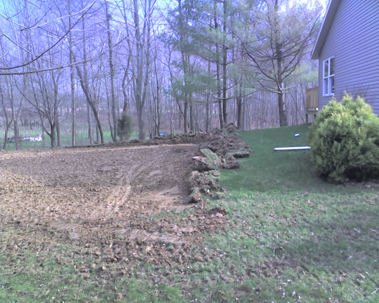

I very big thank you to all the input on this. I talked with a contractor friend of mine. He came out and shot some elevations on the pad site. He told me we will need to remove about 5 feet of dirt front the back section of the pad and add 2 feet to the front. We are going to be a tag team, I am going to clear the area of light brush and debris left around. Then he is going to loosen up the dirt with his excavator while I move it. He will use his track dozier to finish grade the area and move the 3 ton rock at the edge of the pad. I was not going to move it but since he is digging down so much we got to move it. Thanks again for all your help!!!!

An update, I got a box blade from Tractor Supply 6' and I love it was able to do about 85% of the grading with it and my FEL. I was able to do so much that my contractor knocked $500 off the price to do the finish grading! I love this blade it is built like a tank! Now the building is up and I got some place to work on my tractor! Thank again to all for all your advise!!
