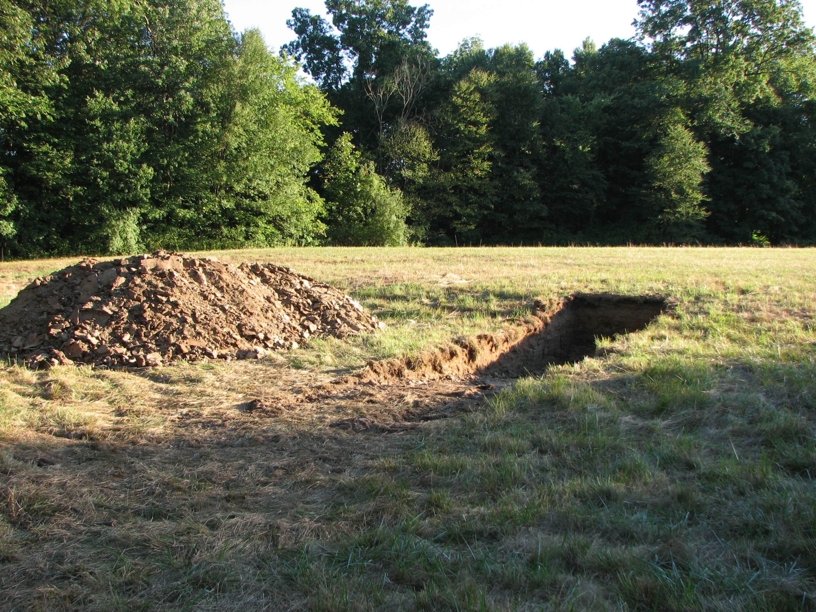

I don't know how much digging you need to do, but I used my fel to dig a 100 foot ditch in an afternoon.
Basically I rocked the fel back and forth on an angle (kinda like texasjohns pic) until I got under the grass/weeds. then I took off the top layer. then I went back to area and just dug it out. took a rock back and forth sometimes to get started but once it was in it would cut through the soil okay.
The soil was mostly silt though. so ...

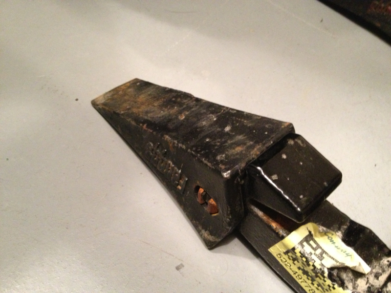

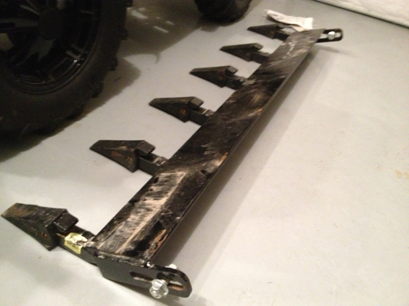

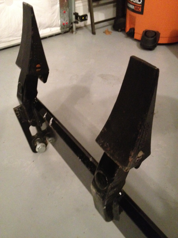

use a toothbar but expect to move 10x more dirt than using a backhoe/excavator.
More more dirt than an excavator? Huh? Same size excavator as tractor with toothbar should outdig tractor at least 5X-10X. Problem with excavator is you need dump truck or trailer to haul away spoils.
PS my L39 with HD toothbar bucket digs well, but it is no excavator.
Toothbar for a bolt on Try Long.
