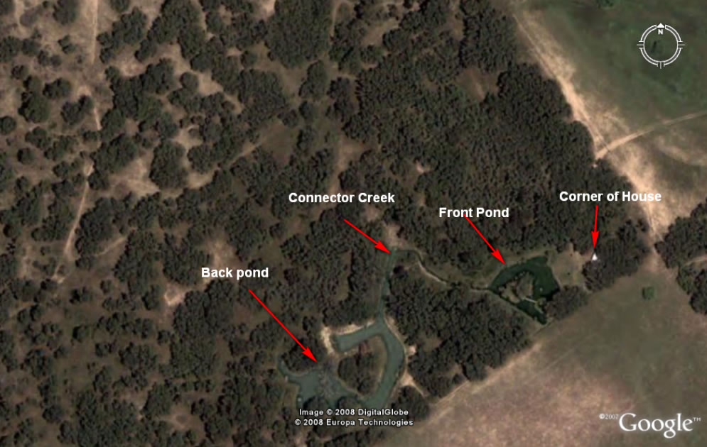

Wushaw,
Do you have post oak or live oak in your area? I have included a Google Earth shot of my property. All the water ponds and creeks were man made. It has taken me a number of years. I think you can see my dilemma with all the oak trees and how heavily forested the land is. As you can imagine, it is a wildlife hot spot. I have left many submerged stumps for fish cover. This pond is loaded with fish but attempting to maintain the depth of the pond with all the foilage falling into the water and building up muck on the bottom, is a major problem. I have the ability to pump water from one section of water to another by placing sand bags in certain areas and draining the area. This is where I think a tractor will come in handy scooping out the muck after it dries.
