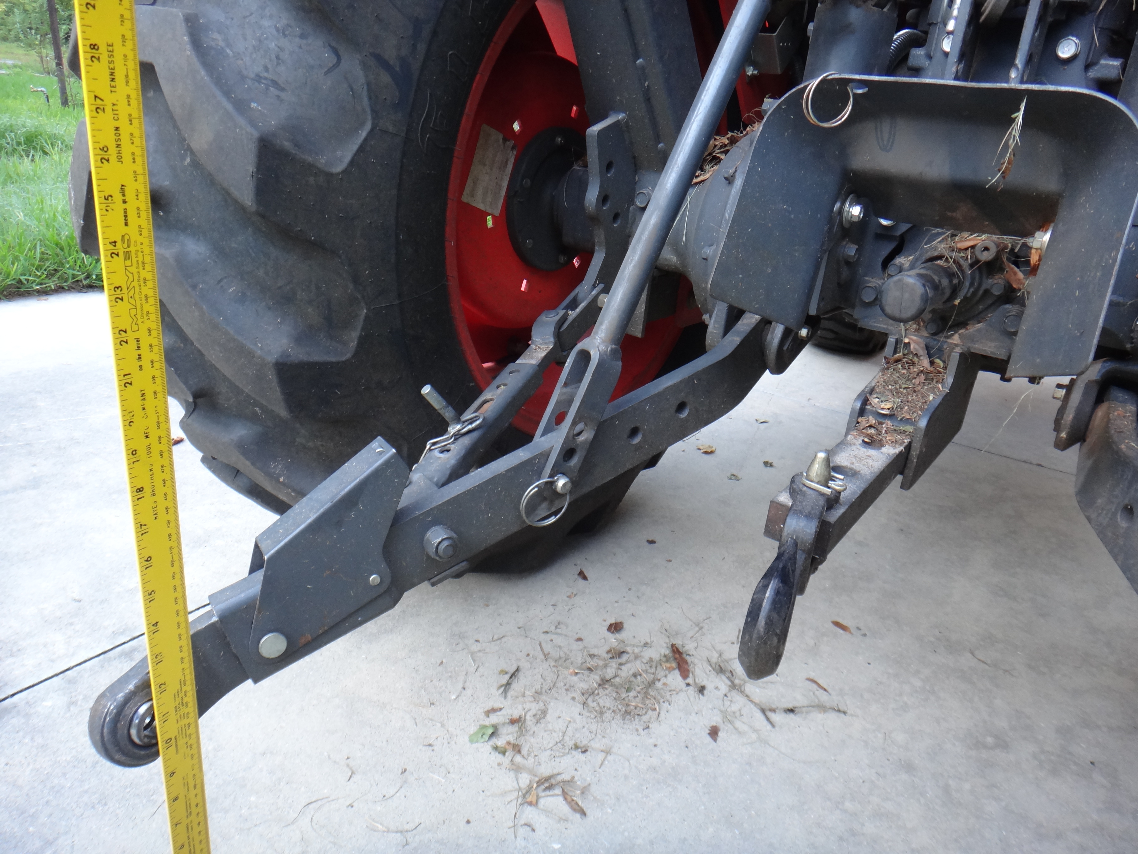

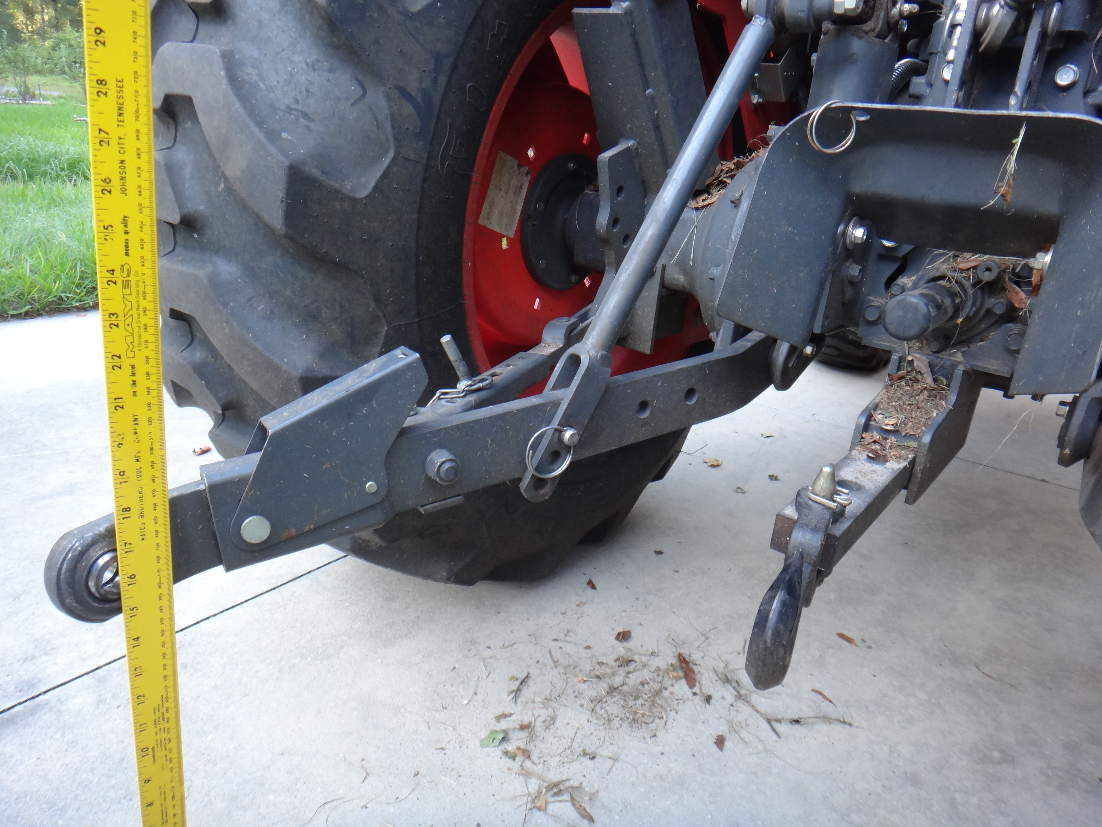

If you want deeper soil penetration with Middlebuster or Subsoiler move pin to bottom holes on Lifting Rod stirrups. See photos.

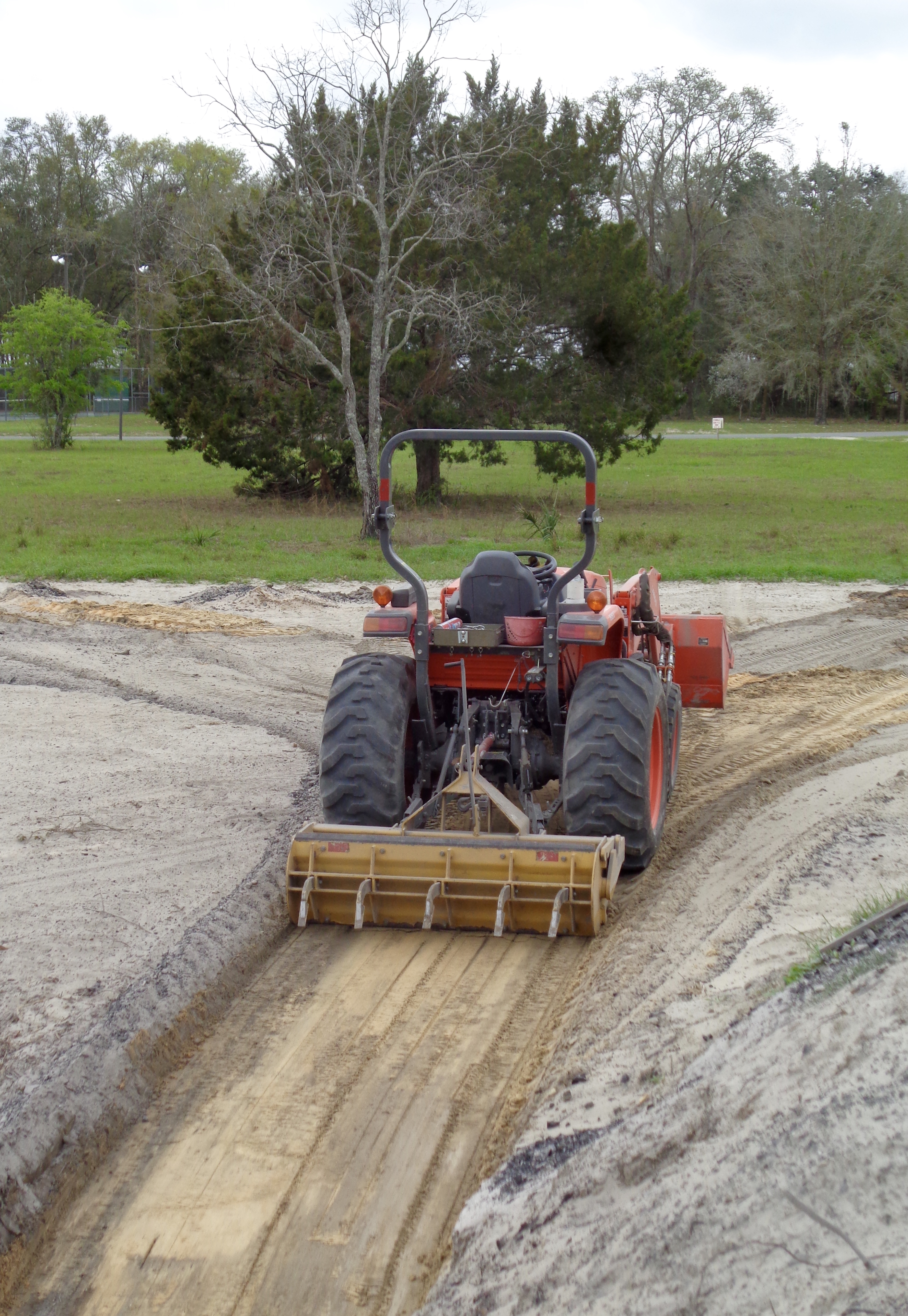

I never thought of using a box blade. I thought it odd so many people own one. We never used one on the family dairy farm.
Many compact tractor owner using implements as Three Point Hitch counterbalance choose Box Blades.
Box Blades do not cut acceptably, at least for me, until weight is at least 100 pounds per foot of width. My Box Blade is 125 pounds per foot of width. Construction Box Blades are 200 pounds per foot of width or more.
Box Blades of at least 100 pounds per foot of width, and widths of 48", 60", 72" have reasonable weight for counterbalance to general FEL work. One hundred twenty to 150 pounds per foot of width is desirable for counterbalance to HEAVY FEL loads.

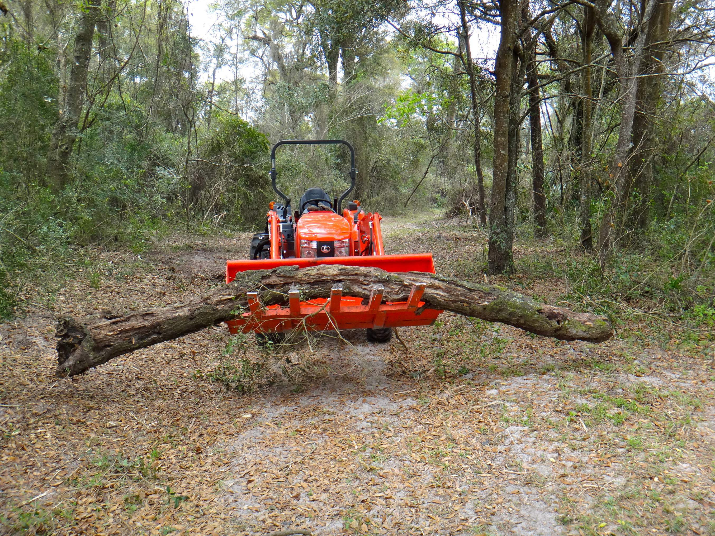

Photos 2,3: The sopping wet Water Oak weighed around 1,400 pounds. My Rollover Box Blade weighs 630 pounds.
Tractor's rear wheels were very lightly in ground contact. I should have had a heavier implement on the Three Point Hitch.
