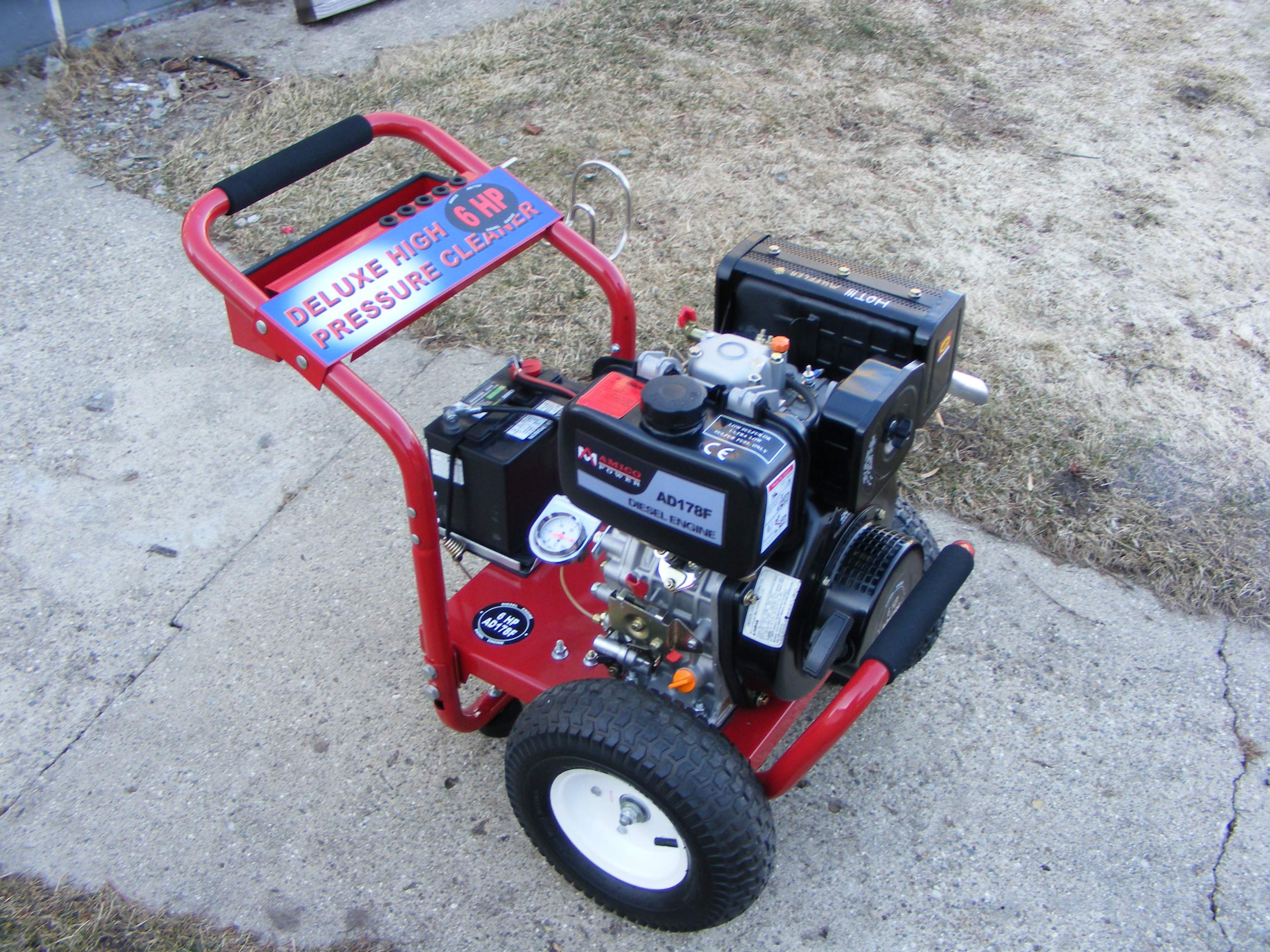

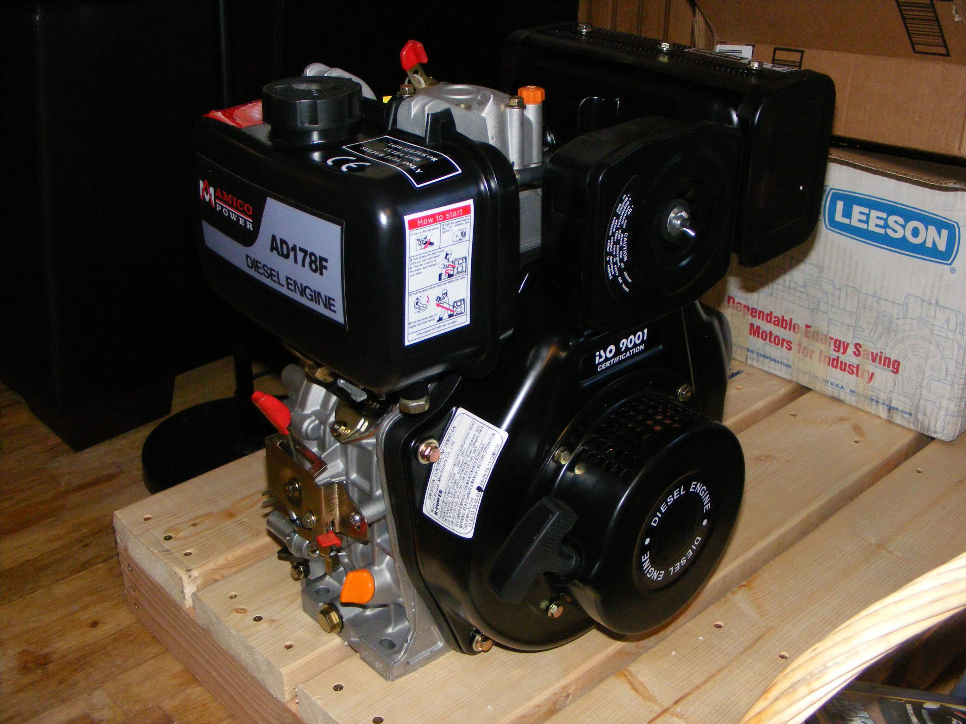

I just built a 6 hp 178F diesel 3000psi pressure washer. After breaking in engine with 10w30 diesel oil, I now run Delo 400LE 15w40.Engine is a Amico 6 hp 178F diesel. Engine barely lugs when pressure washing , and running constent for 2 hrs only uses 1/2 gallon of diesel fuel. This engine is easy to get parts for, I ordered a extra gasket set, fuel injector , and injector pump. I am happy with how this engine runs , and questions please ask.

nice !! how many gpm ??
/ Diesel pressure Washer #3
Does the RPM of the diesel match the gas you replaced?
/ Diesel pressure Washer #4
How much did the engine cost? Just curious...
