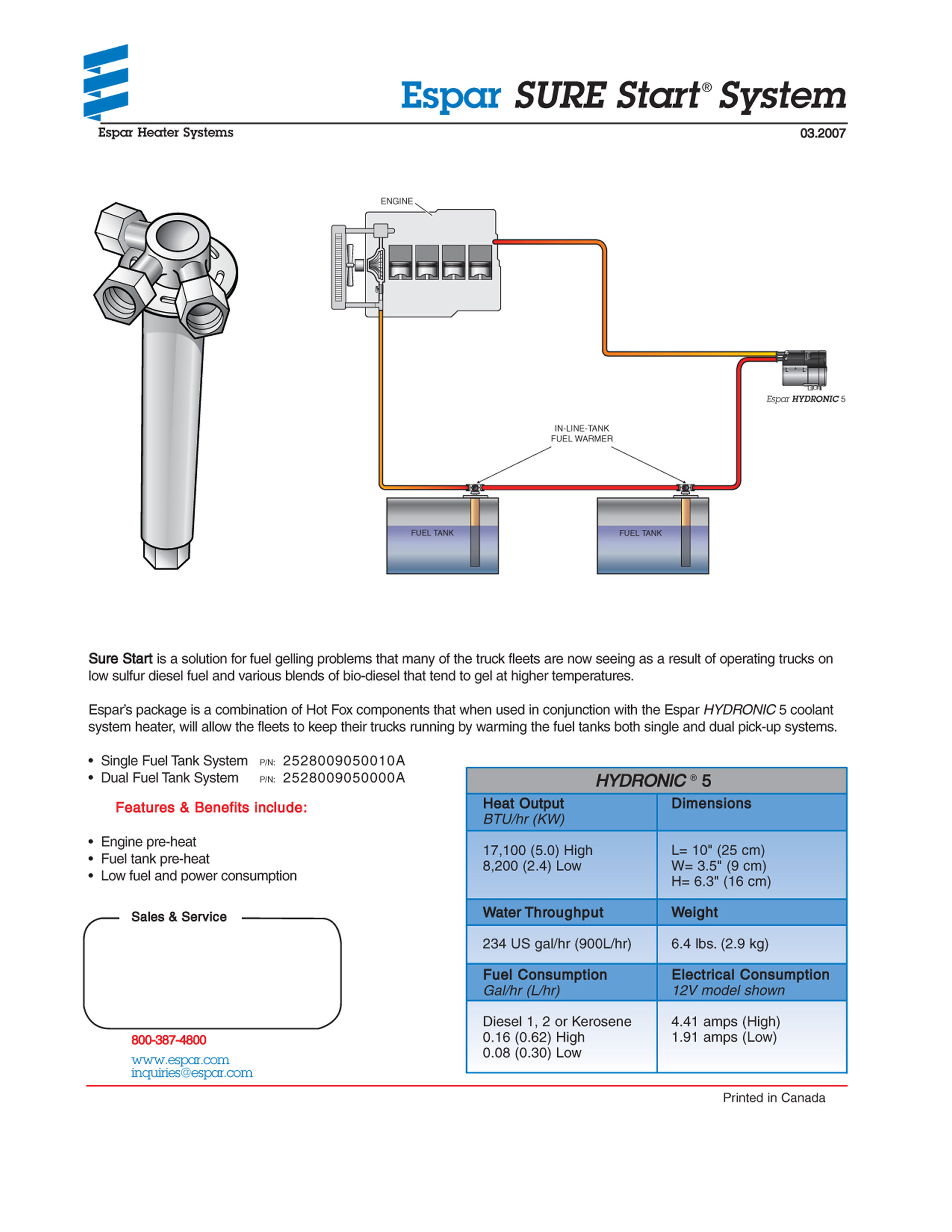

Here's another answer ...engine heater w.o. need for electricity, and warm your fuel, as well
