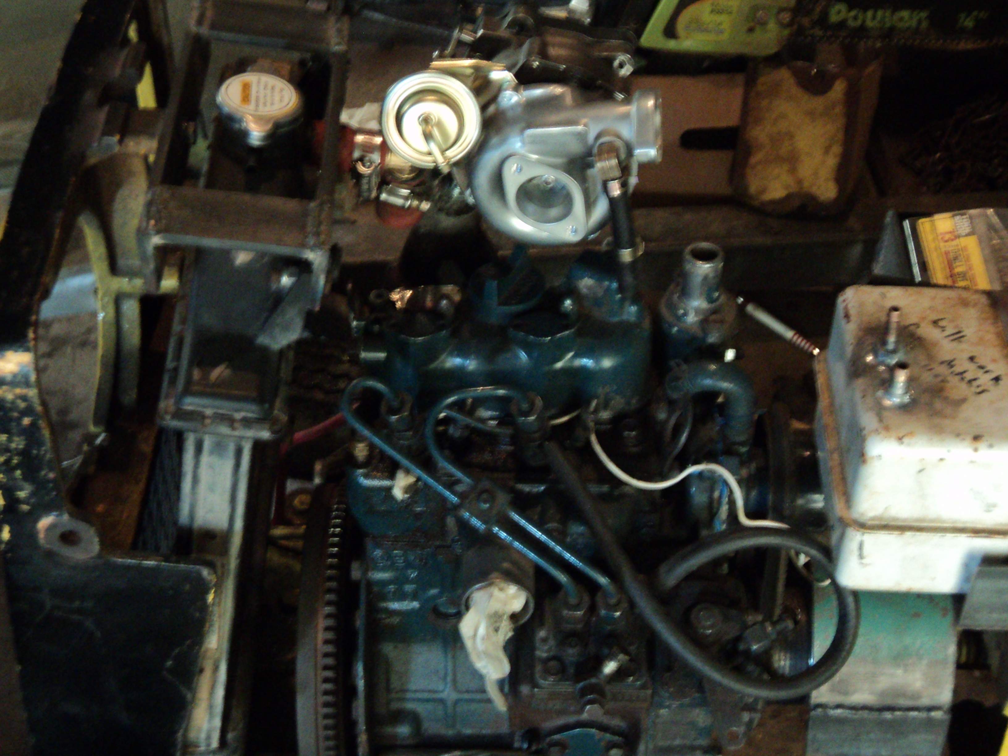

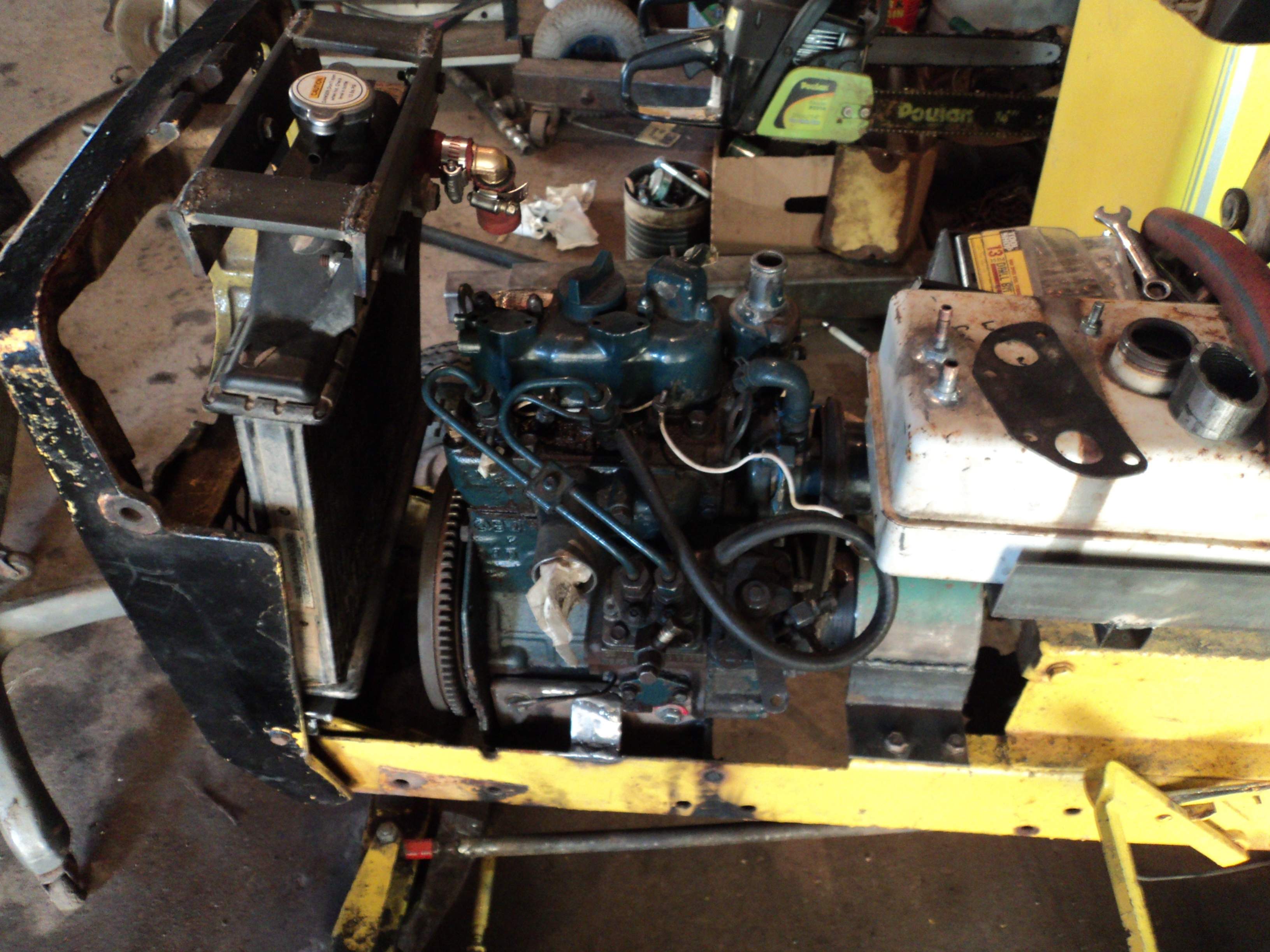

Here are a few pictures of my puller that im workin on. hope you enjoy.

i used to pull diesel pickup class and the hobby has gotten so competative and expensive i cannot afford to play anymore so since im a hardcore diesel fan i am going to build one of these tractors and return to the track i have found a d600 series kubota that i will b purchasing any tips or tricks would b gladly appreciated as far as drive line gearing performance parts for the kubota rods cams pistons etc. also bigkrank wat do u charge to build a cub rearend for a customer prolly need just a mild one to start out with but im not for certain and also how are u connecting the kubota to the cub transaxle thanks for any info one might have
