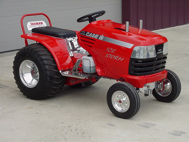

/ Diesel garden tractor pulling #27
I noticed that one of your case tractors has a Johndeere hood.
#28
Very good! Most morons stand there and say they didn't know CaseIH made a Magnum that small, and are serious. Even tried explaining to one guy how we build them from the ground up and he just didn't get that you couldn't go to a store and just buy one, he still don't get it.
im a puller to and i wanted to know how or where u get u hoods from im trying to find a case ih magnum body like urs but i don't have any luck finding one.
