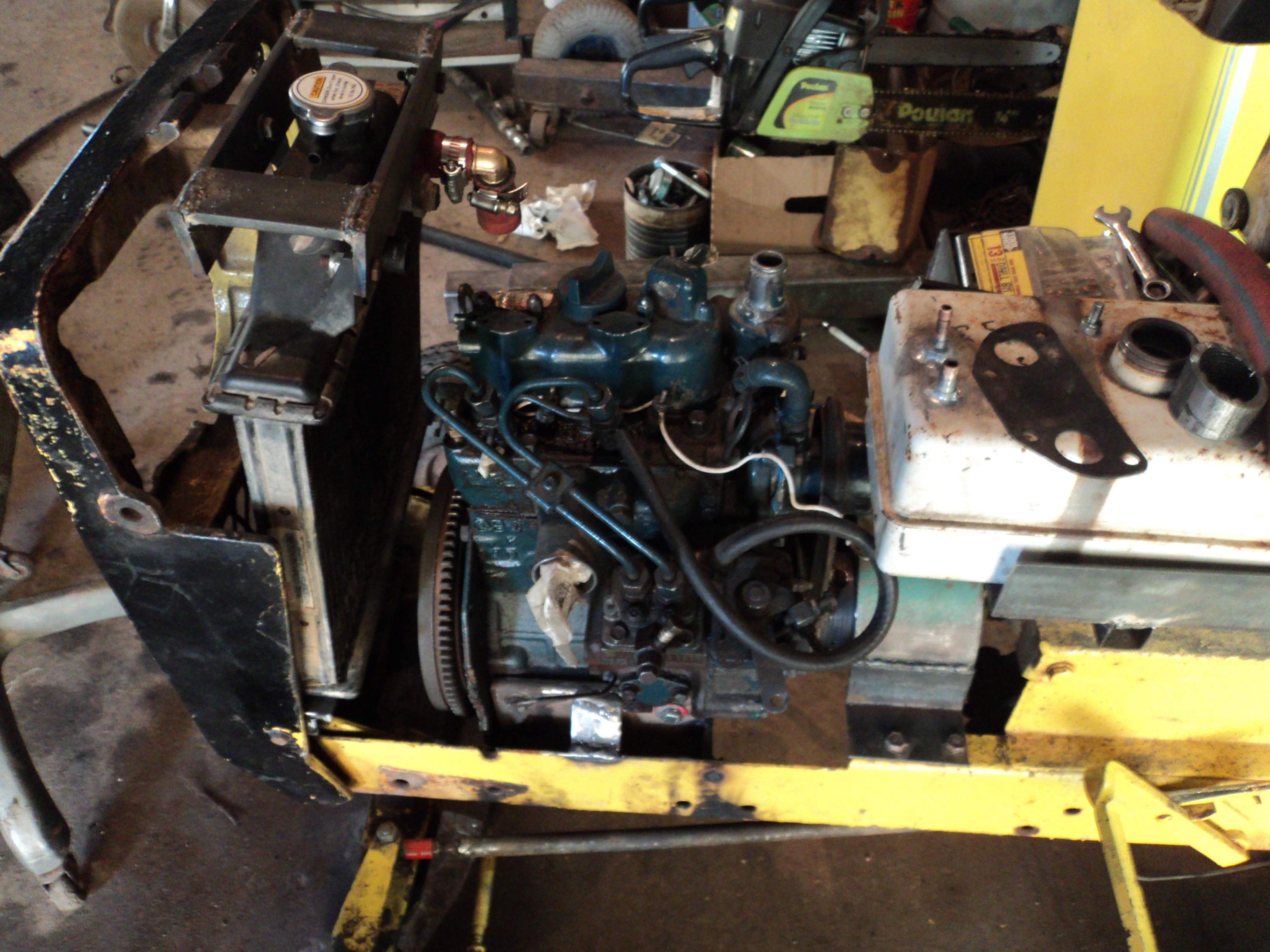

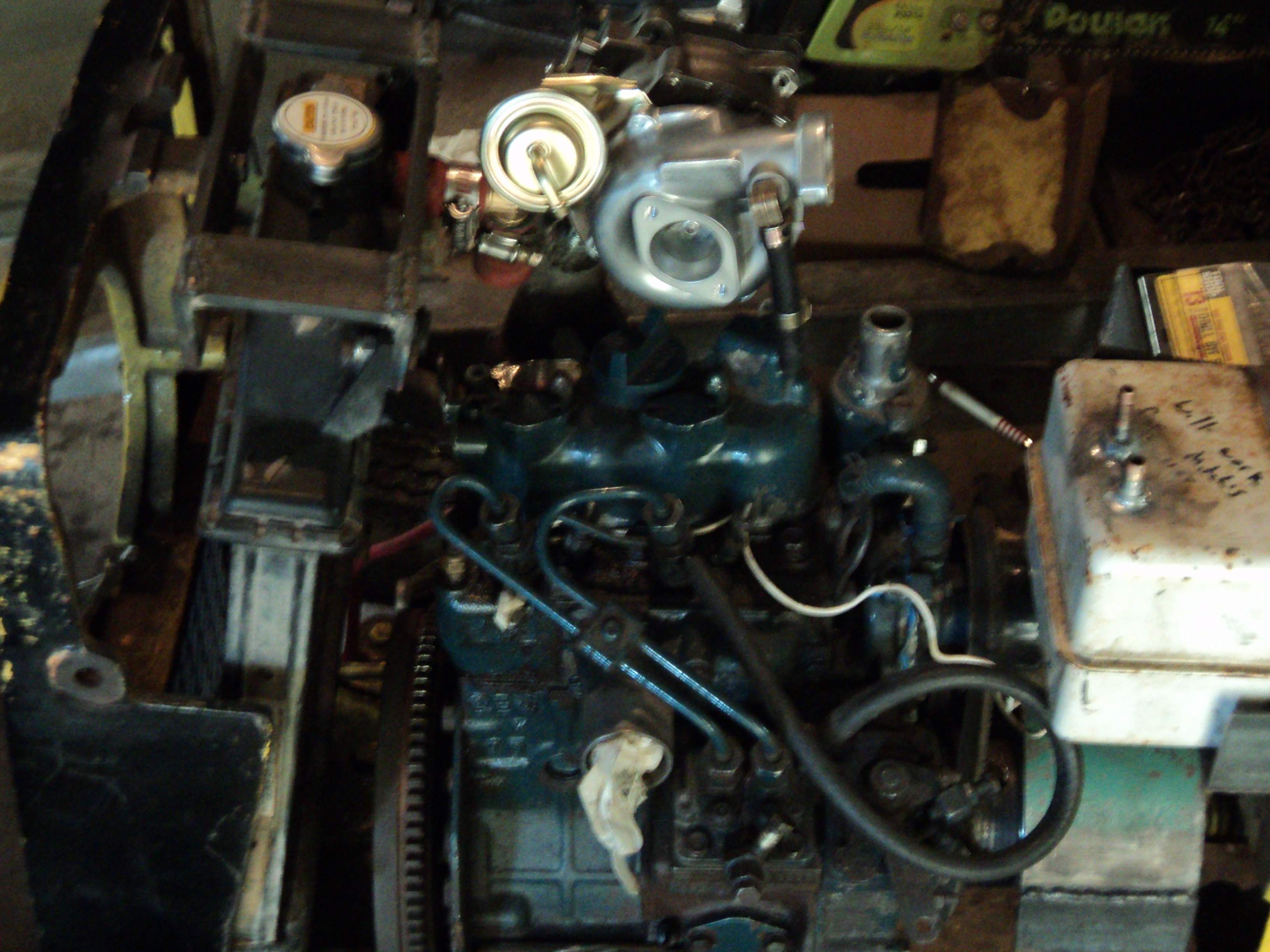

Here are a few pictures of my puller that im workin on. hope you enjoy.
