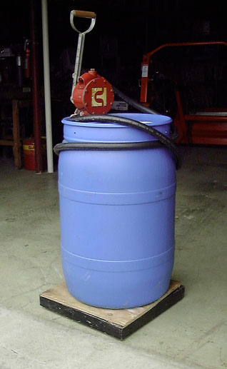

Jas5n, Here is one more to think about. I use a 35 gal. poly drum with hand pump (see attached photo) I can move this around by myself and it last about 4 months for me.

I have been wanting a set up like that for a while. I can't seem to find the drums anywhere. How do you move it around? Do you just tip it and put it into a FEL?

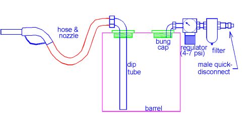

I have a 30 gal. steel drum given to me and I am almost done setting up a fueling station. In principal, I am going to pressurize the drum to 4-7 psi. I picked up an old gas nozzle and hose at a sale, but the hose seems too cracked and brittle to use. I did get all the fittings made and tried it out last week. The nozzle leaks somewhere, so I'll have to rebuild it. This will be practically a free project for me. The drum was used once and given to me, the fittings came from Home Depot- from which I received a gift card to and the nozzle and hose was a dollar. I've attached a rough sketch of what I'm doing. When I get this all done, I'll post pictures and describe the process. BTW, does anyone know if diesel fuel attacks PVC?

Dave, The black box that it is sitting on is a dolly. So I can just roll it around in the shop. When I need to lift it, I just put it into my FEL bucket and move it around. I can tip a full barrel on the edge and roll it around without to much hassle if I need to. The barrel is very stout and was a freebe from my neighbor. The pump I got from my grandfather, a leftover from the days when we owned an oil company.

This design is very dangerous without a relief valve. PVC is fine for diesel at non-elevated temps.
