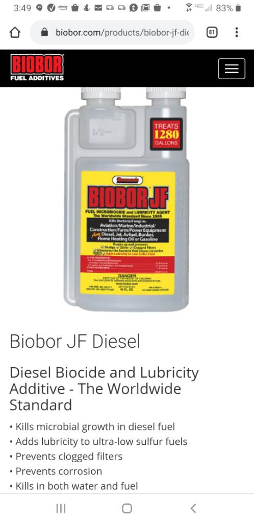

Forget about removing the tank!
It is not necessary, unless you know that you have something that is physically plugging the tank outlet, like rust or other debris.
I had a boat (was 19 years old when I sold it) with 900 gallons of diesel storage.
As I am sure you can understand, I would never have considered removing the 3 boat tanks (would have needed to cut the boat apart).
I had a fuel polishing system, and occasionally cycled the fuel through a separate set of filters.
Drain your tank, and replace with fresh fuel, adding Biobor JF to the fresh fuel.
Biobor JF will kill whatever might be growing in your tractor tank.
