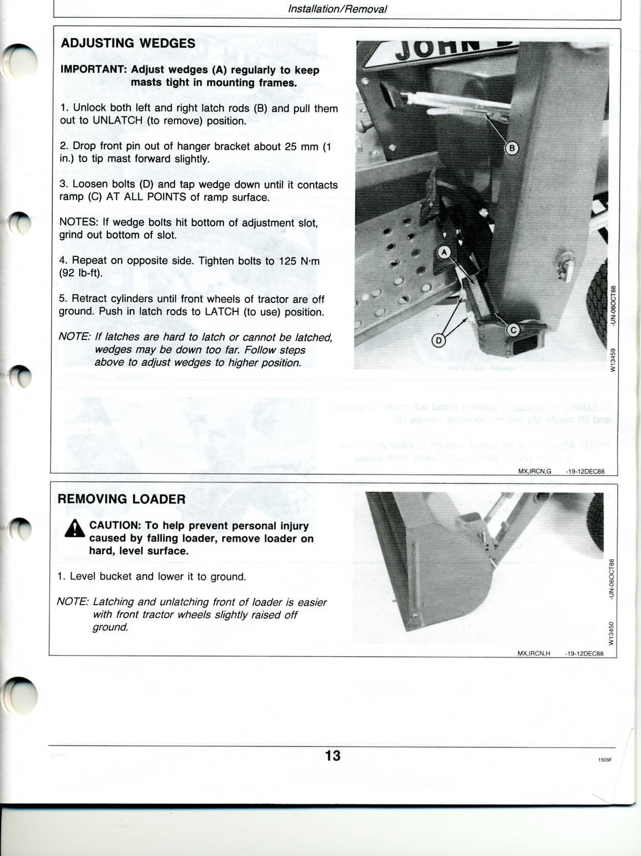

I'll wager your wedges weren't properly adjusted. Due to loader movement, they do have to be adjusted occasionally (even if the loader isn't removed and re-installed).
I'd say that might be a good wager...:thumbsup:
I see that the wedges are mounted in slotted holes. The bolts in one of the wedges are in the bottom of the slot while the other on the opposite side of the tractor are in the top of the slot. I does appear that they have moved recently.
They could have moved when the FEL gave way - or before. Anyway I need to get up and going.
I know I'll have to take them out to replace the arm back in the bracket so I want to put them back in correctly.
Is there a procedure for adjusting these wedges?
Should I replace the bolts with new ones?

Can't hurt to replace the bolts, but probably not necessary.
As far as the procedure:
Loosen bolts
Tap wedges until solidly in place
Tighten bolts and torque.
I'm pretty sure the torque is 90 ft-lbs, if memory serves me (of course, I'm lucky to remember my name...which, coincidentally, is why my TBN nick is my name...if I ever forget it, I can just log on to TBN).
This procedure is in the operator's manual for your tractor or loader, BTW.

You can see those black parts in the loader recepticals? They're called "Wedges".
When the loader is installed, those wedges are tapped down, then the bolts are torqued.
That would be correct and should be done every time the loader is installed on the tractor. The big thing here is the loader has to be supporting the tractor before the adjustments are made.

Once the loader is on and your front brackets are engaged, on level ground drop the bucket to the ground and slightly lift or take the pressure off the front of the tractor. This will ensure the loader back supports are seated to their fullest then loosen the wedge bolts, adjust and tighten.

Wrong - After the loader is re-installed and the wedges correctly adjusted, do not tinker with it. Closely study the position of the wedges, and make a proper permanent note as to where the wedges are. Use a Sharpie magic marker, and put some thought into it.
Once the wedges are correctly positioned, let them alone. They are not meant to be adjusted each time the loader is installed.
Each time after mounting the loader, make a visual check to see that the wedges have not moved. If the wedges continue to shift, then that problem needs to be corrected.

I believe you are in error...IIRC, the operator's manual specifies the wedges to be checked (adjusted) each time the loader was installed. Not much to it...
I had the #60 loader which used those wedges...the thread the Gizmo2 linked to pretty much explains it.
Adjusting wedges isn't rocket science...very simple operation that takes two minutes if you're really slow.

The wedges are a semi-permanent adjustment. Once they are correctly set
they should only need adjusted to compensate for wear. Fiddling with them repeatedly will lead to them not staying tight.

/ Did I break it bad? #40
I have used a 955 with a 70 loader on it quite a few times. I have removed and re-installed the loader about four times. Tomorrow I will visit the 955 and
check the wedge detail while I am there.
I disagree with you and adjusted everytime the loader was re-installed. This was done numerous times in the 2-3 years I owned the 670.
However, the manual just states the procedure and doesn't really specify how often....matter of how you interpret the manual, I suppose.
And, they never got loose (referencing your last statement).
(ADDED)The attached file is from the manual. It was an attachment on the thread the Gizmo2 linked to. Note the FIRST (bolded) instruction.
