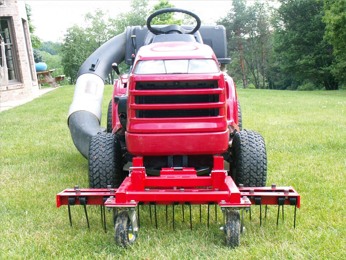

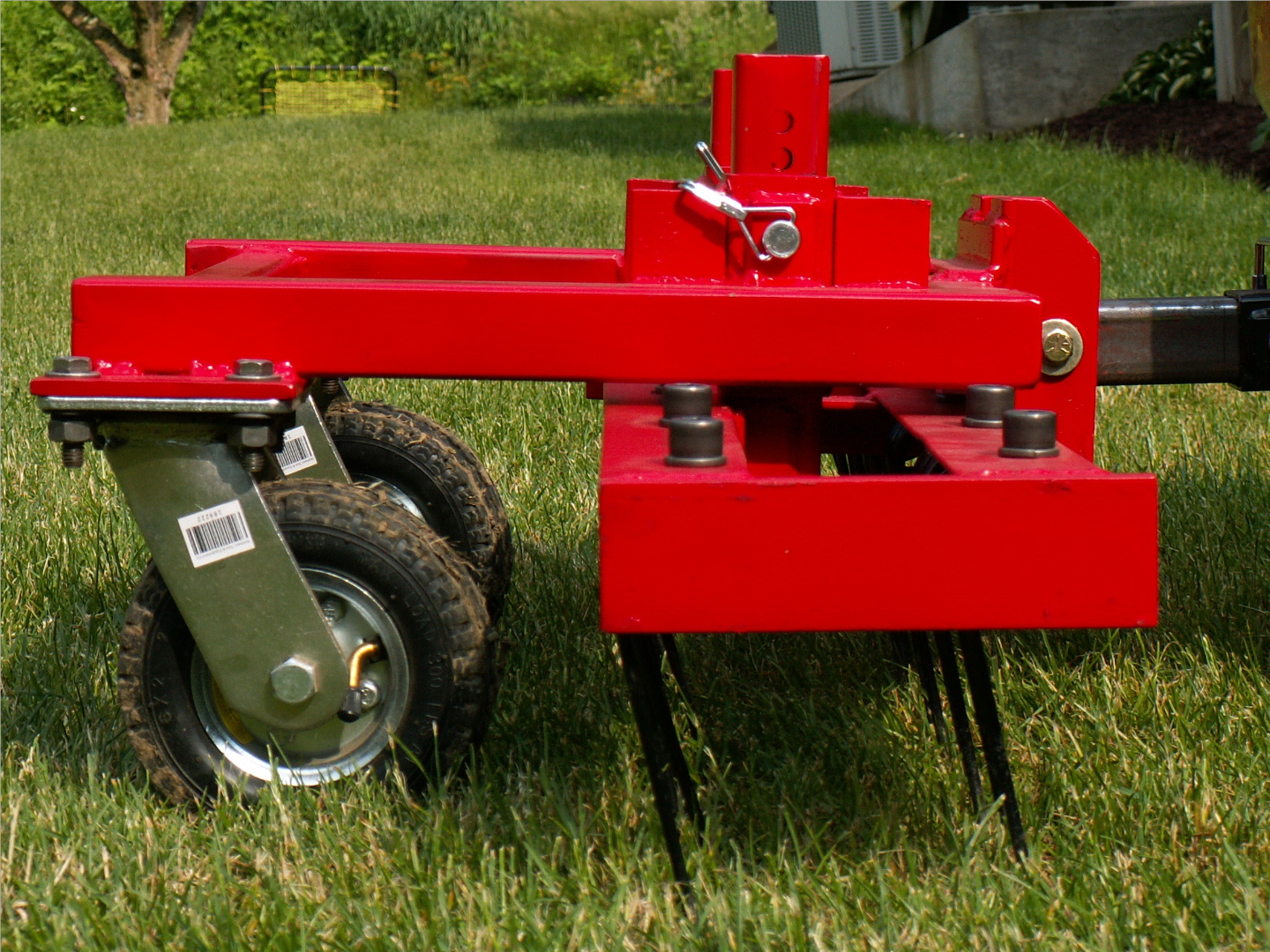

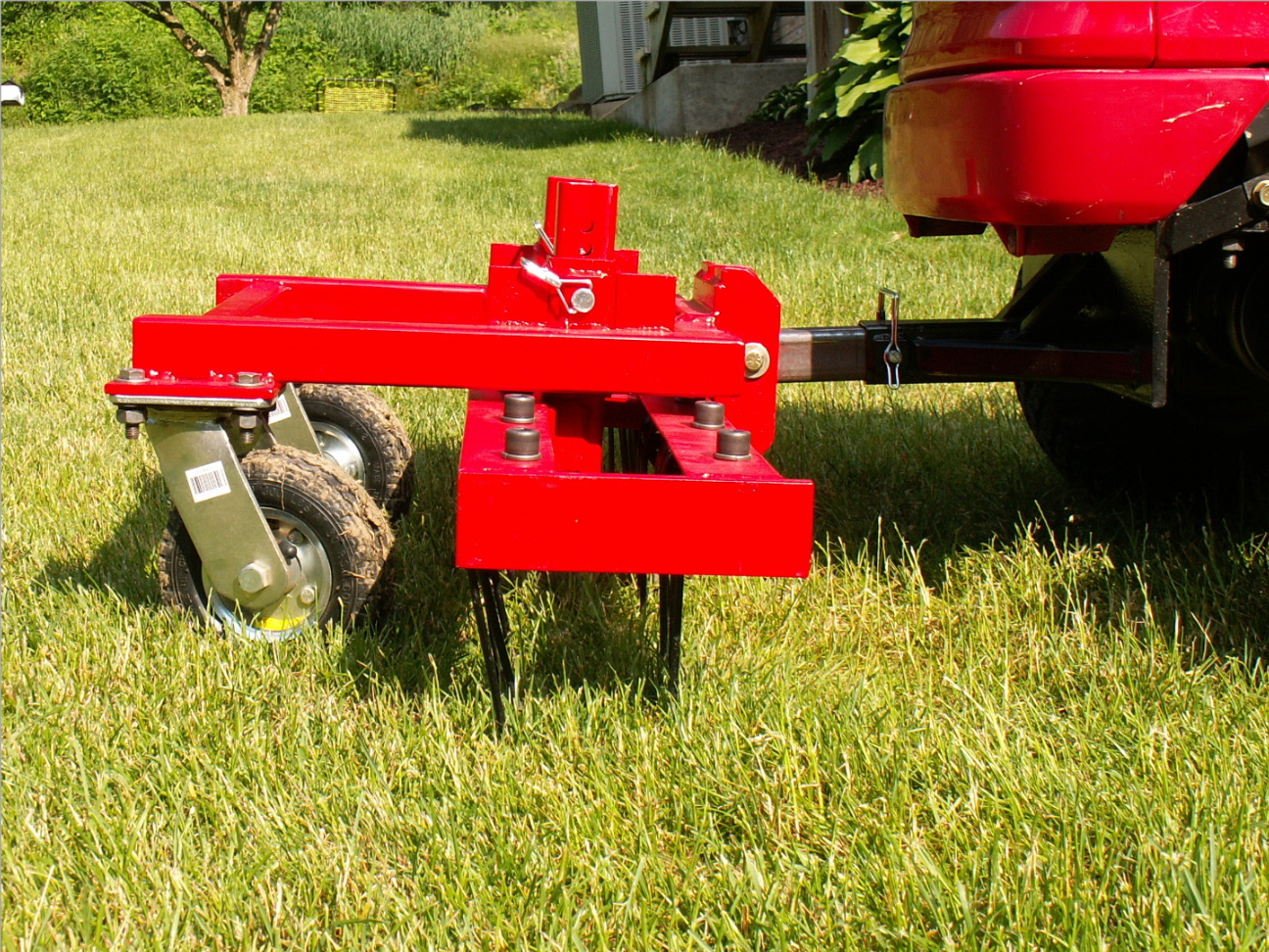

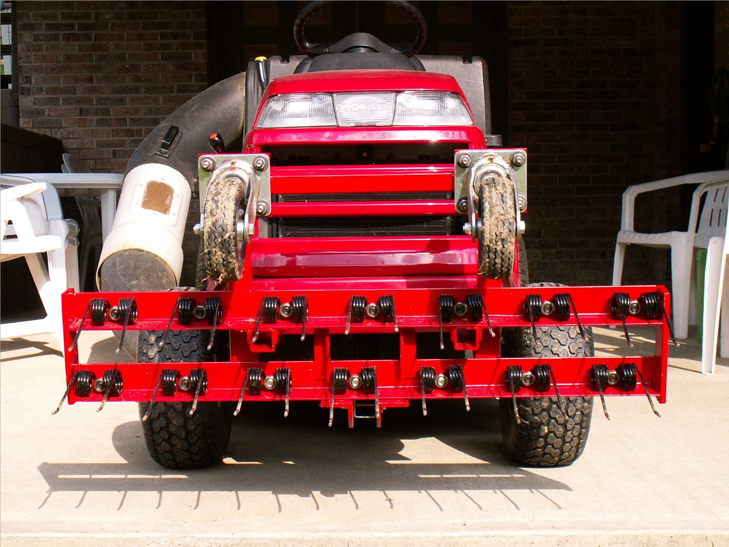

   / Dethatcher #6
I built this a couple winters ago. I spaced my tines so the tines in the front exactly split the tine in the rear. That way I had a tine scratching every 3" or so across the whole width.
Craig
