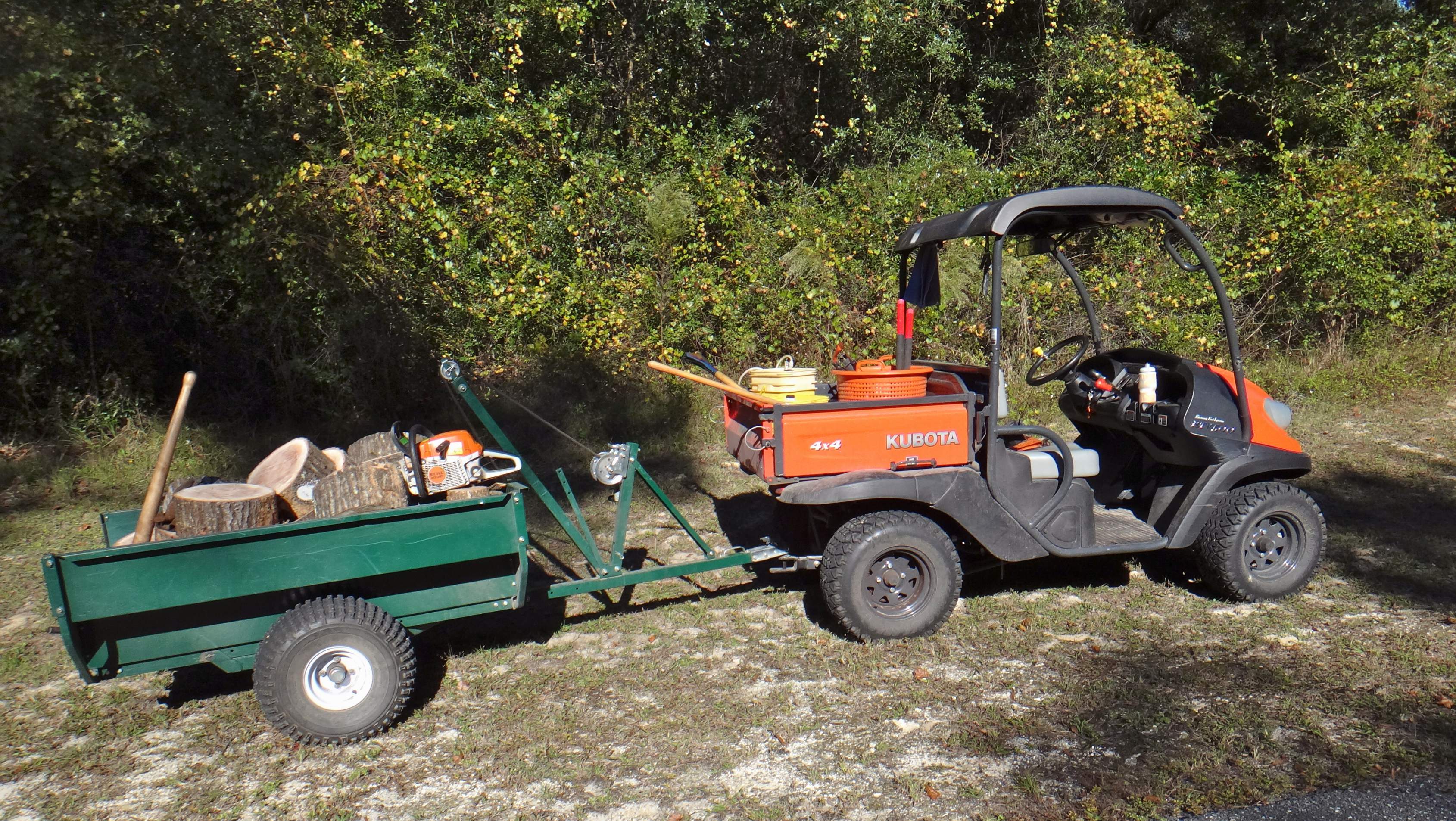

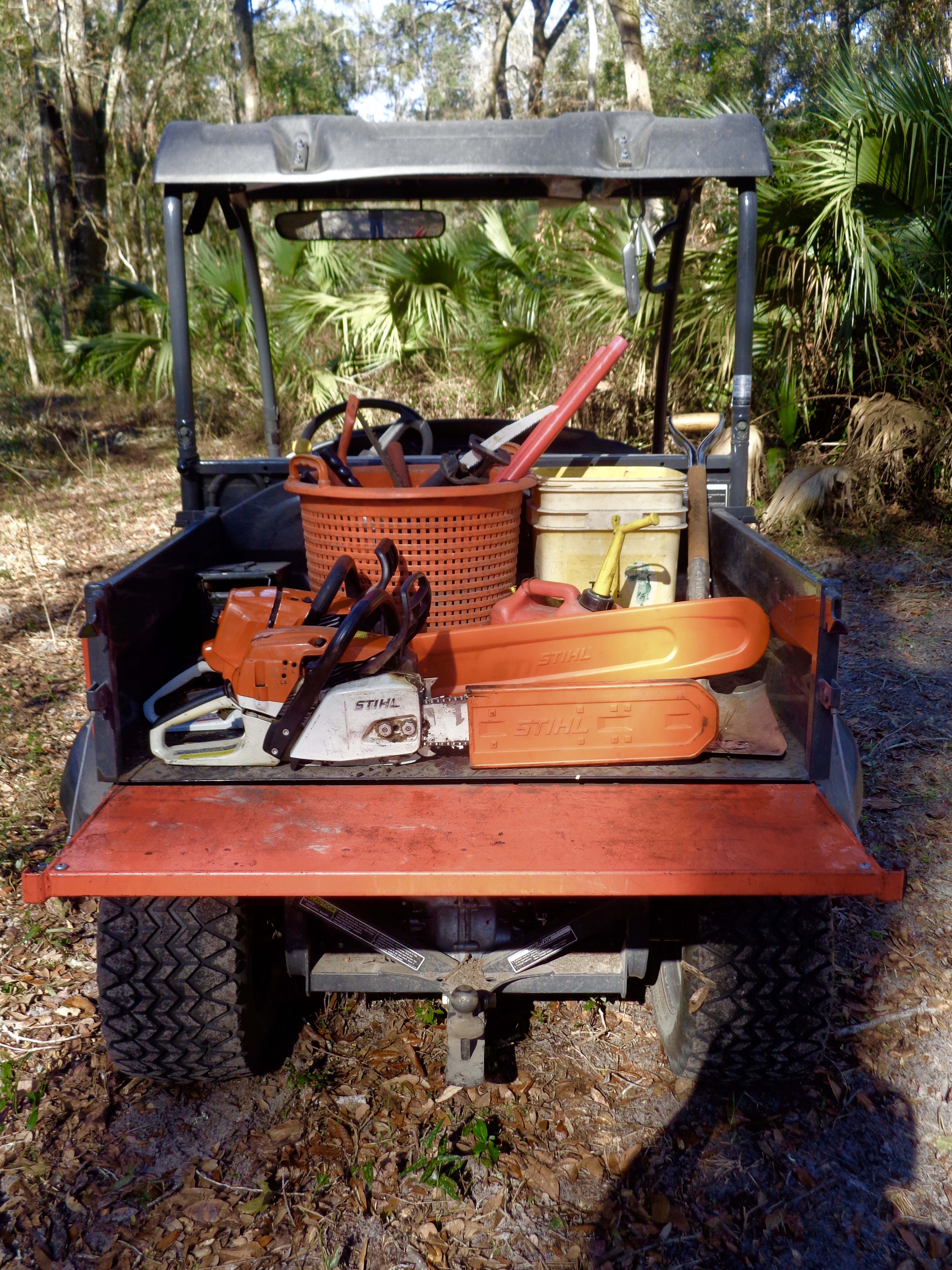

I could see that a dump trailer would be really useful for moving gravel and other material.
Probably more useful for collecting debris. Surprising how tiring climbing up and down from a tractor can be, relative to just swiveling legs ninety degrees and standing up from a utility vehicle.
