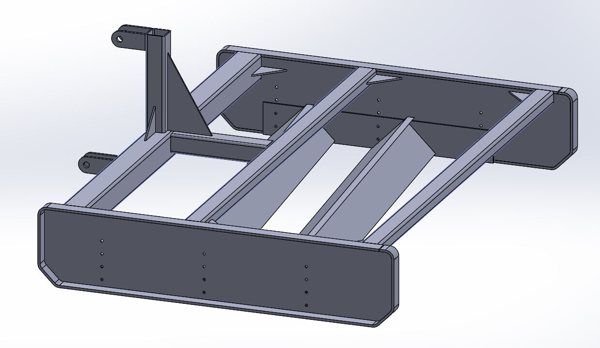

So, I really want a LPGS (Land Plane, Grader, a million other names that makes it hard to find on CraigsList).
I'll probably buy one (Land Pride or Grademaster), but thought I'd design one up just for fun.
I'm an engineer, so I figured I'd model it up and make a drawing and send it to a fabricator I know. If it comes in at sub-$1000, I might just go that way.
All that said, I don't have structural steel experience. I could figure out how strong it needs to be, pick the right thickness/size tubing, etc. etc. But....... I don't want to put that much time in it. So I figured that I'd post here. In return, I'll probably post my drawing(s) for others to take to their fab shops or build themselves.
I intend to make it adjustable like the Land Pride, but otherwise built like a Grademaster (or sort of Befco). No scarfiers. This ebay post has nice pictures (Brand New Befco 72" 3 Point Hitch Road Grader Blade | eBay).
I don't want a 2,000lb unit. People can adjust thickness/sizes to their own liking if they want. It will be a simple design too, for cost. I'm looking at a 72" unit at about 1,000#, I'd imagine. Perhaps with provisions for an add-on 55-gal drum of water for weight or something like that.
So, I need measurements.
How thick are the sides? How long are the skids? How thick are the skid shoes? What is the angle of the blades and what size angle iron is it, what is the size (and thickness!) of the cross tubing? What are the measurements of the 3-pt hookup (must be quick attach!)? Hole diameters, etc. What is a good blade source, or help me spec. a logically hard enough raw material.
I can stab at most everything and get close. But it'd be just like me to pick a randomly impossible to source tubing that doubles the price. I'm hoping by doing this post/getting feedback I can avoid all that. Heck, what grade of steel should I even call out? I'd likely leave it to my fabber, but if I can know I'm spec'ing something logical, then I will.
So, have at it, if you're interested.

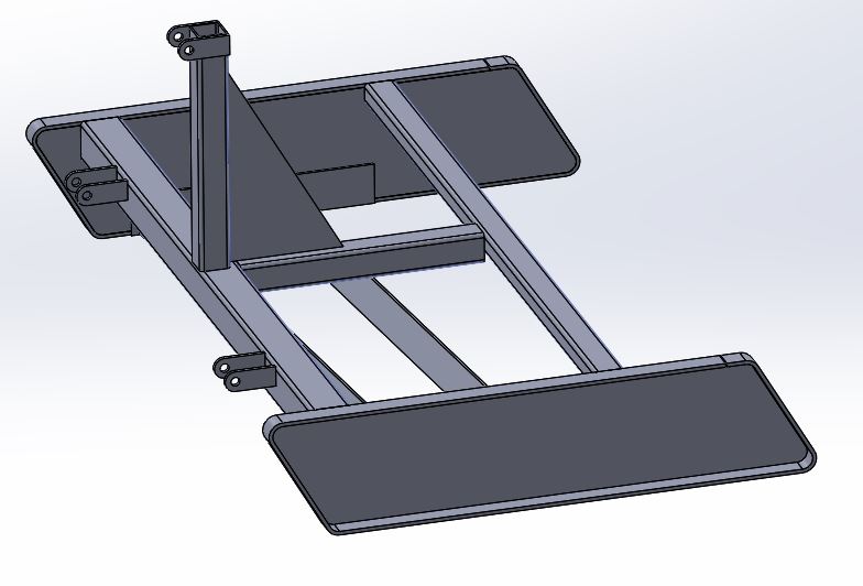

Thanks for the reply.
This is what I have, with very few real dimensions.
No slots/fasteners yet for the adjustable blades. Heck, no blades on there yet either.
Probably 1/2 hour of actual work.
Trying to make pieces the same if I can. All the tabs are the same, the 3-rd point upright and the center horizontal support are the same. Left/right sides will be the same (except for the band welded around will be left and right justified to make the sides).
Hopefully this screen capture posts right..

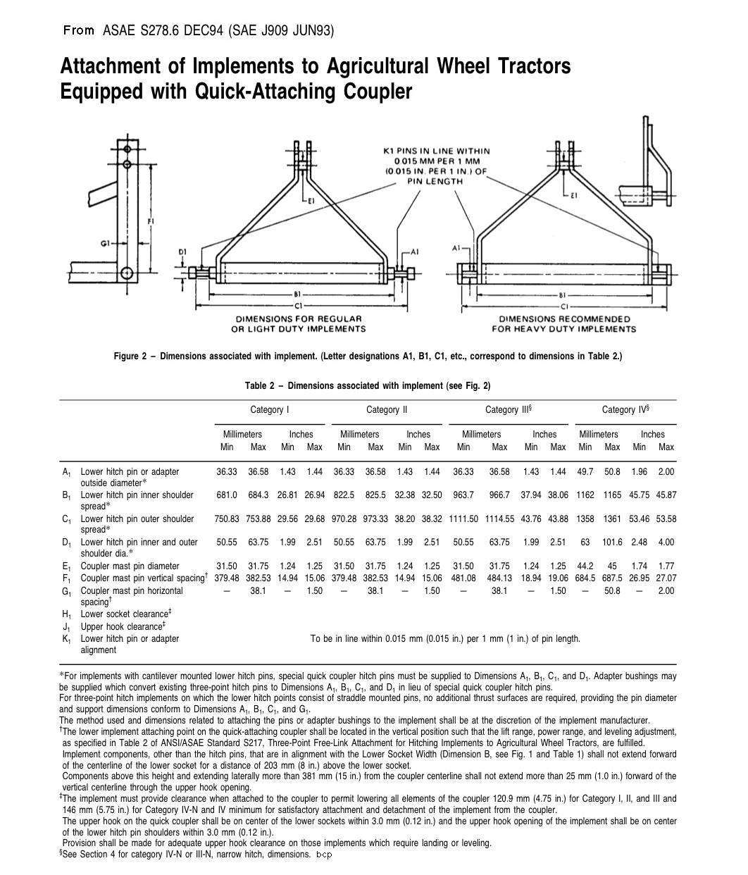

@bcp - Thanks also. Measurements integrated into layout. I don't tend to believe the pin diameters, so I'll be measuring mine. I thought they were 7/8".

I think you need to add side support to your top link attachment.

The measurements bcp posted are correct for the quick hitch couplers as they use cat 3 sized pins. You can use the cat 1 pins and add bushings. Also note in the top left of the drawing the hitch pins are all aligned plumb where yours has the top link set back, this should be changed.

"nobody" else has side supports on their top links, but I think I'll add some small gussets there and between the beams/skids.
Cat-3 pins makes sense. I'll put in the 7/8" pins and use bushings, since a quick-hitch shouldn't be a requirement.
I did see the mounts were plumb. I already changed that, but I haven't posted another picture.

960lbs as it stands. I'm in the right neck of the woods.
Would love some beam size confirmations.
6"x6"x3/4" angle for the blade supports, as suggested.
3/8" side walls?
3/8" skid shoes/wraparound?
4x4x.1875 front beam?
2x3x.1875 mid/rear beam?
3/8" pin tabs?
1/4" gussets?
1/4" plate to hold the angle, held in by up to 6ea 3/8" bolts?
3x3x.1875 upright for 3-pt and middle support.
blades at 5 degree angle?
blades 15" apart?
blades in front 2/3 of skids?
What do do about the blades where the meet the skids (at an angle). Probably leave them square cut and whatever gap is ok....?
I'm confident it's build-able and would work. But anything to hedge my bets against bending/breaking/etc. is good to do now.

I don't see the need for bracing a box tube post as you have drawn because the top link is free to move around. Where are the forces coming from that would demonstrate the need for these gussets?
/ Designing a LPGS #19
If the rear of the device is lifted from either side, not both, it will try and twist the top link.
It is not that hard to calculate the force but you have to have more information.
Think about this. If you have something stuck and try to pull it with a chain connected to another "puller" then the tires spin on the "puller".
Say the chain is 50', if a person moves to the middle of the chain and steps on it with 100lbs of force. That action will pull both together as the force is multiplied by many times.
Think of it as a lever, if the chain is in tension 1ft off the ground and you move it to the ground by that foot (again in the middle) it will pull the two together by a very small amount with much more force than the 100lb applied.
Look at mowers that mount by a 3 pt, they pivot by the force the top link has if loaded at the rear.

For the beam sizes I would beef them up to 4" square tubing .250 wall and make them all the same. If someone needs to buy this it is usually available in 20' lengths, so one stick can build the whole plane. It is desirable to make the whole plane as rigid as possible without the skids being able to flex independently. You want the whole thing to stay as flat as possible so that when one side rides over or through a high spot that the whole weight of the plane is pushing down on it.
If you look at the top frame with the beams figure out the best way to reduce these from twisting. On my plane I have box tube between the beams to make it more rigid. Placing these pieces in line with the lower links also braces the tubing from bending or flexing in a hard pull but that is a secondary benefit.
