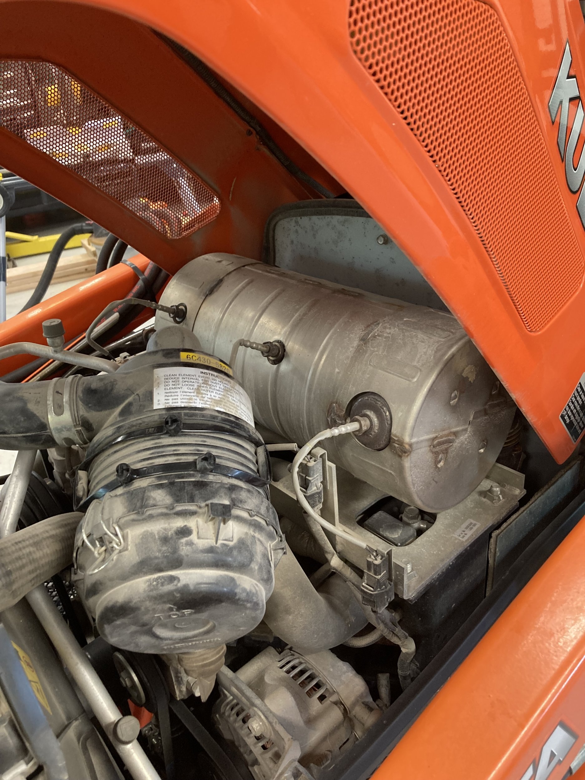

Near as I can figure you need to make it look like that. The emulator box or what ever you want to call it plugs in and duplicates the DPF. I do not think you would know the dpf has been bypassed when you plug in with a diagnostic software. Or you would have to be specifically looking at the DPF reading and know what your looking for.
It isn't broke yet, be nice if I could get one of those that has failed, core it out and try it.
The dealer isn't going to know.

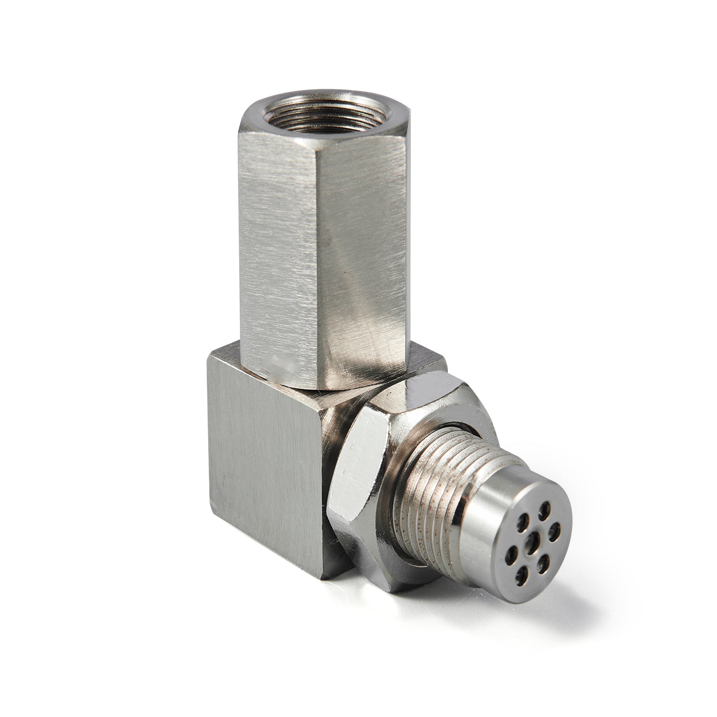

If you install an o2 sensor spacer on the down stream o2 sensor on your car the engine ECU thinks the convertor is still there. You can't tell on a diagnostic tool with the auto software I have been using on our older GMs anyway. So I don't think it would be any different with Kubota's software.
One of these.
I also wonder if the same thing would work here? or idea anyway.
One of these.
From what I have seen most DPFs have a differential pressure sensor which monitors the restriction in the filter and a temperature sensor to monitor the regeneration temperatures.
If a person searches for DPF emulator several options will show up.
