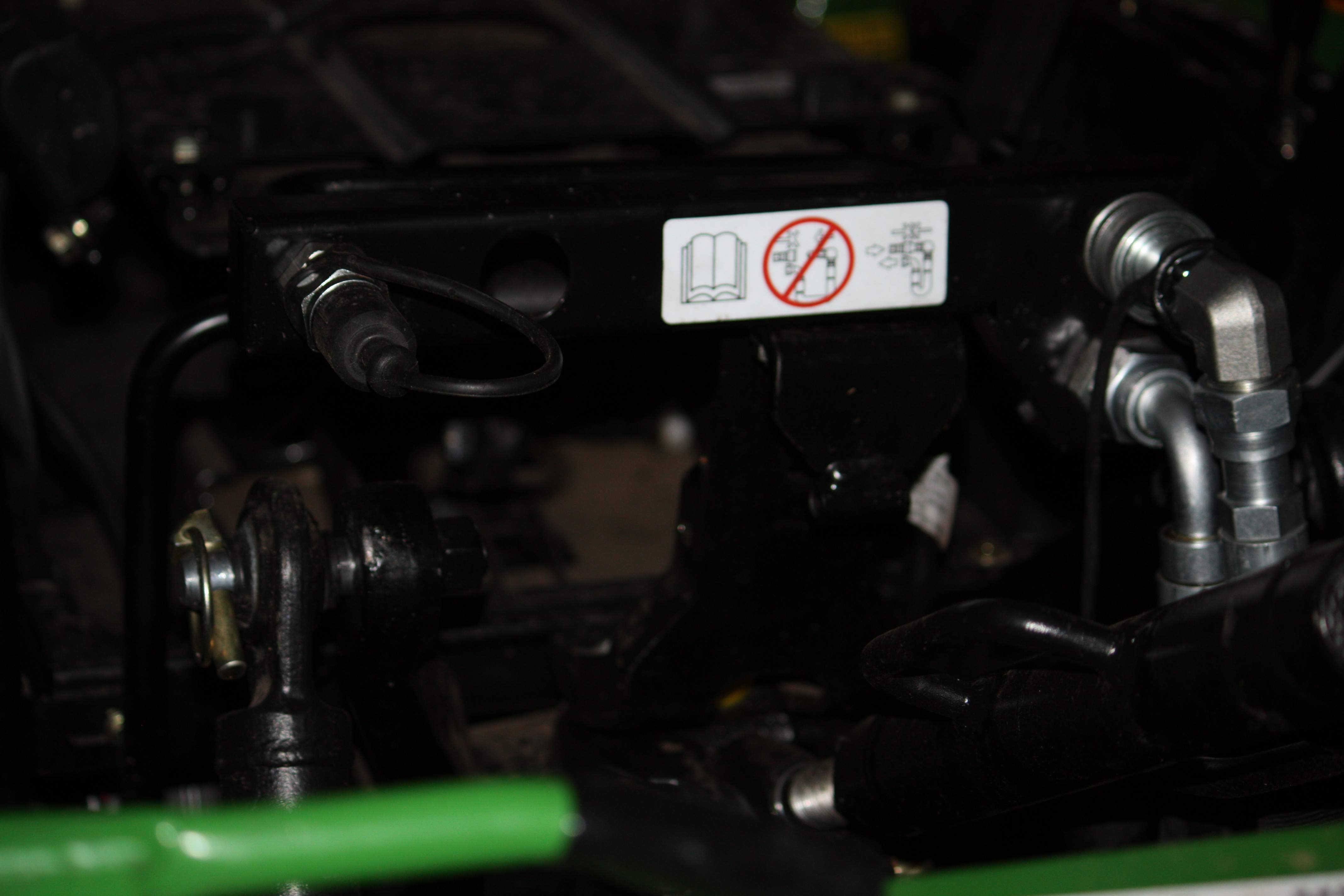

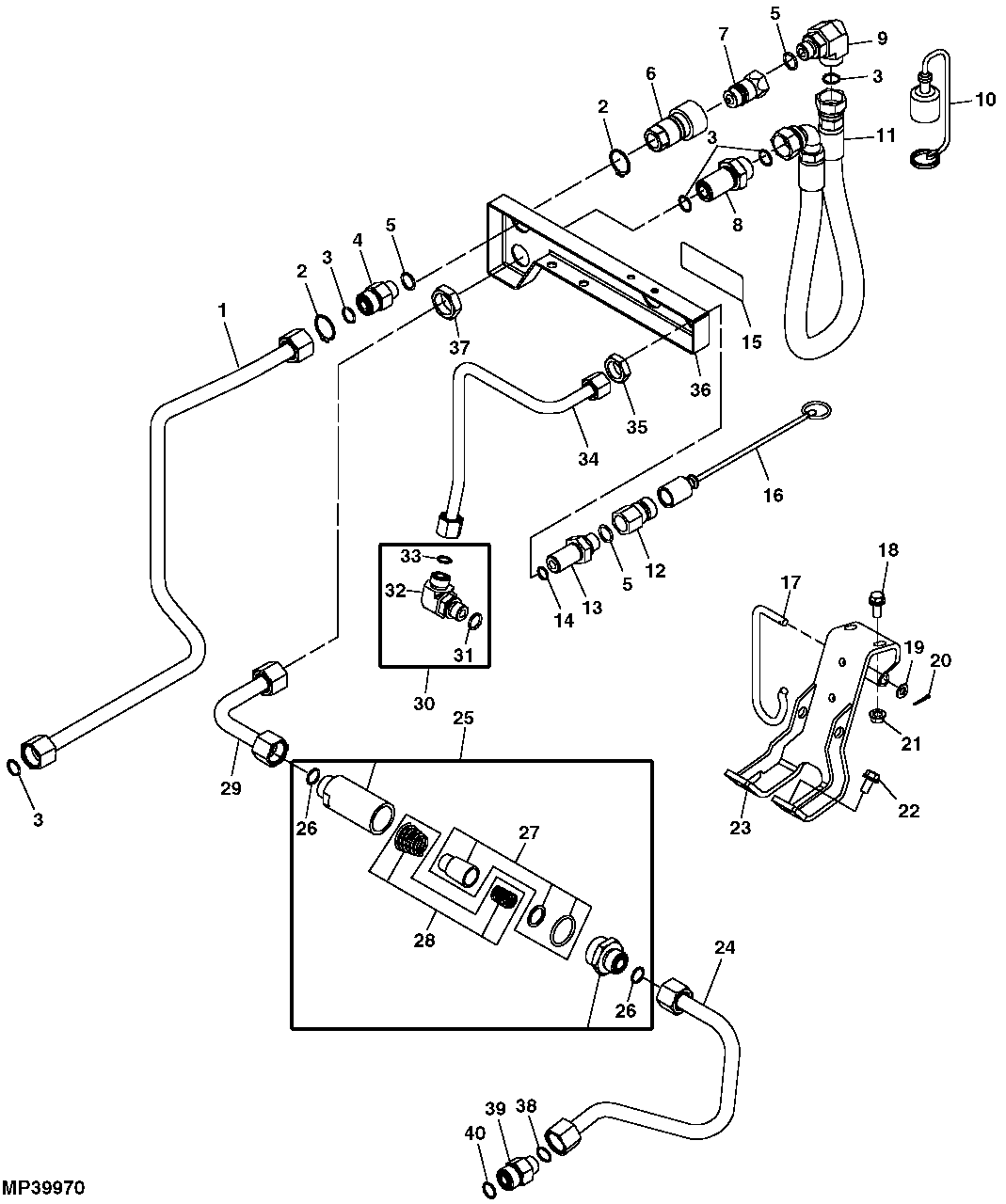

I ended up using the tractor's SCV and rear remotes to operate my grapple. I do have the JD hard lines installed on my 3320 (not sure you can get these for your tractor/loader) so it was pretty much "plug and play" for my grapple.
I think you could be quite satisfied with the operation via the SCV and using your existing hydraulic remotes. As Kenny points out above.....it's mostly a matter of getting hoses to the front of your tractor. You still maintain rear remotes for other needs by just "unpluging" the quick couplers.
Also, most Deere Dealers have a "Fasse valve kit" which allows an electric diverter to plug into a set of rear remote couplers....thus giving two pairs of remotes and an electric switch to control which pair of remotes you want to use (via the SCV on the tractor). This is a fairly easy and affordable alternative IF you want to keep a set of connections available for use at the back of the tractor AND use your grapple at the same time.
(I considered more hydraulic remotes as I wanted to also control a hydraulic top link and have a need to operate two cylinders on my stump grinder.....therefore considered an electric / hydraulic diverter valve or a power beyond and another valve. So far, I figured out how to get along without adding extra remotes. :D )
Hope I didn't serve to confuse. :confused:
Addendum: See my post on Woods stump grinder to see how I plumbed my grinder without adding more hydraulics. I think it works well....and I didn't spend any money to get two extra cylinders to operate when using the grinder.
