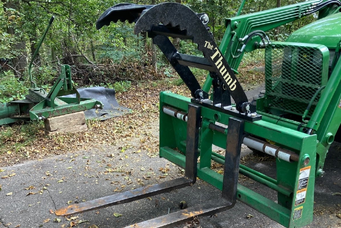

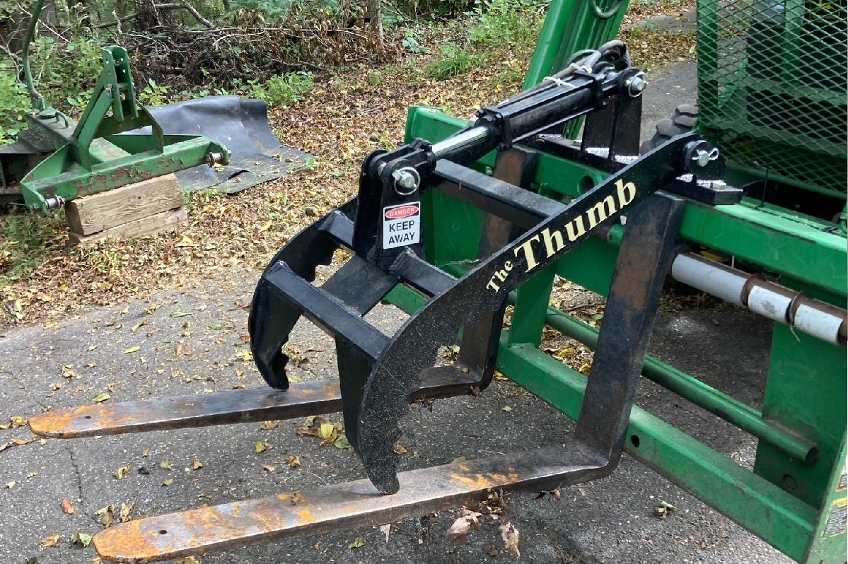

Hi McCann & Lavender Valley,
Sent you both a personal message with my thanks for taking the time to respond. I think I'm all set with my grapple hook up.
FredSG
just a heads up if you have any problem with the valve as I did on my 3039R after not using it for a few years I took the valve apart and polished the spool and the inside of the valve body and it started to work again. Good luck
