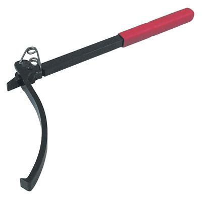

They make an actual tool to rotate and hold the flywheel by the teeth. It gives a lot more leverage than just your hand, and makes it so you can use hand tools if needed/desired. I call it a flywheel wrench but it probably also has other names:
