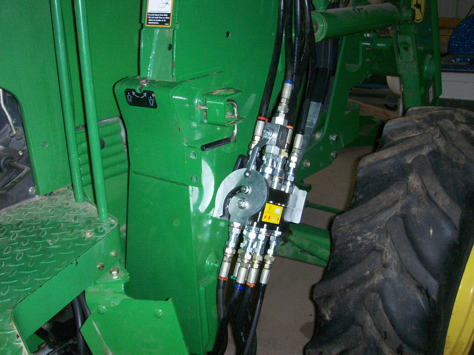

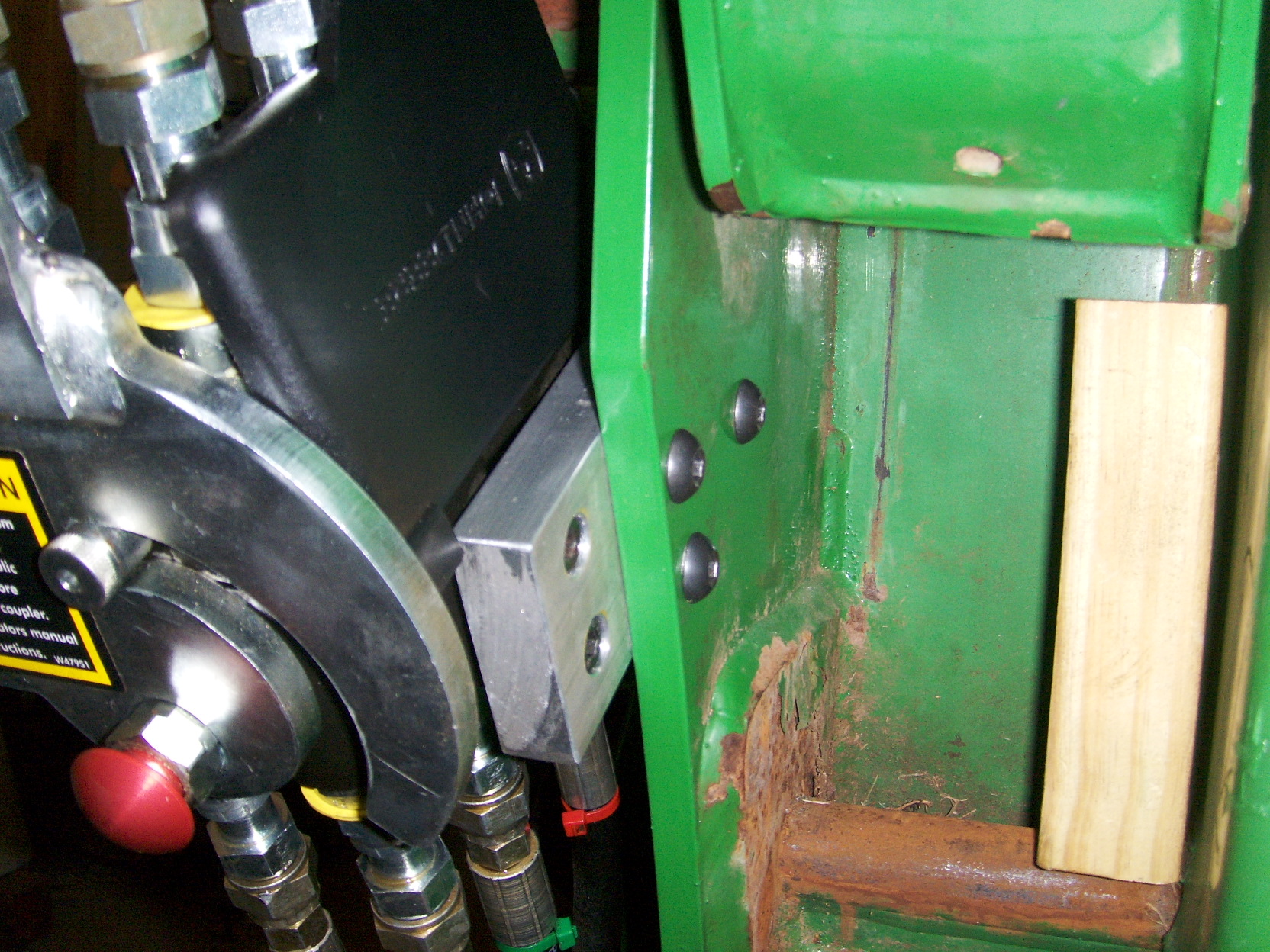

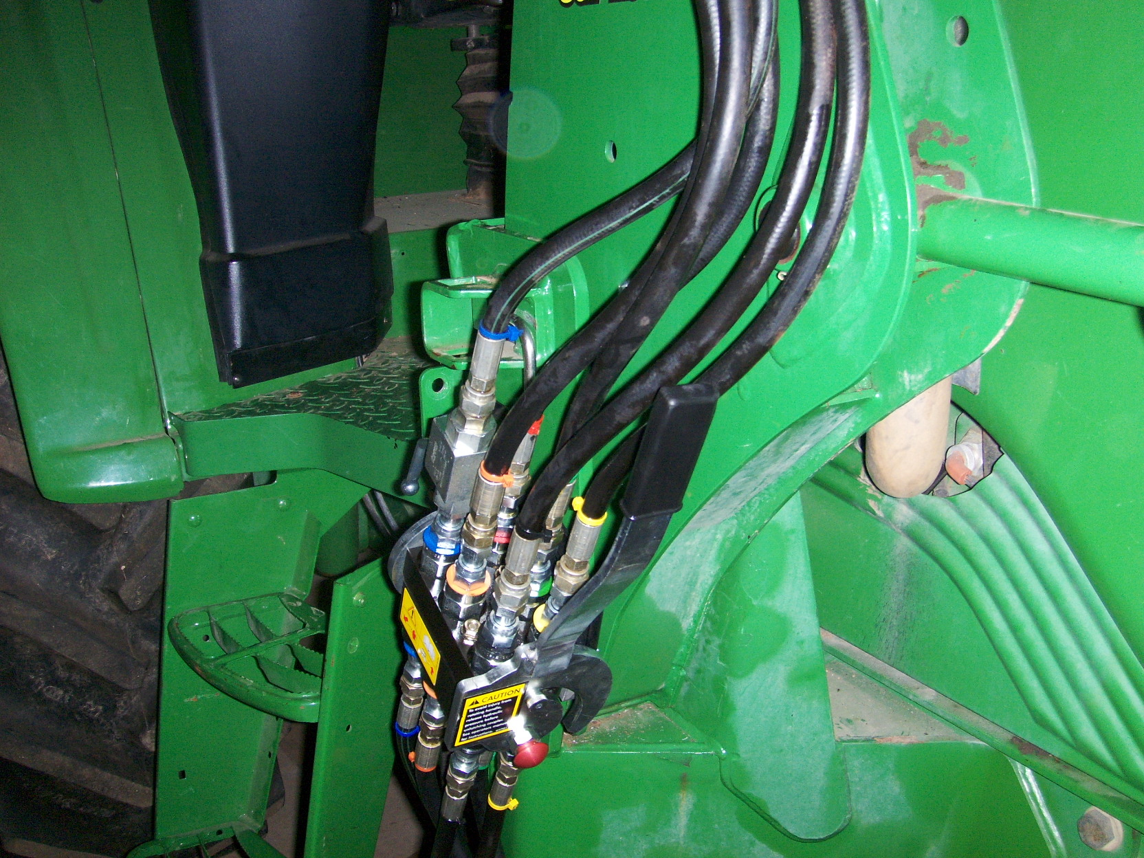

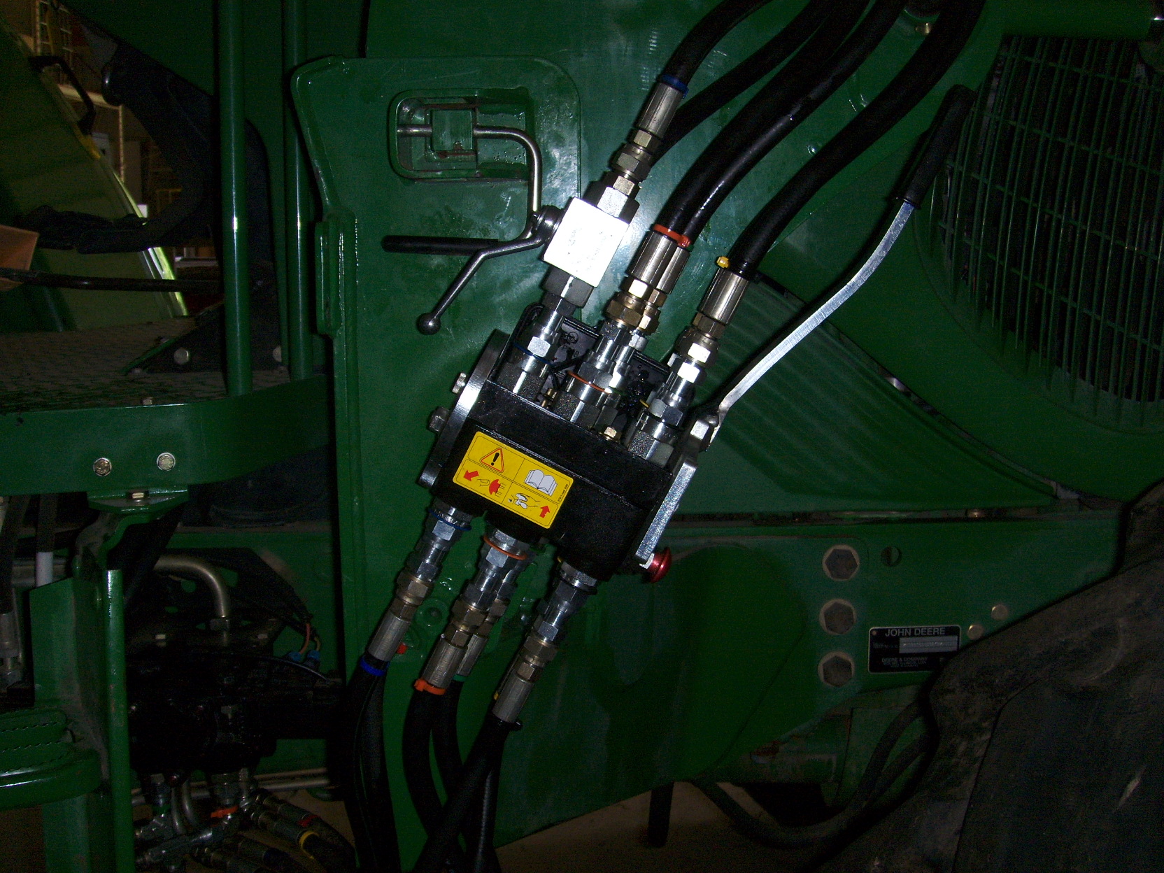

Just temp change will build pressure in the hoses when the loader is off. Multicoupler saves a lot of frustration.
/ Deere h160 #7
JD multi coupler, made by Faster. I liked so well I put on both my tractors JD 2030 and JD 6415.
