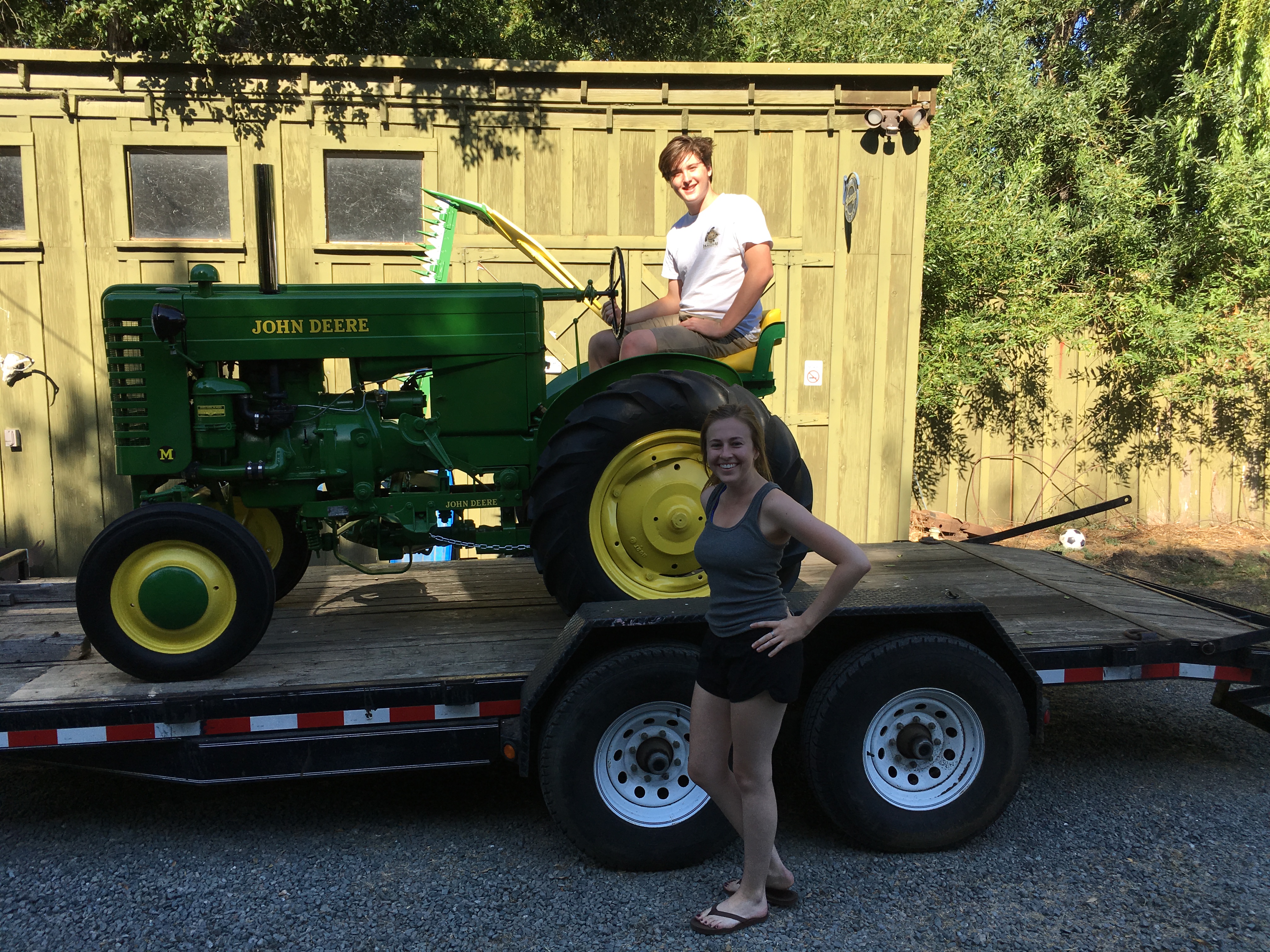

Forgot I had this picture of PJ with 8 lug and my 9000+ pound service van which has been scaled as much as 9200 pounds with mods to springs

Axles are 6k and I believe 8 lug...
Trailer is at ranch and regularly earning its keep...
At first I didnt particularly like the tilt up ramps but find using to add a margin of safety.
I like the identical ramps on my trailer. The downside is they limit the length but they are a lot easier to use than the stow underneath kind. They also support the back of the trailer without the need for additional blocks or jack stands. My backhoe boom fits between them so the length isn’t a problem for me.

If I didn't know any different I would say with certainty that those are 7K axles. Dual 7K are routinely de-rated in CA to 9900 / sub 10K. Not sure why the 12k original rating claim, maybe that was just an errant claim by the PO? Nice trailer and looks like you put it to many good uses. I do miss my 18' sometimes!

They probably are with possibly lighter springs. 6k axels usually aren’t 8 lug.
/ Deere 110TLB #51
6k axles are typically 8lug, the spindle/brake assemblies are the same from 5200-7k but the drum is different (6lug) for the 5200lb. The difference between 6k and 7k axles are the tubing thickness and spring pack, 6k is 1/4" wall and the 7k is 5/16".
Of course there are exceptions for everything, but this is the difference for most Dexter and similar brand axles.
There are also some 6k 6lug axles but not as common.
