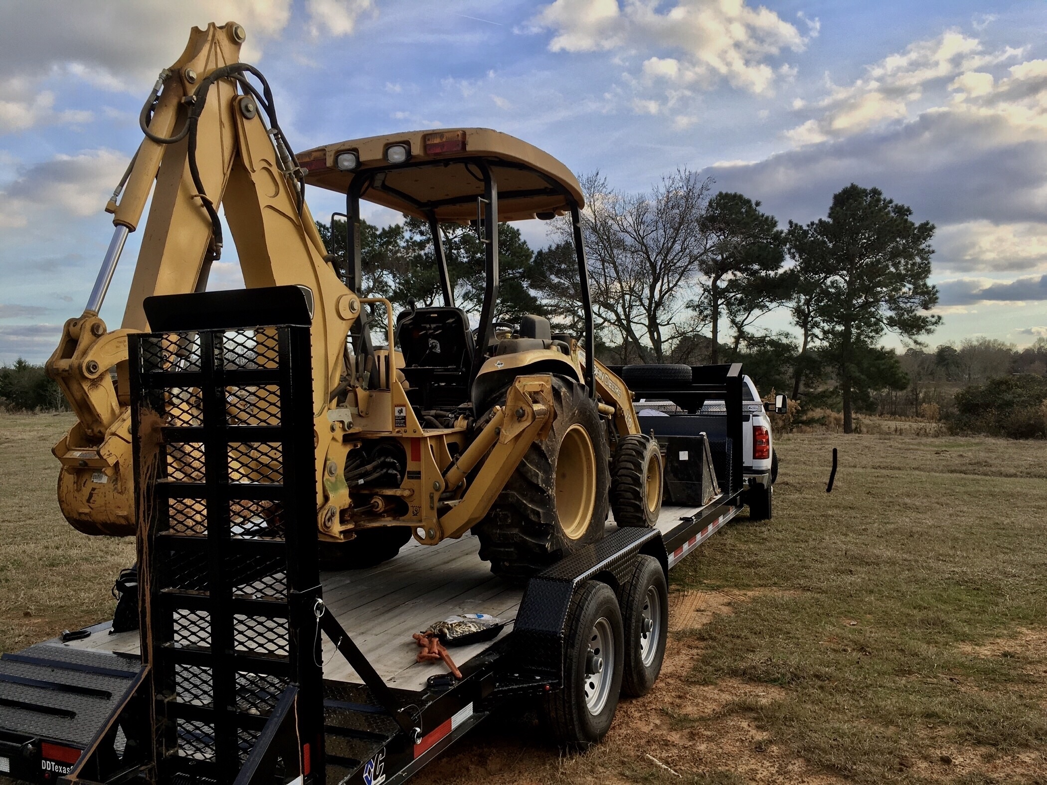

Looking at a 110TLB, 5500 hours, 4-1 bucket and thumb, low 20's.
Anyone else have experience with a high hour machine?
Mine has been a good worker for what I do with it which is 菟roperty clean up around the farm and some rentals properties in town. I can trailer it easily with a 3/4 ton truck. The thumb is extremely handy. I also have a JD auger which I use on the backhoe to set corner posts. That has been great.

I've had a 110 TLB for about a year. They seem to bring between 30-35K around here no matter what. Did see one sell in the high 30's a few years ago due to low hours but didn't have any Aux hydraulics at all (3rd function/7th function/3 SCV)
I like the tractor, no issues with cracked bell housing here, just need to ensure the loader mast bolts stay torqued. That said my tractor hasn't been abused in the loader area and was never a rental. It was used as a PTO tractor for bush hogging, box scraping and Harley Raking most of its life. The model ran for 10 years with one main change after the first year or two. Not many compact tractors, or any that I can think of have the extra 3rd hydraulic pump that is dedicated to run the loader & backhoe. I believe the other two pumps are dedicated to the hydrostat and steering. My favorite feature about it is the low profile sloped hood. Makes using pallet forks a breeze due perfect visibility, or any front tool for that matter.

Look for a trailer at the same time.
