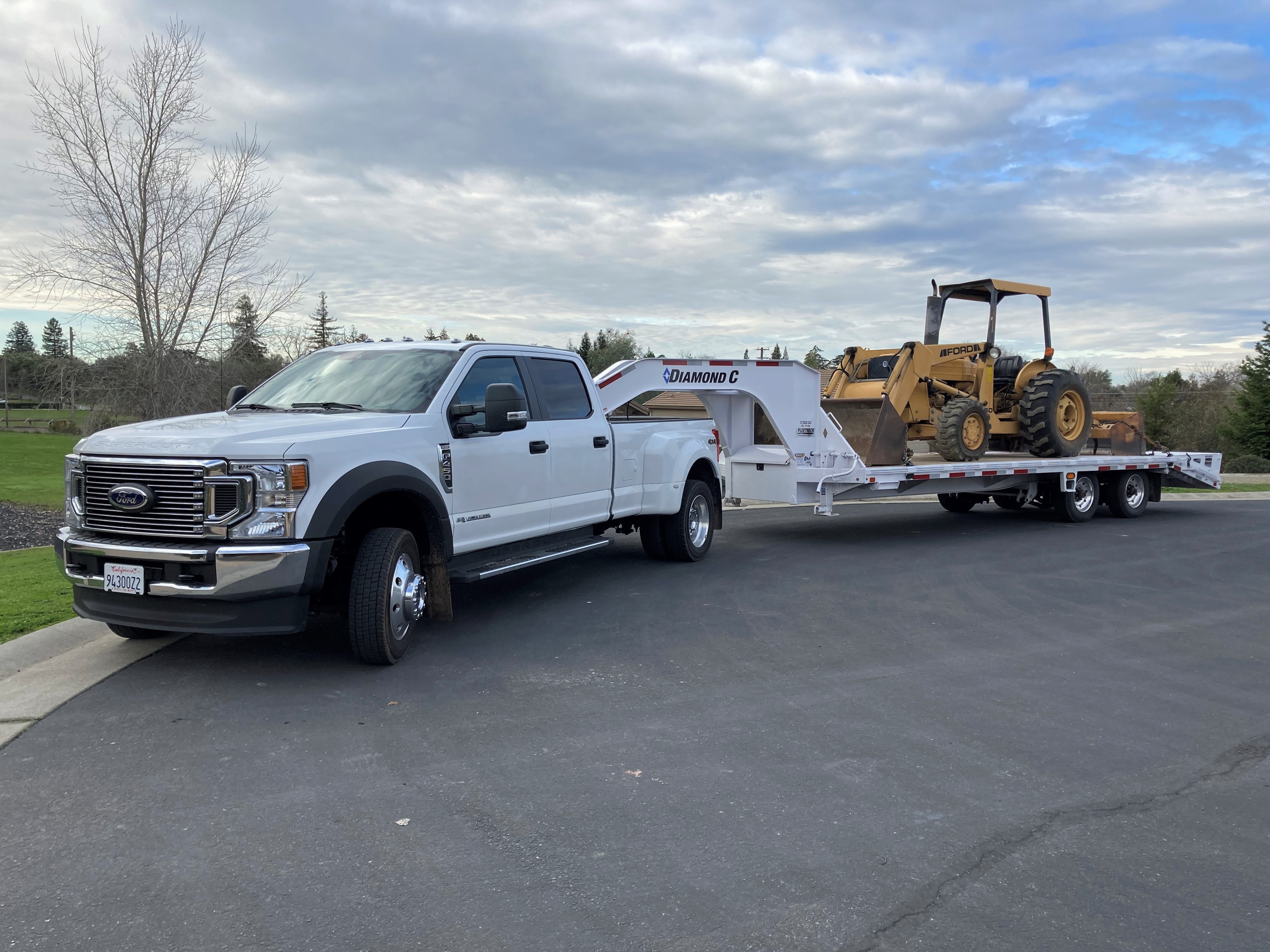

Nice Diamond C. They are taking over the trailer world! I have a 25' FMAX 210SS and a 12' UTV trailer. Wanted to go with 8k torsion axles vs 7k but the 10K hutch was about the same price so I went for the extra beef. I do have a class A CDL however.

I looked around a while before settling on the Diamond C. They are good. Glad to hear you had good experience with yours!

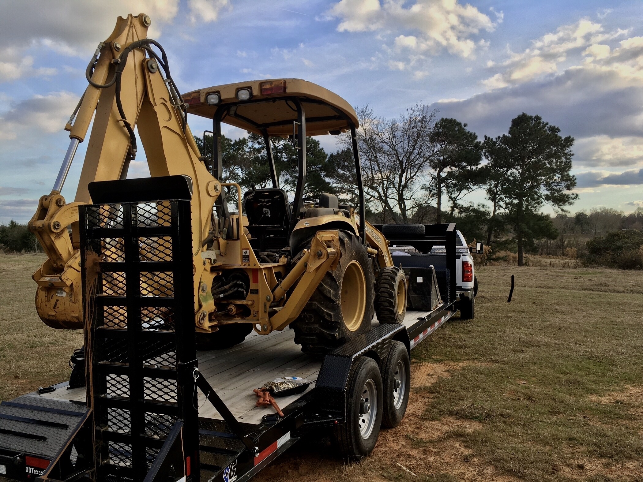

My 110 fits nicely on 18' PJ with tilt up ramps, 12k rated de-rated to 9980.
/ Deere 110TLB #26
Gotta be mighty close, at 9980 trailer GVW.
JD 110 weighs 7600 lb. (+ fuel).
That leaves only 2380 lbs. for 18' trailer wt.
Maybe......but VERY CLOSE.
My 20' 14K "Quality Steel & Aluminum" trailer weighs 3,300 lbs. can't quite imagine that a 2' shorter trailer actually weighs 920 lbs. less.

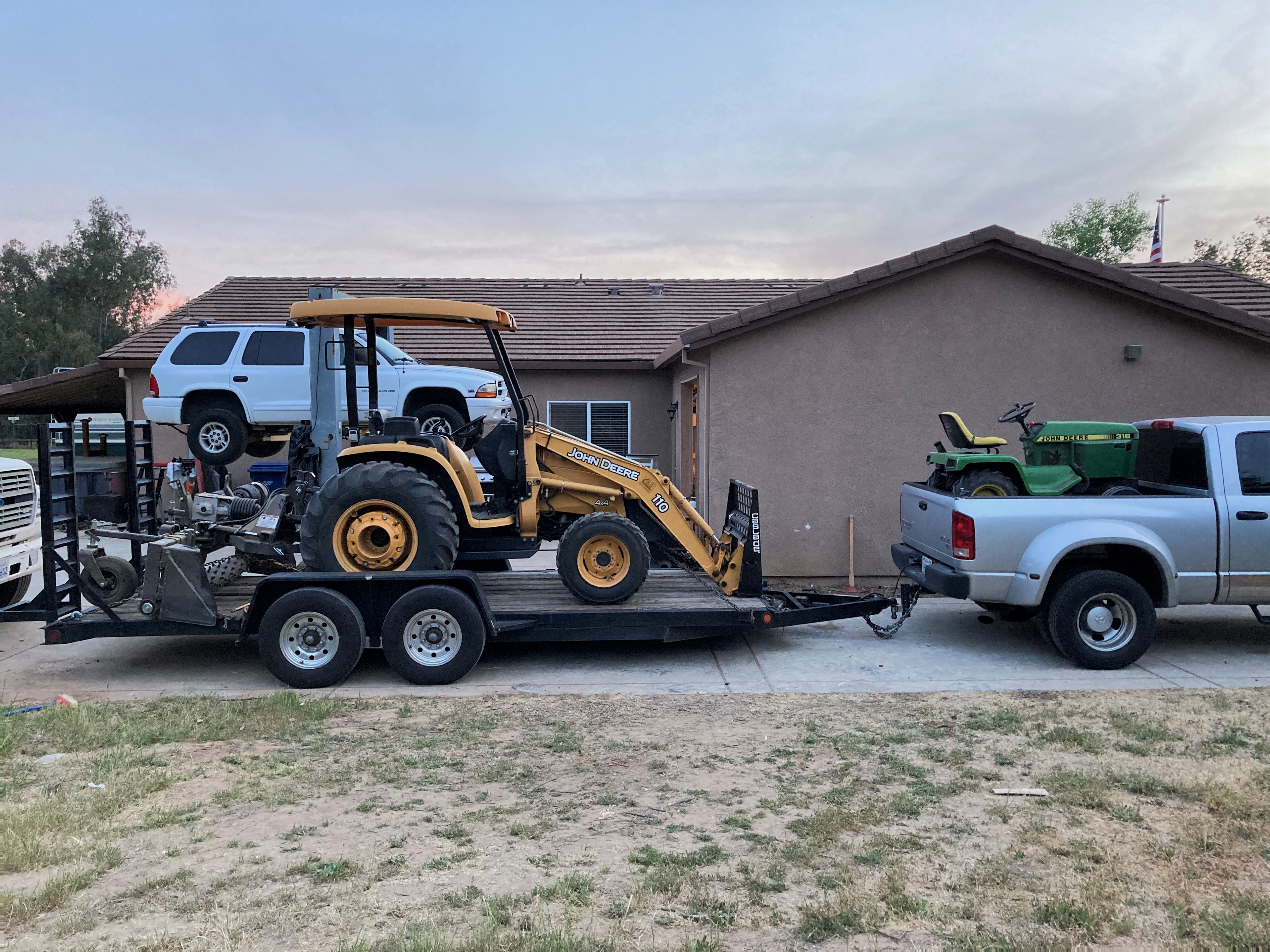

Here is the 110 on my "Best Trailer INC" 18' with flip up ramps trailer. Never did go though a CAT scale with this setup, only towed it once. Note that the trailer had two 7K drop axles, with ALCOA 16" forged Aluminum wheels and Good Year G614 "G" rated 14 ply rating 110PSI tires. Also here is a pic of my current setup with the 545D. 15K trailer axles, 8ish K rear and 5K front was the weight with that load.
/ Deere 110TLB #33
View attachment 685096View attachment 685094
That "Best Trailer INC" works just fine as in your picture.
Most, however, would be hauling a 110 with hoe attached, and an 18' deck is just too short for that.
