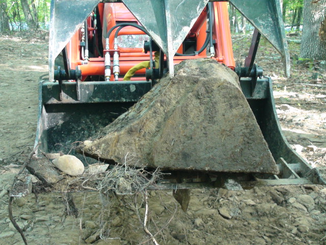

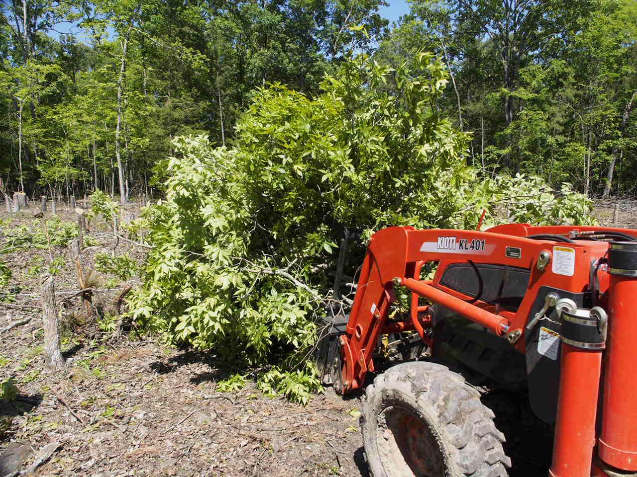

Can't help you with the see or touch- sorry. My Kioti tractor is similar in size to yours. I used my grapple to help clear a home site from a forest. A quality grapple is made of heavy steel. The wider it is the heavier it is with resulting less lift capacity for the load. I chose a 48" rock grapple that weighs ~ 500# I seem to recall. I see no reason to get a wider one for grabbing and carrying large items such as tree parts and rocks. Even large amounts of brush can be carried in it. No regrets on my size after many hard hours of use. I find I can get the grapple into places I could not with a wider unit.
Most folks on TBN purchase wider units I believe.

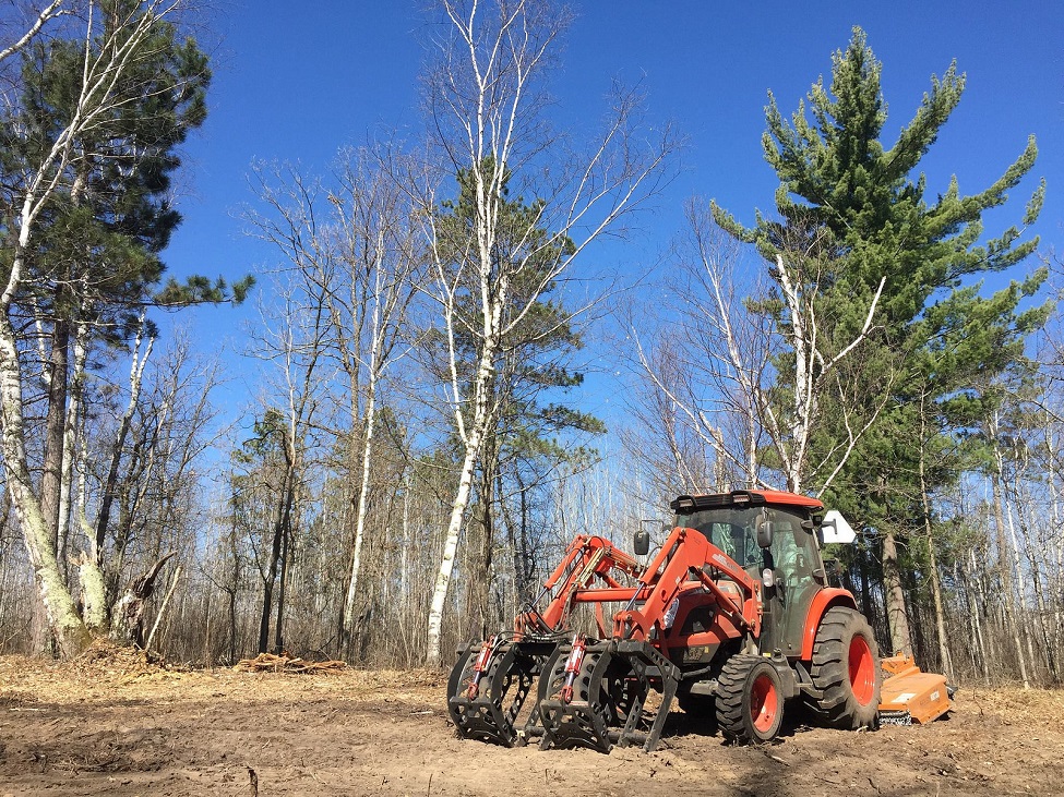

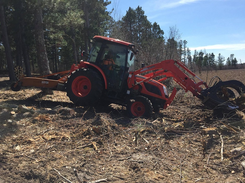

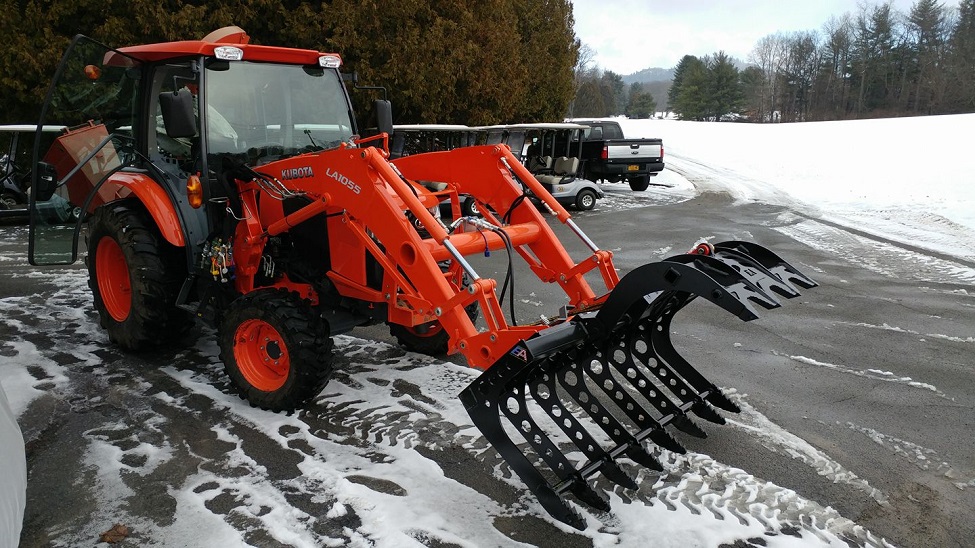

I have a Kubota L4060 HST. My grapple at 60" is just a bit narrower than the tires and I wouldn't want it to be any wider. Rick at EA talked me through this. I think the FEL bucket is 72".
Width reduces maneuverability and loader capacity. And there hasn't been anything I've picked up or pushed where the width would have helped to the job better or faster.

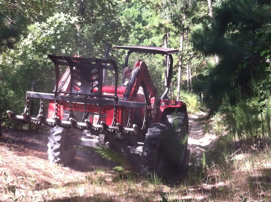

I'm in the wider is better crowd but can see the argument for narrower. Root raking large areas is faster with wider. Additionally, I'm picking up 18-20 foot logs and processing them. I could see narrower as a around the house tool, but for outright logging and clearing I'd say wider.

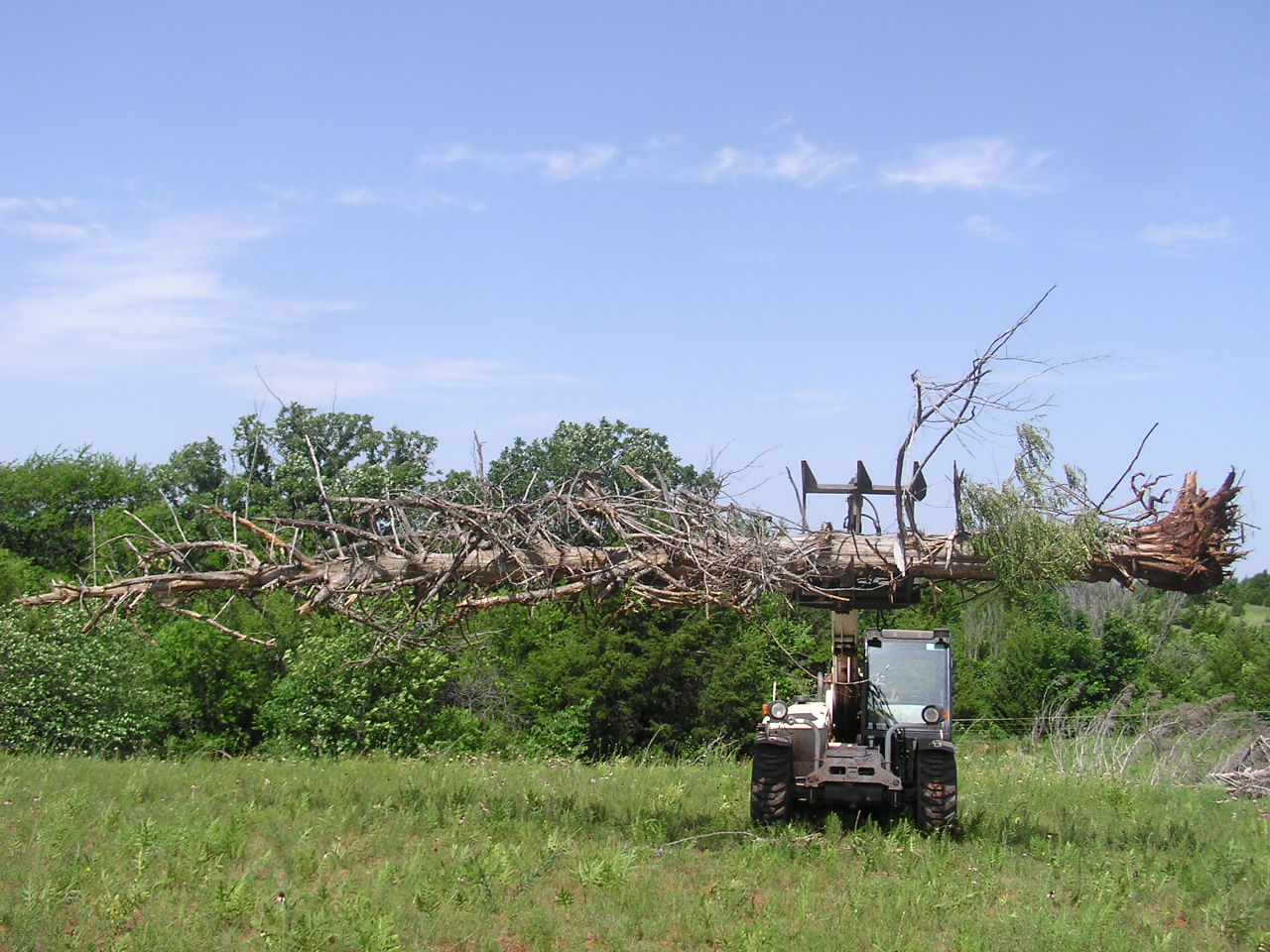

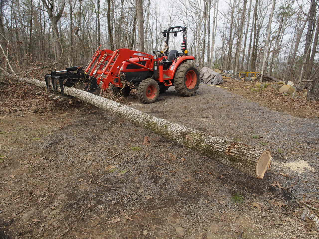

A wide grapple isn't needed for moving long logs or trees, just find the balance point.
This grapple is 44 inches wide, on a 6 foot wide V417:

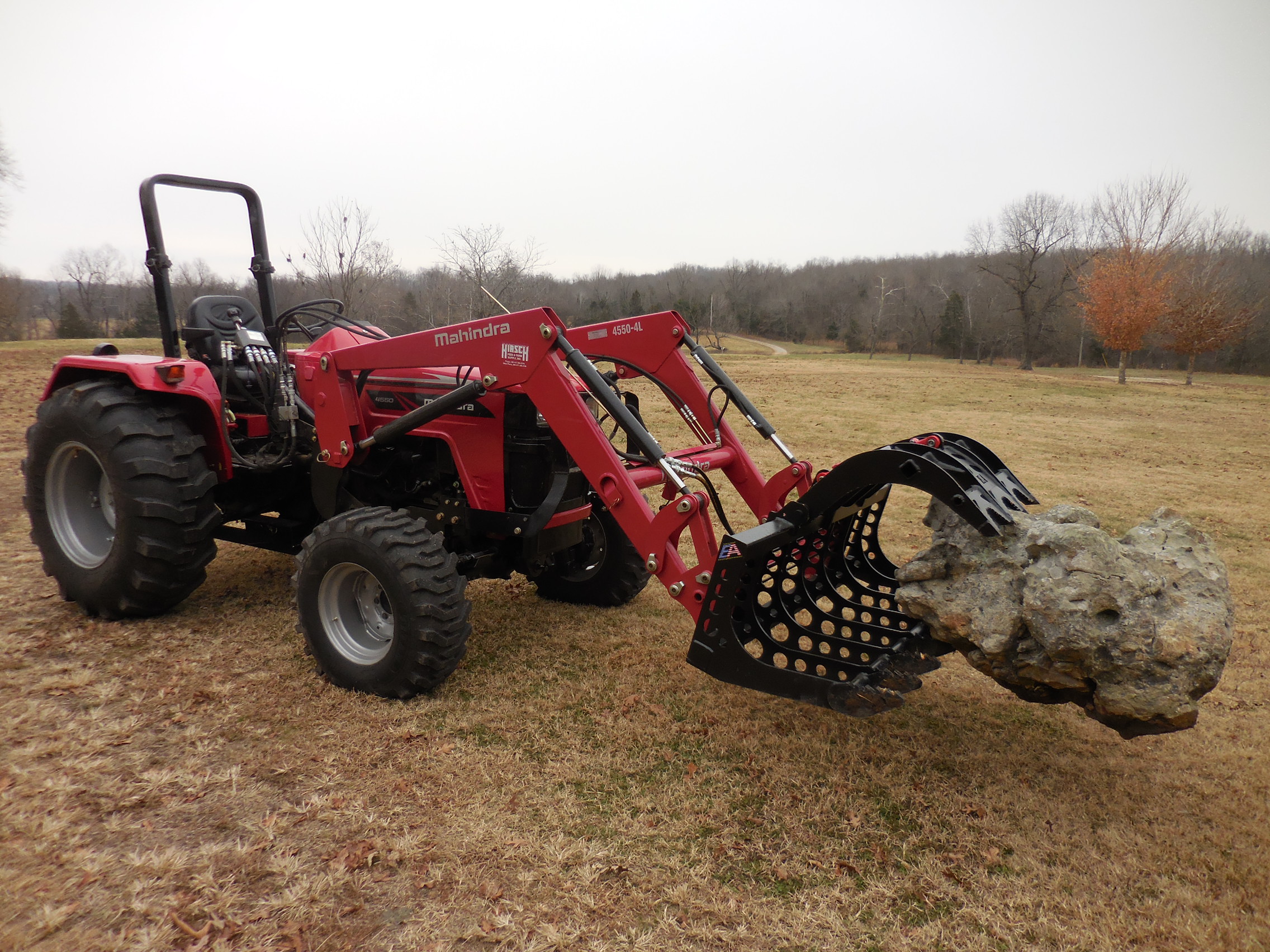

I think I have settled on getting the 54" grapple for the maneuverability since my tractor is large.The biggest thing I'm wrestling with now is do I need the bigger utility grapple EA just came out with or can I get by with the Wicked grapple. Is my tractor too big for the smaller grapple and will I be disappointed in the long run for not going big

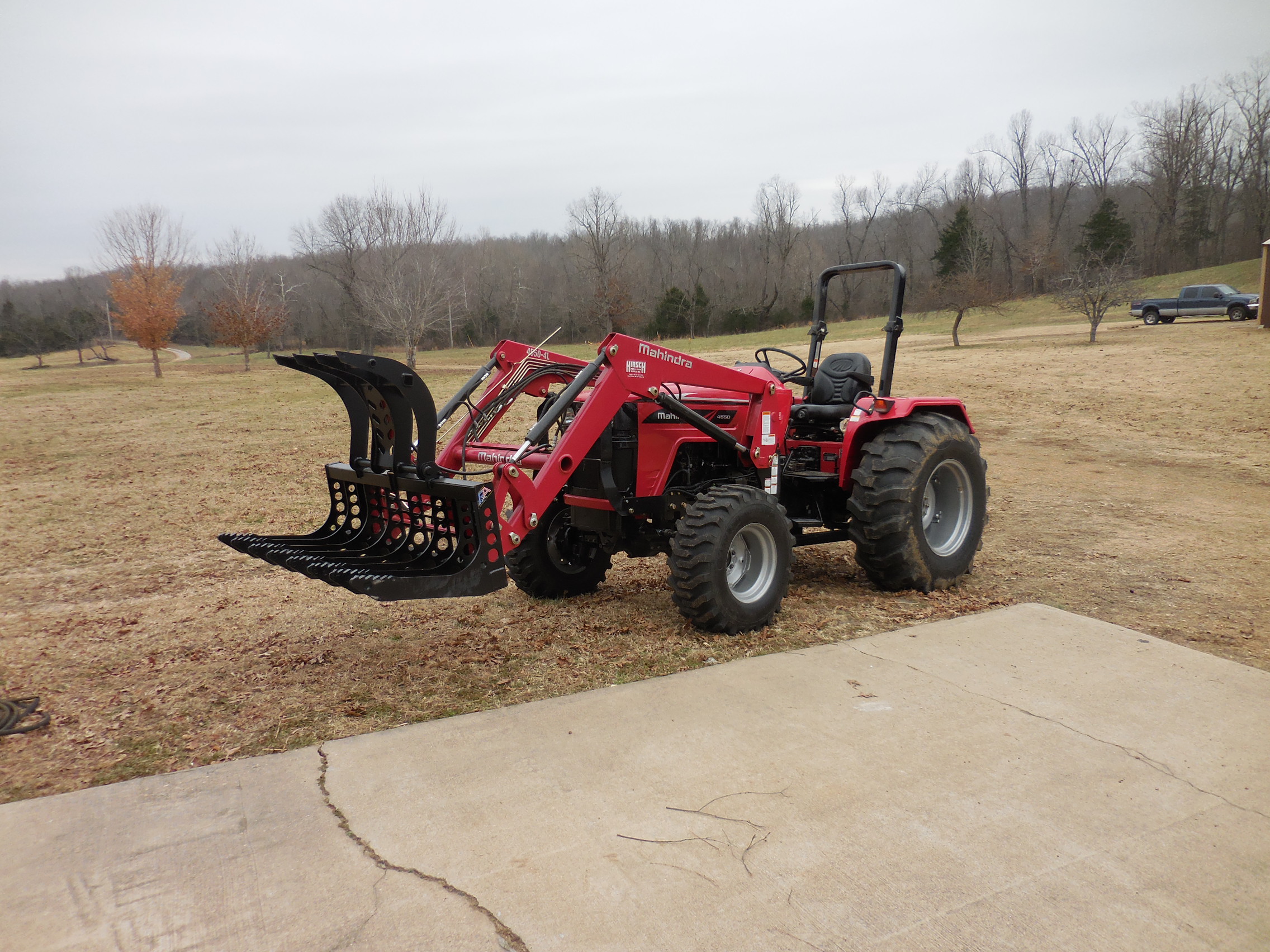

I feel really good about the compact. My favorite is the 60" Single Lid
Travis
On a comparable sized tractor. Kubota L6060
72" Single Lid Wicked Grapple on a fellow TBNer's Mahindra 5555
Surely you've seen the 72" on Eric's famous Kioti NX6010!!
After speaking with Travis, I finally decided on the Wicked 60" single lid Grapple and ordered it on December 9th along with the third function kit.
I got the third function kit within a couple of days and quickly installed it without any issues.
In order to save on having to travel 80 miles to the closest Fed-ex depot., Hirsch Feed and Farm Supply was gracious enough to receive my grapple so I could pick it up at their store.
I picked up the Grapple last night and had a small opportunity to use it today before the rain pushed me inside.
Thanks to Travis at Everything Attachments for working with me and answering my question and concerns.
